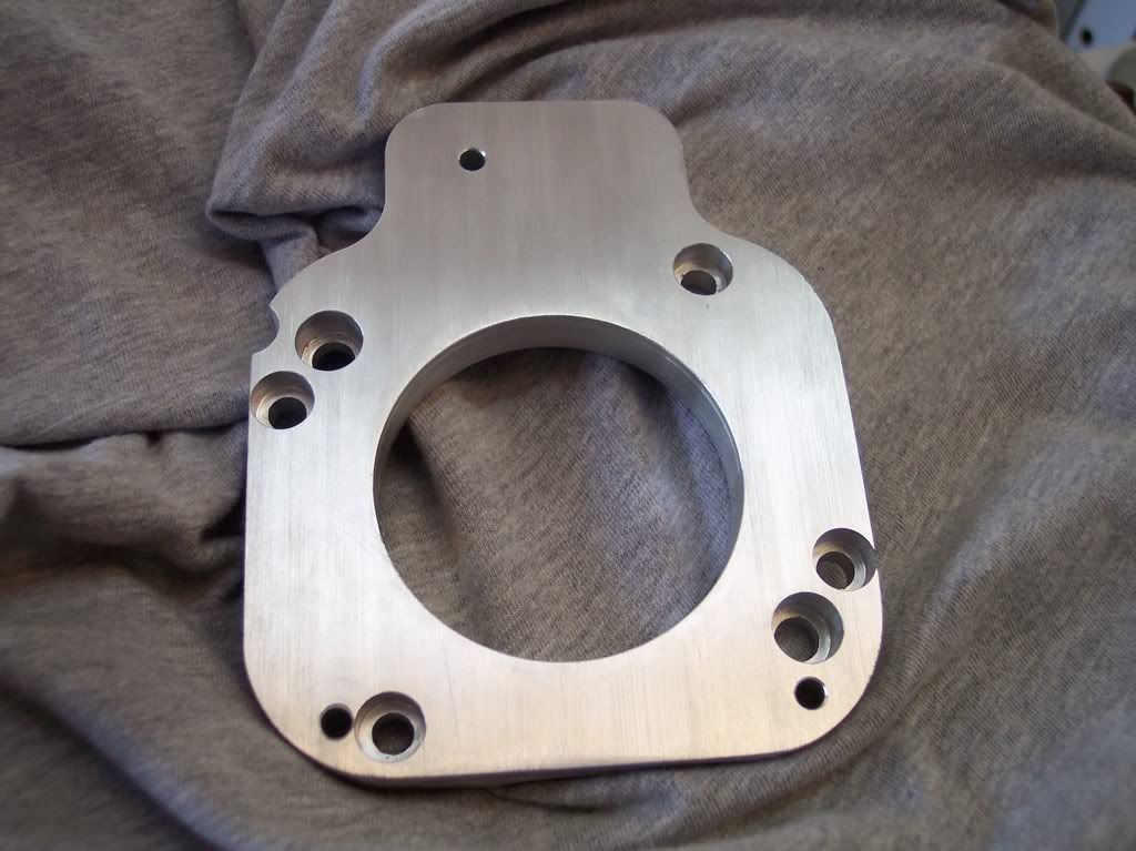

Hey peeps, made some adapters to use a TB from a 3.5 DOHC Aurora/Intrigue on the 3400 and 3500 plenums. They're CNC'd 6061 billet aluminum.
I have a few more left if you want an inexpensive way to upgrade your throttle body

The adapter uses a TB from a Oldsmobile Aurora/Intrigue 3.5 DOHC. The sensors are a direct plug-in. i fyou have a 3400 plenum, you might want to port it to 65mm to take full effect, though
$45 shipped to the 48 states. Includes mounting bolts.
TB's can be had from your local wrecker or Ebay - and the gaskets are available at your local auto parts stores.
