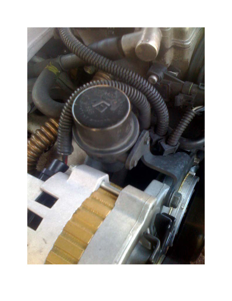

ok its small round thing between alternator and TB has three tubes coming from iac, rocker vent and fuel pressure regulator ??????????? i cant see the point in it ?

yeah it has all these intact but then theres t pieces down all three and they all go to this thing??? manual says nout.
so fpr to tb, iac to LIM and breather to just before TB. thats why i cant see he point in it ? lol

A picture would help.

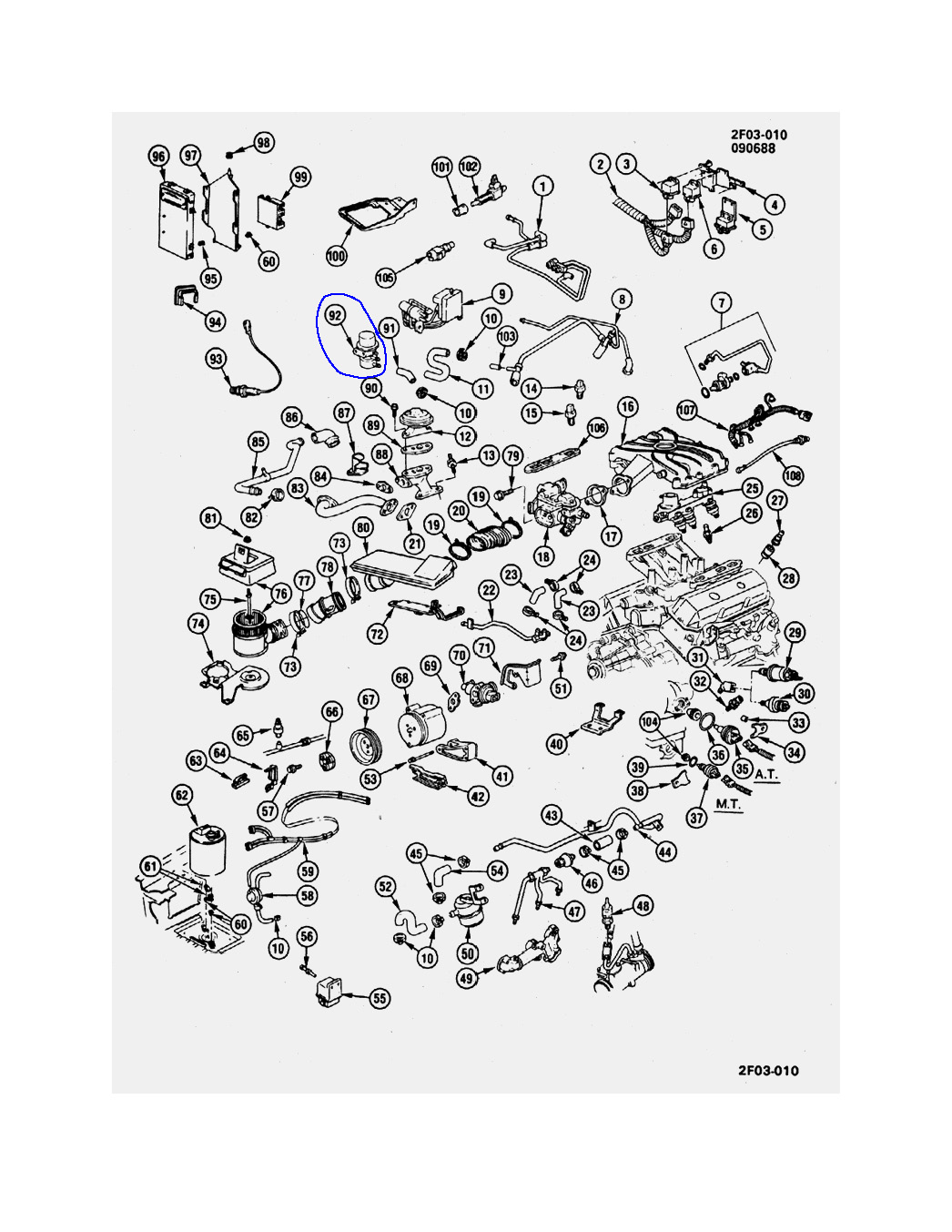

Perhaps you're talking about the deceleration valve?
GM P/N: 14089246
AC Delco P/N: 214-453
Attached Thumbnails what does this do?-deceleration-valve_page_1.jpg   what does this do?-deceleration-valve_page_2.jpg   what does this do?-deceleration-valve_page_3.jpg

THATS THE BEASTY!!!!! couldnt get pic up its raining in uk lol !!!!
so what does it do exactly ?

this link might help:
https://www.thirdgen.org/forums/v6/1...eferrerid=8568
