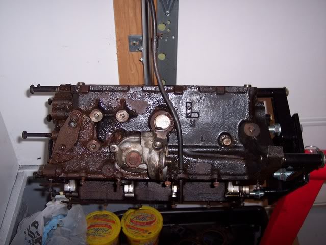

Check the side of the engine. If it has an L on the side its a 3.1. If there is an F it is a 3.4 out of a 93-95 F-body.
Here is a pic of my 3.1...to give you an idea of where to look.

It has an L on it. I guess it's a 3.1. I appreciate the info grimmcs
