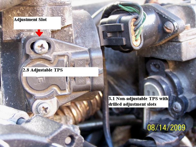

well i JUST replaced my T.P.S today... the car ran better and accelerated better... however it did NOTHING uphill. I swear im going to start beating my girlfriend over it. hahahah KIDDING. but seriousley. I sometimes wonder what ppl behind me think as i crawl up a hill at 20. hahah

Ok for all the ppl having problems on hills its your cat!....buy a high flow magnaflow cat and call it a day(or gut it...but that will make the car VERY LOUD AND ANNOYING during highway use!)...i have the mangaflow and dynomax turbo cat back and it sounds amazing...no anoying resonance at highway...it sounds amazing at idle and also sounds pretty darn decent at WOT...I stand behind the product I use if its good and I deffinatly stand behind my exhaust set up!
Hey vulcan the 2.8 and 3.1 are actually very strong and reliable motors...the reason you dont like yours(which is completely understandable) is because you are having problems with it. If it was in showroom condition or even modded you would LOVE it. Try and find someone that has a really nice third gen and take a ride in it or even see if you can drive it. YOU WILL LOVE IT trust me! Its common nature to hate your car when it breaks....reality is these cars are 19 yrs old or so and need a lil TLC. Keep the car and do all the repairs and a few yrs down the road you will have an amazing car that not only is very fun, attracts the women, friends will envy you, but will also be worth some good money in the future!

I've been looking at the Magnaflow cats and you can get a direct fit for around 112 bucks on Summit, or a Magnaflow cat that you cut out the cat and weld the new one in. That one is around 70 bucks at JC Whitney.
I've kinda figured alot of my problems are to do with the cat and TPS so I'm gonna get it replaced soon. And micktroup I knew what you meant by the soud, and thats pretty funny. The only thing I've ever done like that is setting off the alarm on my moms minivan and setting of like 3 other cars alrms. Mtwlkn, I completely understand what you mean buy loving your car even more after fixing it. So by that measure I'm really gonna love my thirdgen!

its not bad if its a non-adjustable tps. it is bad if you over tightened the screws, i spun the head off one of mine with very little force because it was bottomed out in the hole.

Since I have 2 days off coming, I'll get cracking and get some info for you guys on how to make your non-adjustable TPS into an adjustable one with a Dremel (or similar). I've been busy lately and haven't had a chance to dig out my dig cam until yesterday.
IDK when the TB switched over from the one that was on my 87 2.8 to the one mostly seen on the 3.1 and the like, so I can't exactly help as to which TPS is and isn't adjustable, but I can provide pics of the difference. All I can say ATM is that the adjustable one has a flat connector with 3 round peg terminals and the other has a round connector with 3 tiny terminals arranged in a sort of T shape. Confused?

Here's those TPS pics for those who were asking. It's not hard to work with the newer TPS as all you need is either a rotary tool with a carbide bit or a drill, like I used (since I seem to have lost the carbide bit for my rotary tool).
