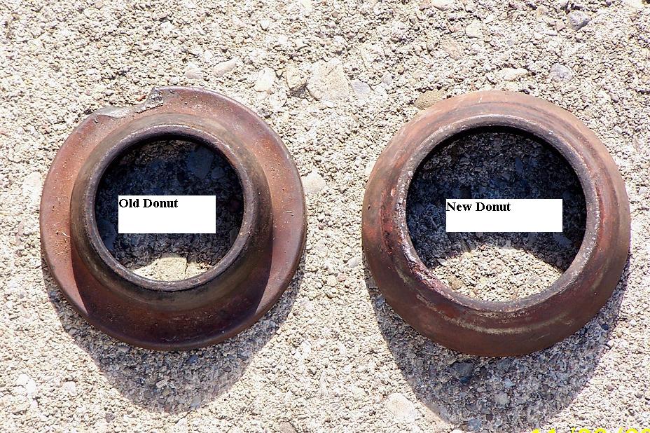

1 do the still sell this orb of power ball or can i block it off i still have mine on the car but the mounting point are broken on it!
2 now that i think about it i do have a small exaust leak around the passanger side mainfold!
3 was gonna grab some doughnut gaskets but i dont know if i need one or two ?
what size would they be ?
4 would that cause code or ruff running in cold weather?
5 doesthe part store still sell the lil number strip you use to number off spark plug wire bc i waz gonnna number off the vac lines to the fiting so i know where the go when i get the new ones to put on! i dont have a vac sticker on my car at all thanks a million fellas !

1. Block the orb off at the T for the cruise control. It may be difficult to remove, however.
3. There are only 2 style donut gaskets on the 3rd gen V6... One has a shorter curve on it with a thick flat plate (early style), and the other is a full curve that is larger in the middle, used post-carb. I have used both, and have mixed feelings about both. Some have better luck with the early ones and a gasket (an actual gasket cut from high-temp gasket paper), and some like the newer ones. I personally think the newer ones are a bigger PITA, but that's because I have other problems with my manifolds.
4. The leak may potentially throw either a code 44 or 45.
5. Numbered clothes pins are cheaper. So is masking tape. If I didn't know where mine went, I'd go with the tape.

If I can find any of my newer style ones that's still in one piece (one of my exhaust problems is that the flanges keep coming loose and the donuts crack and break when I tighten them up), I'll try to get a pic later.

Go and get a can of starting fluid and spray it on every vacuum line and every fitting you can. If the engine idle changes, you have a leak there and you know where to patch.
It's too bad you're not going to school any more... You could possibly have been able to use a smoke machine (that is used to test the EVAP system on OBDII cars) to find all of your vacuum leaks.
:edit: A little later in the day, but here are the pics of the donuts. BTW, the old donut, even though it has the notch out of it (which is what happens when the guy at the junk yard cuts the crossover pipe out with an acetylene torch), it still has enough surface area on the front to seal.
