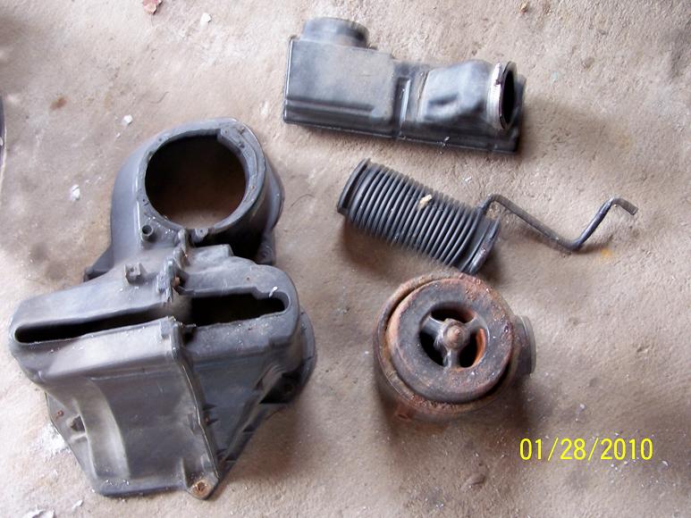

thanks that actually clears up quite a bit for me, looking at the the two pictures has helped me allot, amazingly the car runs pretty well, it does throw a check engine from time to time (need to look into getting rid of the idiot lights) but given how hacked up everything the owner before my dad touched is, i am surprised it runs
heres a picture of where the evap was when i found it:
http://picasaweb.google.com/lh/photo...eat=directlink

The evaporator half of the heater box is in 2 pieces to allow removal of the evaporator core. It looks like the guy took the top half of this evaporator case off, plugged the hole from the body and the blower inlet (scuse me, he left the body hole wide open which does NO good at all as the blower has to push air THROUGH that hole INTO the interior heater case), and stuck the evap can in the lower half of the case.
I don't know WTF he did with the alternator bracket, but I hope he didn't weld that pipe to the alternator case like it appears that he did...
What you should do is go to a yard or have someone take a pic of their factory belt routing sticker so you know how the belt goes. Then, take that whatever it is belt off. Do you see the top bolt in the power steering pump bracket? That needs to go in the hole next to it (on the right). Remove the 3 nuts on the back of the pump and the exhaust manifold, and the bolts on the front. Loosen the power steering pipe fitting at the back of the pump (do NOT remove), and possibly the hose clamp on the return hose. Pull the bracket and pump away from the engine and remove the rear bracket from the studs on the pump and exhaust. Realign the bolt hole for the bolt that goes through the pump bracket into the water pump housing, and loosely install this bolt. Align the right-hand upper bracket hole with the hole in the cylinder head and reinstall the upper bolt. Tighten the upper bolt, the water pump bolt (only 15 ft-lbs here), and the power steering lines. Install a Drive-Rite 815K6 or equivalent belt, with the part for the water pump running on the back (flat side) of the belt, with the loop on the alternator side of the water pump, around the crank pulley, and back to the alternator.

Most factory 87's with the 700R4 did not have the AIR system. There was an add-on kit issued with a replacement PROM that was the result of a TSB for cold start problems (hesitation, sag, stumble, stalling when put in gear). The AIR was added because the replacement PROM that was issued was recalibrated for more fuel.
The easiest way to tell if the engine had the AIR system at any point is to look at the pass side exhaust manifold. If it's flat on top next to the EGR tube connection with no giant hole or pipe for the AIR check valve, your engine never had AIR, or someone replaced it with a non-AIR manifold (which I'd love to get my hands on).

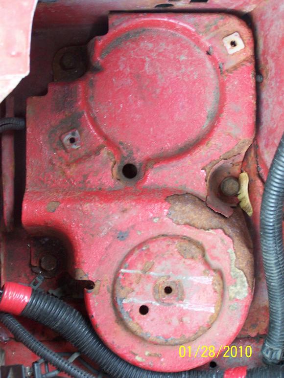

phate... Here's a couple new pics. The first one is a general idea of what yours should look like. Yes, I know it's dirty. It's winter. I can't help it, and I have to drive it. Also, I can't reinstall my stock air box at this time as there is a piece that goes between the black sensor you see in the pic and the stock air cleaner that I no longer have. The second is of the connection for the negative battery cable. Yes, that is the damper on the left and the lower radiator hose on the right. And, I doubt you can tell, but the engine was running in that pic.
Attached Thumbnails 87 firebird 2.8-enginebay4.jpg   87 firebird 2.8-negbatcable.jpg

There's also a small hole next to the battery that accepts a screw similar to the ones holding the dash and interior together. There will be a small wire running off of the negative battery post that needs to be connected here.
guessing that is to ground the body to the battery?

Just don't try to crank the engine over without having a proper connection for the negative cable with this guy attached. Unless you want to start a fire, of course .

Does the passenger's side battery tray have a raised platform still bolted to it? If it does, it goes there, in the hole that has 2 screw holes, one on either side. There will also be a mount for a long bolt that holds the air cleaner can together.

Here's some pics... First is the bracket I mentioned before, second are the trans cooler lines, the longer one being the stretched out pressure line, and the last is parts... For the bracket, the canister goes into the pocket at the top of my pic, and the air cleaner can at the bottom, with the notch lining up with a locator at the bottom of the can. The air temp sensor faces the headlight.

lines do run to a small aux cooler the metal lines stop at the front bulkhead and are continued on by rubber lines, neither battery tray has that bracket in it, but at least now i can see where it goes, mine appears to have some hoses on it that are too short to reach luckely i have some of that type of line in the garage, in the morning i am putting the car up in the air a little so i can crawl under and look around it seems to me those tranny lines should be routed differently the way they set right now if i i were to pull to far into a parking spot i think they would get mashed.
