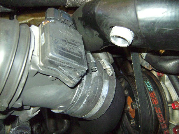

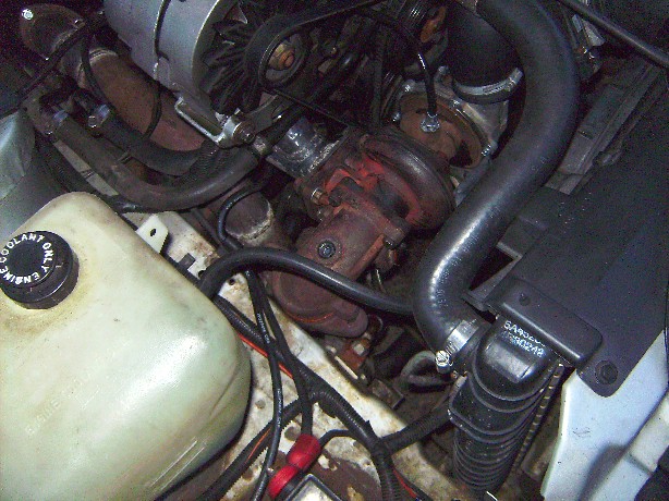

Well I am going to release the power adder version of 6E I've been working on for this project after it's nuked and I'm certain there's no glitches. It will be set up to allow someone to take a basically stock 2.8 to 15psi, with or without intercooler, nitrous, ect... I'm trying to put as much foolproofing into it as I can before release- especially around IAT based spark retard. And whoever's interested can have my setup (or what's left of it LOL) after I'm done- turbo included.
On another note here's what I'm trying out now. It's an IHI off a thunderbird. Supposedly good for 15+ psi, but so far I'm not impressed. The t3 felt way better, power came in sooner & continued to climb with speed. This takes too long to come into boost & just isn't thrilling. Still looking for a t4.
DIBS

Good news and bad news. Good news is the motor survived. Bad news is the motor survived. Daylight revealed that the damage wasn't terrible, basically just blew half the throttle plate off, ate some plugs and shot the bov across the engine bay. Sounded like a shotgun. The rest of the throttle plate must have shot out with the bov because they're MIA. I took the manifold off and opened up the turbo to be sure. Compression is fine so no bent valves and I didn't find the plug jackets so they must have shot out the exhaust. No damage to the exhaust side of the turbo but I did find some ceramic dust when I took the downpipe off. After I grab another throttle I'll be able to drive it home tomorrow.
Attached Thumbnails Nitrous Devastation!-sany1038.jpg   Nitrous Devastation!-sany1039.jpg   Nitrous Devastation!-sany1040.jpg

Attached Thumbnails Nitrous Devastation!-sany1041.jpg   Nitrous Devastation!-sany1047.jpg   Nitrous Devastation!-sany1048.jpg

There's the flavor.
...you might be able to just get away with a new tune for your throttle body, haha.

That was one heck of a back fire, guessin the plate was shut when it went off, making it make a hole to escape?
I blew my intake tube apart a good foot behind the MAF and put a quarter size hole in the exhaust pipe by the rear wheel when I had my hickup a few weeks back on the eway.
