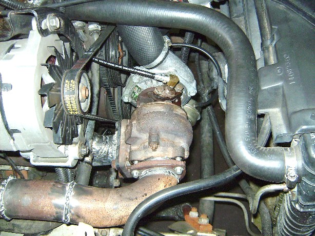

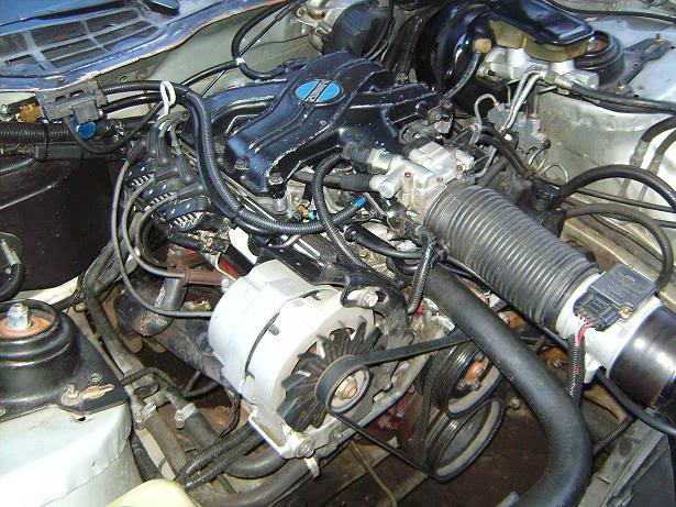

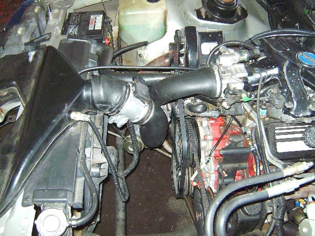

I will be updating this thread periodically though the coming months as I put this motor though as much torture as possible before it pops. The solenoids I'm using limit me to a 175 shot, but if I hit that and it keeps chugging along I may go larger. Ultimately the injectors (from a DOHC 3.4) will be the final say limiting me to about 350hp total (a 200 shot) at 90% DC, not that I think it will see that . I'll be controlling the shot via the egr tables in my ecm so I don't instantly nuke the motor. Might play with methanol injection as well. So here's the setup.

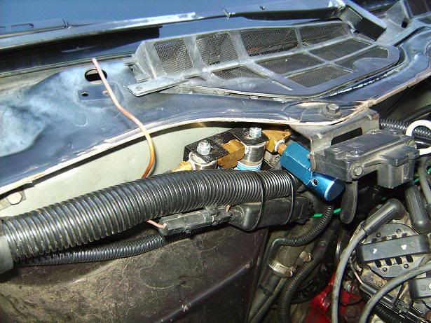

Solenoids & 'hidden' purge aimed at passenger side.

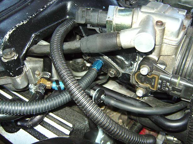

Nozzle & fpr junction.

I like where the nozzle is placed. good idea covering it all up too. nobody will know what they're looking at. why the sudden need for destruction? got a nice 3.4 lined up?

I have a hybrid motor waiting to go in, and I wanted to do something fun with this motor before I got rid of it in addition to getting a final answer to how much these motors will put up with.
1st attempt ended up with a roasted plug as detailed in this thread. Made a few changes since then including cooler backcut plugs, additional nitrous nozzle ahead of maf as pictured above and NO WOT SPARK lol. Only 3 degrees but that was a mistake. I'm not going to make another attempt until I have the nitrous under ecm control.

A little cheap black spray paint from Walmart and most people would never see the install. I don't really like the idea of a dry setup. For the little bit of time it saves during the install, it gives up a lot of flexibility and safety. In this case (where the goal is to kill the motor) it doesn't really matter. You've already had more issues then I had with my 3.1 on a wet kit.
All that said, Nitrous was by far the best thing I ever did to my 3.1. It should be lots of fun on a 125-150hp shot.

Well in retrospect placing the nozzle behind the maf was about the worst thing I could've done so it's really my fault. I should've taken a page from every other maf nitrous kit out there and put it ahead of the maf. The potenital for a nitrous backfire was actually what lead me away from a wet kit. That and the price . The potential's still there somewhat with a dry kit but atleast there's no way for raw fuel to puddle in the manifold.
If you were to run the nozzle in front of the maf, you'd have the cars computer AND the NOS gizmo increasing the fuel pressure. In effect you'd run extra rich.
Dry kits can backfire in the intake too... From my perspective anyway, the big thing is not hitting the nitrous at too low a RPM.

Ya, that's why I added another line from the fuel pressure tee and ran it ahead of the maf. Some is ahead of the maf, some through the fpr vac line and most through the nozzle. So far it it looks a little rich but pretty damn close to where it is without nitrous.
I'm going to need the pump for the new motor anyway so I figure this is a good time to do it.
Does anyone know of a reason I shouldn't just drill out the passages in the solenoid to get more flow out of it? NOS claims the older style I have only flow enough for a 175 shot.

Re: Nitrous Devastation!
6 hacked up volvo downpipes later here it is. It's still not quite done, started it up today and found a couple leaks from the fittings on the -ahem- former grease pump whip that now oils the turbo. Sounds nice though, I may skip fabing up the rest of the exhaust and leave it open. The passenger manifold is from a cavy with the flange flipped upsidedown & rewelded. The driver side exhaust passes under the oil pan following the original exh. route then tucks up under the passenger manifold & merges together just before the turbo. Most of the induction is crap from the victim volvos, but I was actually quite satisfied with how well it tucked into place with only minor interference to the upper radiator hose. Only $130 in it so far not counting expendibles like saw blades & welding wire. Still need to add a BOV, some heat shielding, and rig the nitrous to come on automatically @ 6 psi. And yes, the oil drainback tube is an egr pipe LOL.
Attached Thumbnails Nitrous Devastation!-sany0415.jpg   Nitrous Devastation!-sany0416.jpg   Nitrous Devastation!-sany0417.jpg
Attached Thumbnails Nitrous Devastation!-sany0419.jpg   Nitrous Devastation!-sany0421.jpg   Nitrous Devastation!-sany0422.jpg
I would strongly encourage a hard pipe to your throttle body. Those soft lines flex/vacuum down like crazy under boost.
Not really concerned about it. The objective is to blow it up after all...
Speaking of cracks the hot side housing has a nice large crack ready to split in half. Guess that's what I get using a junkyard turbo. The motor won't die but the turbo will. Guess I'll just have to get a larger turbo.
