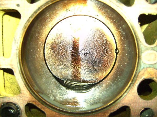

I had my foot down when it happened. You can see the ash on the face of the throttle where it was clean before. Amazing it blew the plate apart like that but it makes sense when you look at the shape of the manifold. I'm going to keep the nitrous tame for awhile so I can finish the programming I'm doing.

I'm certain overspeeding it was the cause of the backfire. It was pretty amusing looking at the datalogs and watching boost instantly peg, the curve was just short of vertical. And I could definately feel it. The lag I felt off the line was knock retard. Once it decayed out it was all over.
I may have gotten ahead of myself though, I took it home yesterday and it just didn't feel right. I took a second look at it and a leakdown test revealed I toasted the #2 & #5 rings (above 35%). I'm debating throwing some rings at it vs dropping the new motor in and turboing that sooner than I planned so I can get the code done. I can get the rings super cheap... but ultimately it's ending up scrap either way. I suppose I've answered the question I set out to answer and had some fun doing it but there's still potential for more. On the other hand I'm itching to put the new motor in!!! What do you guys want to see?

Um no, you can't stop till you toss parts out the bottom, bust a crank, crack the block, blow the heads off.
a couple of flaky rings in 2 cylinders isn't enough.
little borax in those two plug holes to reseat them.

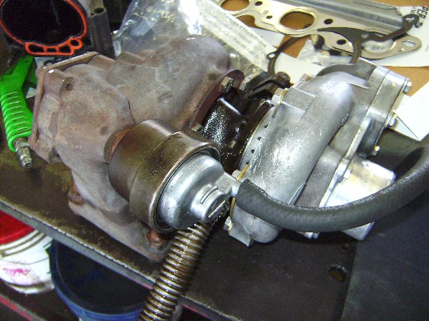

I extracted about as much fun out of this motor as I could. Manager wasn't keen on nuking it out in the parking lot either and I tend to agree. Would've made a hell of a mess & potentially injured someone. Old motor's out and I'm wrapping up rewiring the new one. Once that's done dissection of the old will begin.
The setup is up for grabs now. $200 + shipping for the whole thing. Rebuilt TA0310 with a flange welded on the compressor output side, manifolds & plumbing, induction stuff sans bov and I'll even throw in the pan if you want it so you don't have to weld a drainback tube on your pan. More pics on request. If you need an ecm to run it I can provide that as well.

Here's a look at what had to be done to the mercedes turbo to make it work. The blockoff plate is for a bov that would've been in the way so I had to remove it. They also don't have a flange on the output side so I had to weld one on. I like the wastegate on these, solid and out of the way. Makes clocking the turbo easy.
Attached Thumbnails Nitrous Devastation!-sany1059.jpg   Nitrous Devastation!-sany1061.jpg   Nitrous Devastation!-sany1063.jpg

Nice HF engine stand, lol. I have 5 of them
Naw, 4th gens are still more of a pain if you ask me, and I DO have a lift.
EDIT: What was the output before the welds, then?

Just a tube where the intake manifold slides into. Really odd design.

And for my next trick I'll make a portion of this piston dissapear! I can't believe this cyl had any compression at all. N2o does neat stuff. Well, depending on wether or not that was your intent...

This is win

having all the forensic evidence available... can you write us a quick narrative summarizing everything that went wrong during that last launch? that way there is an account of what all broke.. and maybe some reasons why. (all in one place)

My foot went down and the motor blew up.
Ok, based on the datalog once I hit the nitrous it flashed lean, knock retard kicked in and held the flood back until it decayed out. By that point the air temp was high enough, the induction was flooded with nitrous and cyl temps were right on the verge of meltdown. Cyl 5 looks like the culprit based on the damage. Intake opened up, the remaining exhaust gas reacted with the fresh charge and blew the rest to pieces. Piston and spark plugs melted, throttle blasted, bov became a blow up valve and blew the adapter off with it. Moral is make sure you're on top of your fueling across the table. Even a short leanout on nitrous is enough for temps to jump into the danger zone.
