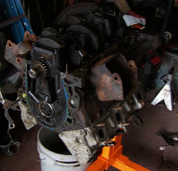

Finished building the MSII and have the harness almost done with the exception of the second O2S wiring and the EST module wiring... Harness has been re-loomed in Red. Have no way to test the MSII at the moment as I need to get another couple of processors for the stimulator, that I have no idea how the original got fried (no RPM signal output at the moment and the other outputs are screwy as well for some reason).
Having trouble finding a metal intake manifold gasket set at a reasonable price ($100+ at most places)... Can I get away with using the other kind temporarily? There is a full 3100 gasket set I'm watching on eBay (includes everything from top to bottom and front to back) for $80, but I'm pretty sure the gaskets aren't the revised metal design, and I'm definitely going to have to swap out the crap graphite head gaskets for the FelPros I've been using.
Cleaned the engine and engine bay last week, no pics, but I do have pics of the invisible engine mod... I can't believe the amount of crap I got off of the outside of the engine. YUCK! Going to go and get a box and Simple Green so I can soak the oily crud off of the upper end parts while I'm working on the lower end. Looking to find a gear puller for cheap to get that factory timing gear off of the crank.
Attached Thumbnails Started Engine work-engineout.jpg   Started Engine work-engine.jpg

More progress... Got the rod bearings and all six pistons are in their holes. Bottom end is torqued down. Oil pump and strainer installed along with filter adaptor. Ordered oil pan gasket (anyone need a 3x00 pan gasket?). Reassembled both cylinder heads, missing exactly ONE valve keeper (dangit ). Pass side cylinder head is bolted on but not torqued yet, driver's side is on but without a gasket or being bolted down (had to find missing alignment pins). Front cover is on with gasket. Going to have to order pushrod length checker, because nobody that builds hybrids wants to share their pushrod info, and then have to order those insanely expensive custom length pushrods. Can't wait to get everything buttoned up for a final cleaning before getting a coat of Rust Bullet (I do NOT want to see any more rust, period!).

Engine is still mostly assembled, no pics yet. Cleaned it yesterday, decided the body of the car needed the Rust Bullet more than the engine (and the hood, and the doors, and the suspension parts and rearend). I bought new stainless bolts for the intake so I don't need to worry about finding some. Somehow ended up with a couple water pump/timing cover bolts missing, but I have a box of bolts I don't know what they go to at the moment, so I'm sure I'll find them. Bought an oil pan gasket (and the 3x00 gasket went into the trash last week, so don't ask now). Still need the valve parts. I haven't gotten the pushrod length checker yet.
