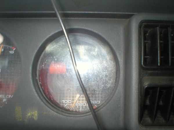

^ this is of no use to you but ya know mine was/is like that stock, once hot where the stock fan came on, it was sluggish and down on power.
solved that by removing AC stuff and a goodair dam, now the temp never gets near 200 and the stock fan never comes on longas your moving. And it runs crisp and responsive all the time.
now stop at a long drive thru and forget to turn on the fan manually [ to keep temps under 200], and let it get over 200, bye bye power.
you can see the needles is just before the big line, runs awesome in that range, let it get past it, into 200s..............
