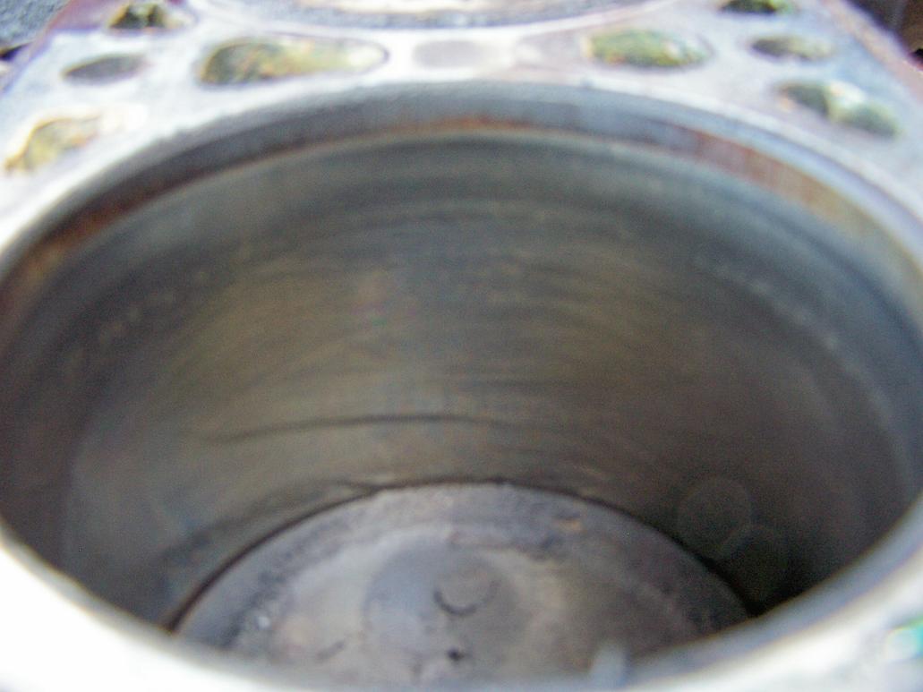

Well, since I have a lot of time on my hands, and most of the parts, I've decided to tear down the engine and inspect it's condition. Yesterday, I pulled the top end off of the engine. I found a couple of loose intake manifold bolts, but not too loose, hardly any built-up crud in the lifter valley, and that the cylinders look pretty nice. Using one of my old head gaskets, I put one of the 3100 heads on the block, so that I could hopefully figure out the pushrod situation. I removed 2 of the rocker studs from one of the old heads, and I have them in the #1 cylinder. I'm going to try to get a set of 93-95 3100 pushrods so I don't have to screw with measuring the length I need. I have a couple pics. Yes, everything is dirty. The heads will probably be cleaned by a machine shop (going to have the 3400 intake valves put in and the whole head checked for problems) before anything comes together. The upper plenum I need will be here in a couple days.
Here's the planned setup. I'm keeping my stock pistons with their 12cc dish. An upper end from a 1998 Malibu 3100 will be put on, giving me roughly 13:1 compression with stock .040" head gaskets (depending on the calculator used). 1.76" intake valves will be installed instead of the current 1.72" valves, driven by 1.6:1 rocker arms powered by a Comp Cams CL-16-233 (.440 and 260* on both valves) camshaft. I'm planning on using the RKSport 3.4 4th gen headers, P/N 01096435 (unless someone can give me a reason why these headers won't fit minus the y-pipe, which I won't be using
) with 1.75" primaries. The rest of the exhaust? We'll see.

Got the pushrods yesterday and put them in, with the old rocker arms and studs on the #1 cylinder. I tested the rods with the 3x00 rocker setup, no dice... One rod is too short and the other is too long. I guess I'll be using adjustable valves and I'll have to get a rocker stud kit or something so I can use 1.6:1 roller rockers.
:edit: And yes, I know everything's still dirty. I have the heads on the block right now merely to protect the cylinders from anything bad that could get in there as I have already tested the valve setup. Once the rear quarter panel has been replaced, maybe I'll be able to afford a large bucket of Purple Power or something to soak the heads and crud in, and I'll have pulled the engine besides (no hoist as of right now and I don't think anyone I know has one).

Will the denatured alky strip off all of the grease, grime, and general crap off of all of the parts?
89, I'm taking the rockers, studs, and nuts off of the heads and leaving the rest (including the valves and springs... I'll even throw in the pushrod guides. There is a broken bolt in the #5 exhaust manifold mount, top hole. And, like I said before, I'm 99% sure these need a valve job (another reason I'm getting rid of the heads) because the engine mysteriously drops a quart of oil at 2000 miles. I do have a good 2.8 TB with working IAC and TPS. I removed it when I junked the 2.8 plenum 3 years ago due to a problem with the plenum (metal fatigue). I don't know if I will be keeping the bellows or not as of yet, as I still need to find the right size reducing coupler for the air intake I'm building to mount it to the TB.

Just get a bucket & soak your heads in it. It'll strip most of the grime away without having to scrub. You'll need to chisel the rest off.
