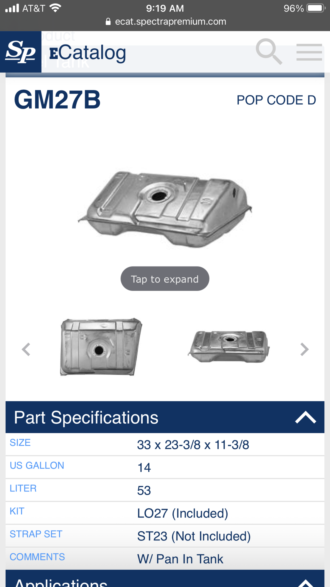

I’m going to bring it back from the dead. I bought a 87 gta trans am. 1/4 tank I start having fuel starvation while braking. Filled up and a little over 13 gal. My Pontiac service manual says should be a 15.9 gal tank. But there’s a twist. My tank was replaced by previous owner with a spectra tank have the receipt. Looked it up on spectra site and it’s a 14 gal tank!!!! I’m thinking there is also an issue with the sending unit working with the aftermarket tank. Something to consider maybe some of the gas tanks were replaced that’s not filling up with as much gas??
