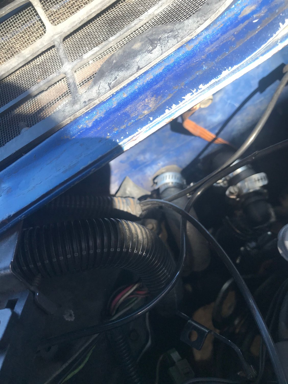

I have a line coming from the intake manifold area and I can’t seem to find where it’s supposed to go into. Any ideas?

It goes to the coolant bypass right below it. The hose on the bypass is not right
The vacuum hose (small one) off the "T" on the back side of the intake is dry rotted. You should replace the section between the T and the vacuum check valve

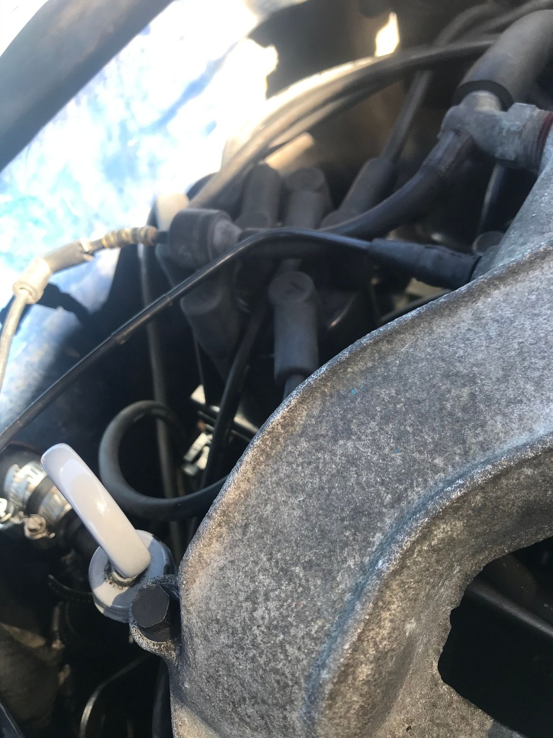

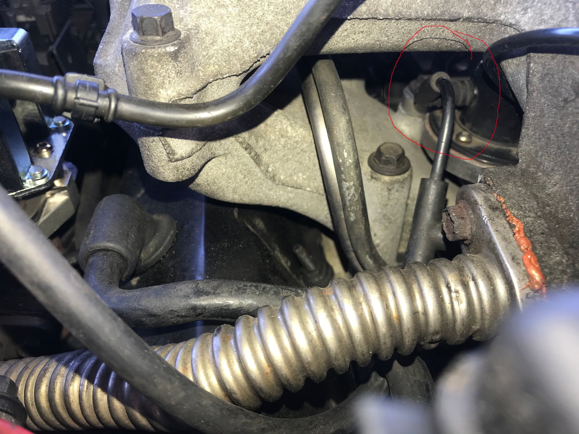

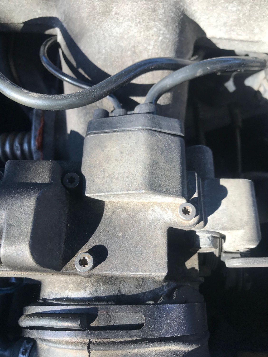

It originates here from the fuel pressure regulator and then it split the line one goes to near where it was wrongly put on and then the other goes into the throttle body shown in the second pic

The fuel pressure regulator should be hooked to manifold vacuum. So if you just unhook the current bypass vacuum hose you'll have a vacuum leak. You need to fix all of this or the car will run really poor

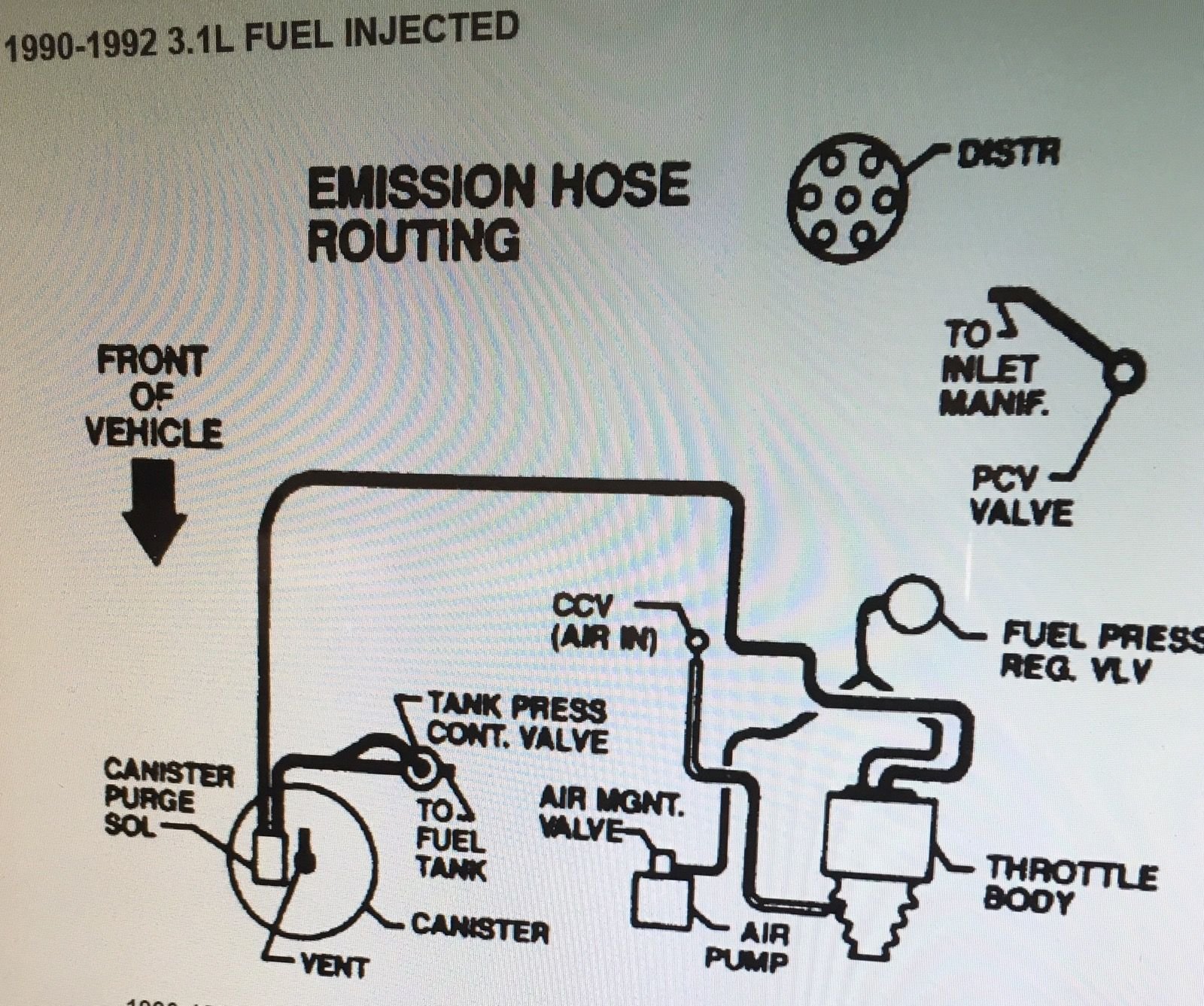

Look at the vacuum diagram on the underside of the hood

Wow, yeah, that's a mess yo. Get ahold of the vacuum diagram and start from scratch, someone has been meddling. The single nipple on the back of the intake goes to the MAP sensor. The other goes to the 3 way check valve, the other two on the 3-way go to the vacuum ball/cruise control, and the HVAC tube through the firewall. The other HVAC line from the firewall goes to the coolant bypass valve. The vacuum line from the back of the throttle body goes to the fuel pressure regulator and oddly enough on the 3.1 it goes to the smog pump.
Get the diagram, and it's all fairly straight forward.

Following this diagram, you need to connect ALL of the vacuum lines the diagram shows before you can begin trying to figure out why it dies when you give it gas
