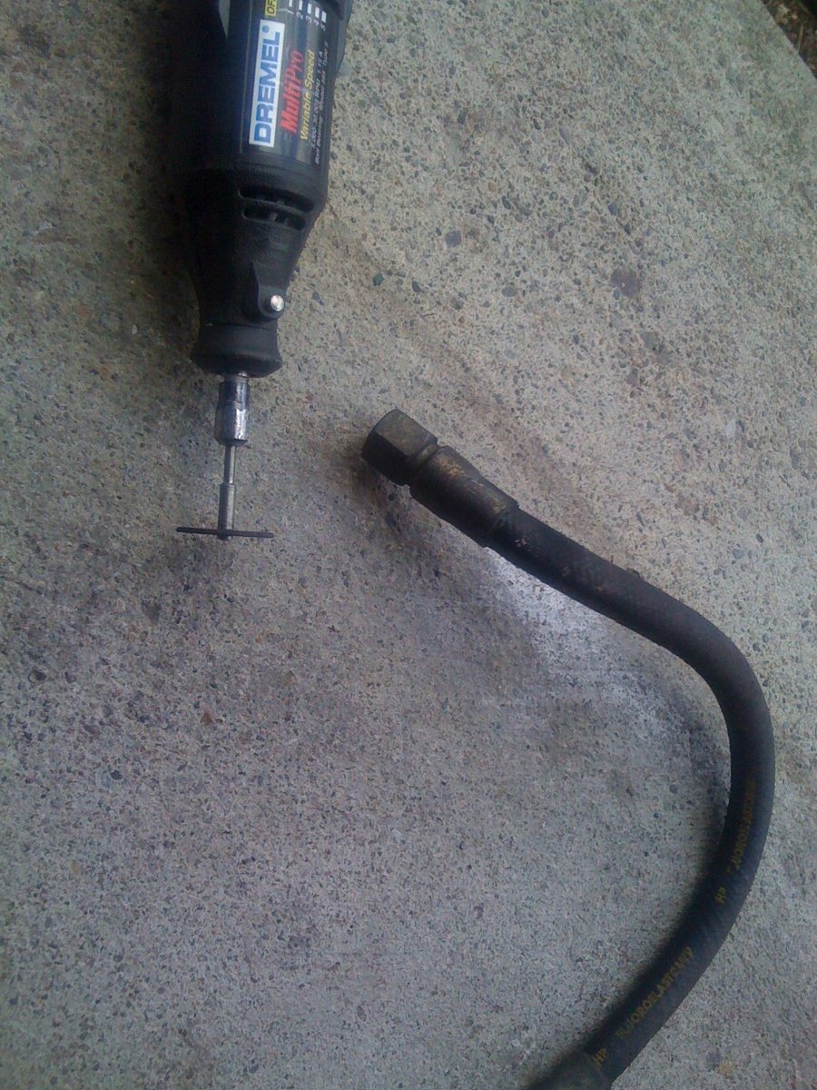

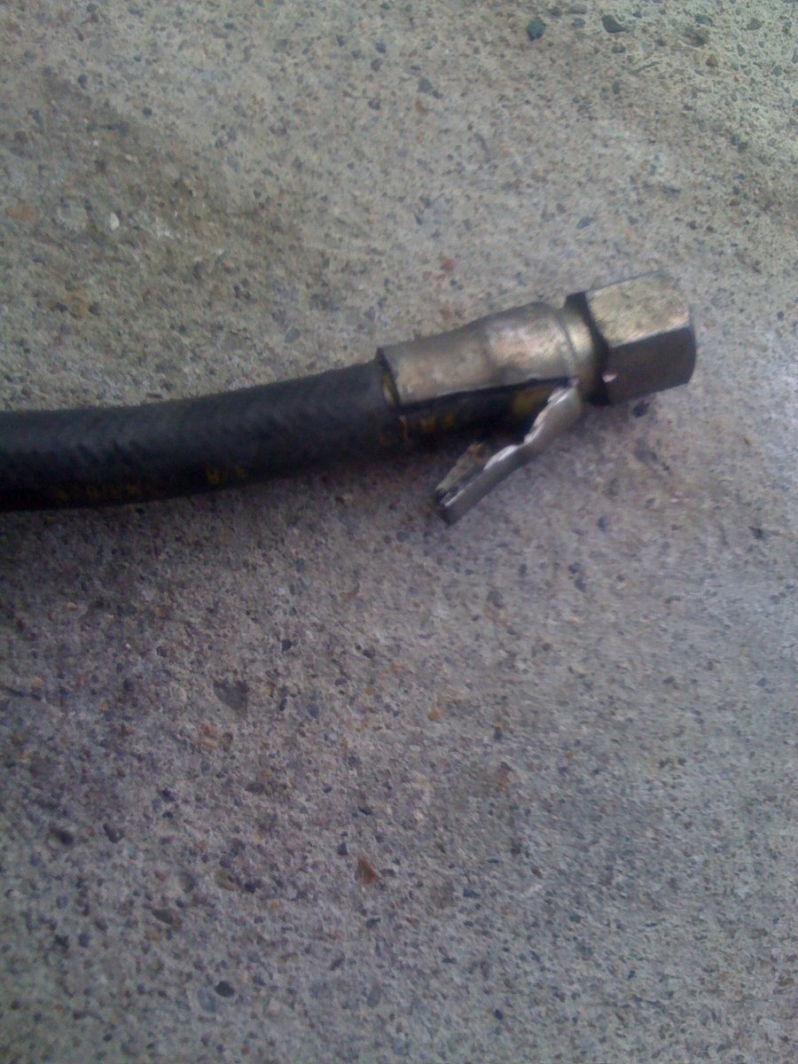

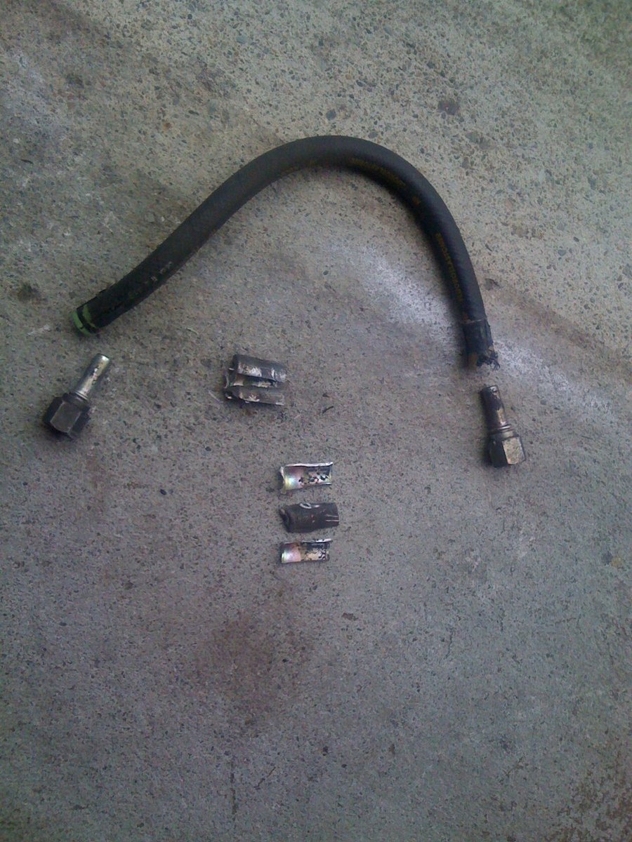

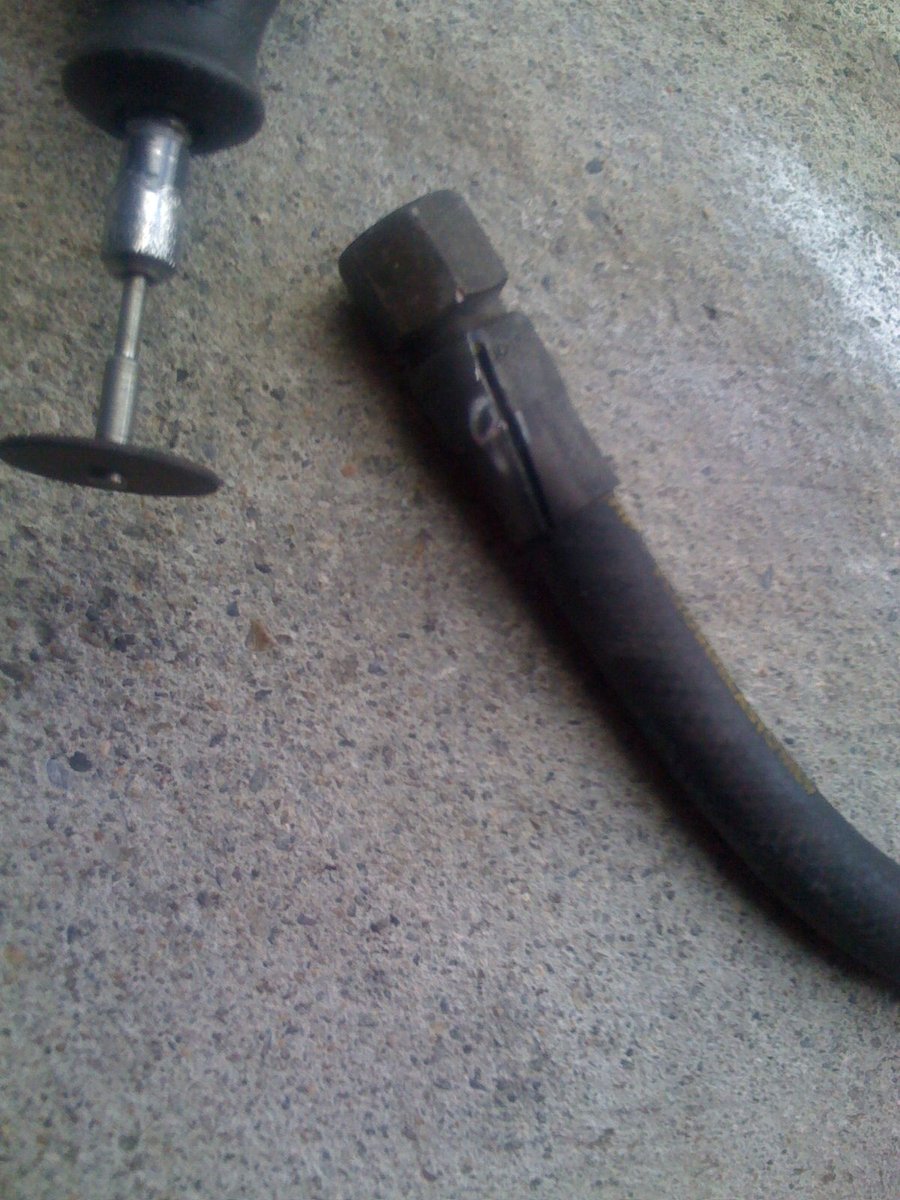

Here's how I solved that problem , notice that both the hose and hose clamps are fuel injection rated , and available at the local autoparts store .

I think I'm gonna probably go with OrangeBirds method if I cant find a Hydraulic shop like you said drew. Thanks for the info.

I like orangebirds fix 👍 I would go to a hydraulic hose place though, they will make everything up from scratch , consider going from there all the way to the fuel rail with braided hoses and tidying it all up while your there .
just another idea 😉
