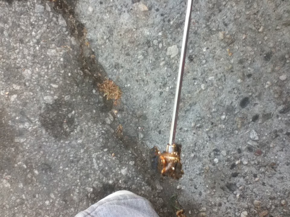

Also, after my socket accidently fell in the engine block, I used a telescoping magnetic retrieving tool to fish it out and a bunch of black metal bits came along with it. I repeated the process until no large metal pieces were coming out. Is it normal for that to happen? here's some pics.
