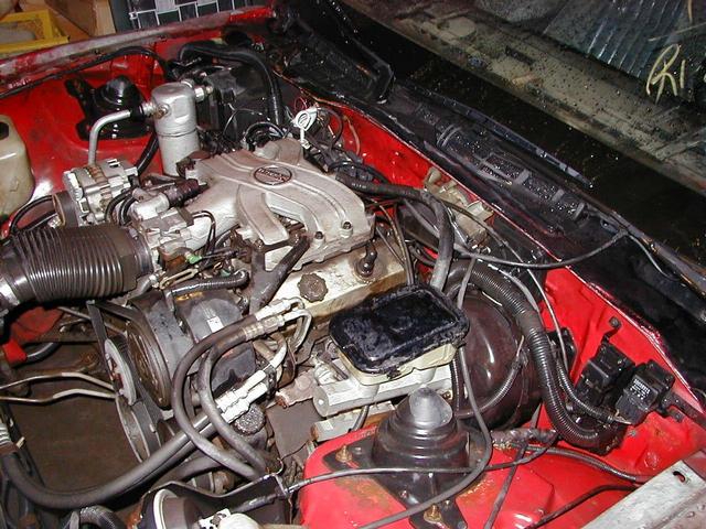

First you want to locate the correct vaccum line. Once you have found go a head and shove anything that will block the vaccum hose off into it. Just make sure you can pull it back out when you need to.
I have attached a pic of the 3.1L engine that shows the digital EGR, but the vaccum EGR is located in the same place. I couldn't find a picture of the 2.8L engine.

and the line that i busted was the one closest to the alternator in that pic....would i plug the line itself or where it went into the EGR?
Old Dec 25, 2001 | 09:00 PM
BitchinRS's Avatar
Posts: 904
From: Modesto, CA USA
You plug the line. This will keep a vaccum leak from occuring. You should be set after doing that. Just don't try to pass emission testing with it like that.
What this will do is keep the EGR from opening and allowing the exhuast back into the intake.
What is most likly happening is the EGR will open when it should but when it is told to close it gets stuck open and when you come to an idle your car will sputter and / or die becuase of to much exhuast in the intake charge.
Sence the line broke so easily you may want to try and replace it. The EGR it's self may be just fine, but the hose may have had enough cracks to cause a poor vaccum. This would cause the same symptoms. Like I said before these plastic hardlines and rubber hoses have pretty much seen thier day and should be replaced.
