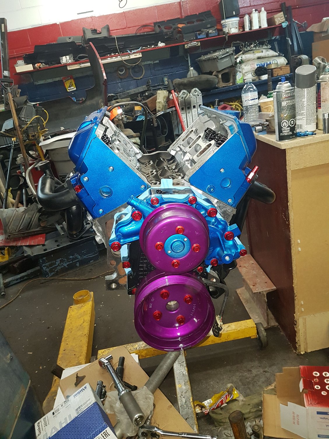

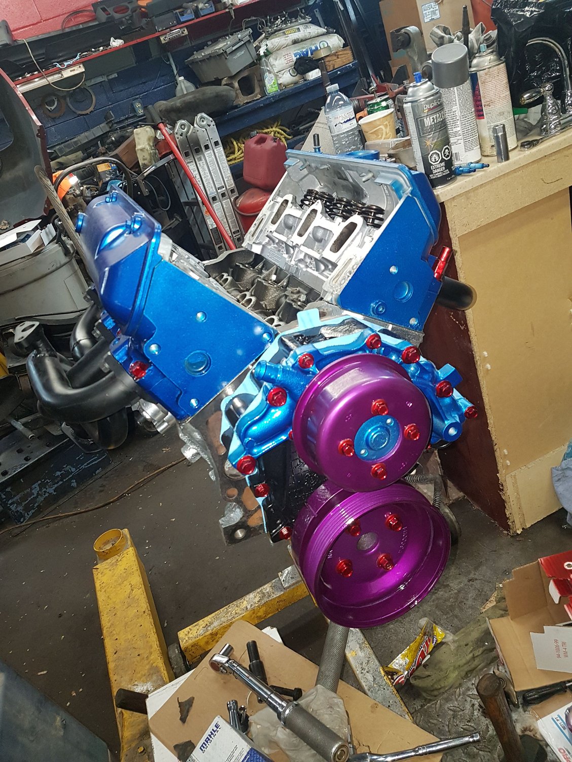

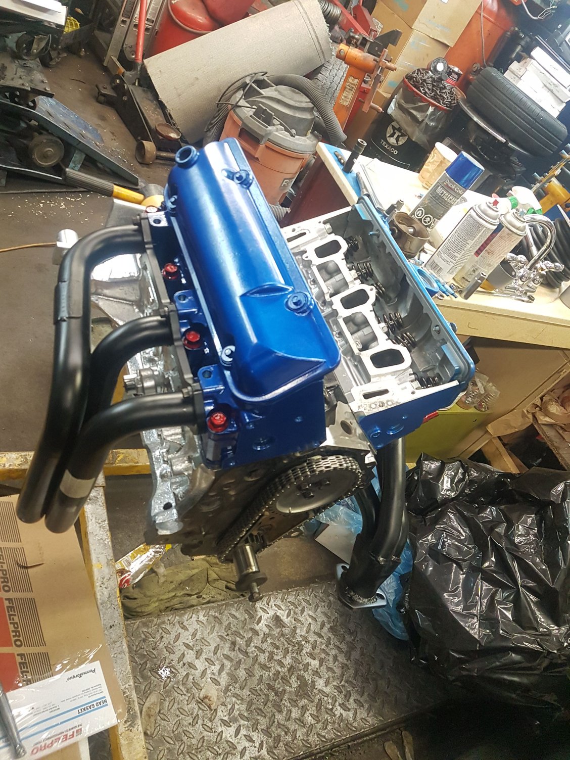

Thanks guys! So just a small update...
Camshaft, pistons, rods and mains are all in
Cylinder heads are completed/painted with new coil springs (mock mounted atm till I get the head gaskets)
Headers are already slotted & ready to go.
Just got to buy a new oil pan and pick up tube tomorrow, so I can install the high volume oil pump.
According to Mitchell were not suppose to re use the old pick up tube? I'm assuming its because of the press fit, might distort when removing..
Then I'll be sand blasting the UIM, LIM, crank pulley and timing cover.
Slowly but surely😫 money is a little tight but I'm making it work lol

So fresh and clean

Red head bolts give it a nice touch 😉
Heads are torqued ✔
Headders slotted and test fitted ✔
Water pump and timing cover painted last night gona put them on today..
Just missing the oil pump pick up tube... nobody can get it locally, looks like i gotta get it from summit.
Also which flywheel should i be using the 3.4 or 2.8? The tranny is a T5 from my 86 2.8 bird.
I remeber reading that they were balanced diffrently.

Use the 3.4 flywheel since it is neutrally balanced.
However, check to make sure they are the same thickness. The 3.4 flywheel is quite thick,which I think is partially due to trying to move the trans back in the car. I vaguely recall there being a thinner flywheel used in older F-bodies. (S10 for sure uses a thinner flywheel).
Also FYI, the 3.4 flywheel seems to be very difficult to source in the aftermarket (even as a stock replacement), since that's the flywheel I use in my conversion, I have a spare and would like one more, so I keep my eyes out for one. 3.1 F-bodies also used the same flywheel as the 3.4.

She's comming along guys! Waiting for my oil pump pick up tube then I'm pretty much set, got everything eles I need.
Also the car is an 89 T/A shell witch had a v8 in it (still has the v8 rubber engine mounts on the subframe). Now would the v6 engine mounts & brackets from the original 95 3.4 block work? Or I have my old 2.8 mounts from my 86 bird... if that would work too

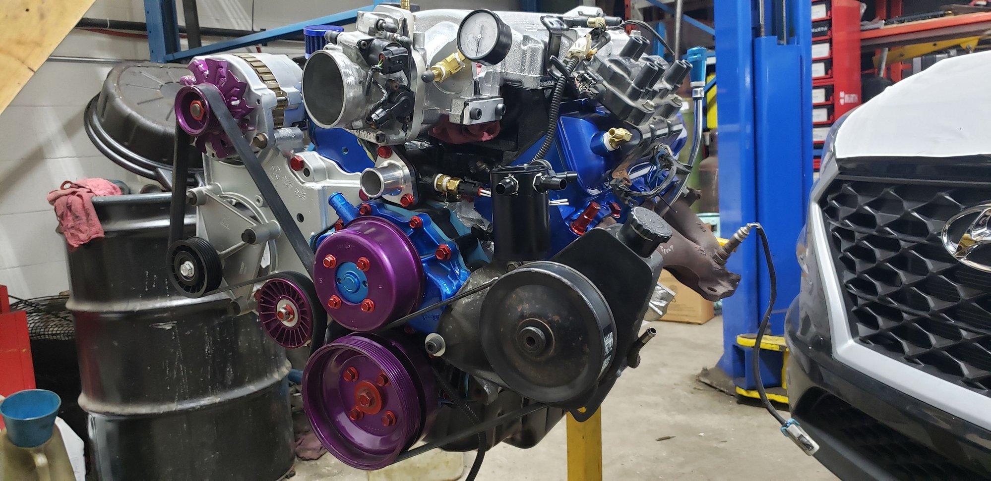

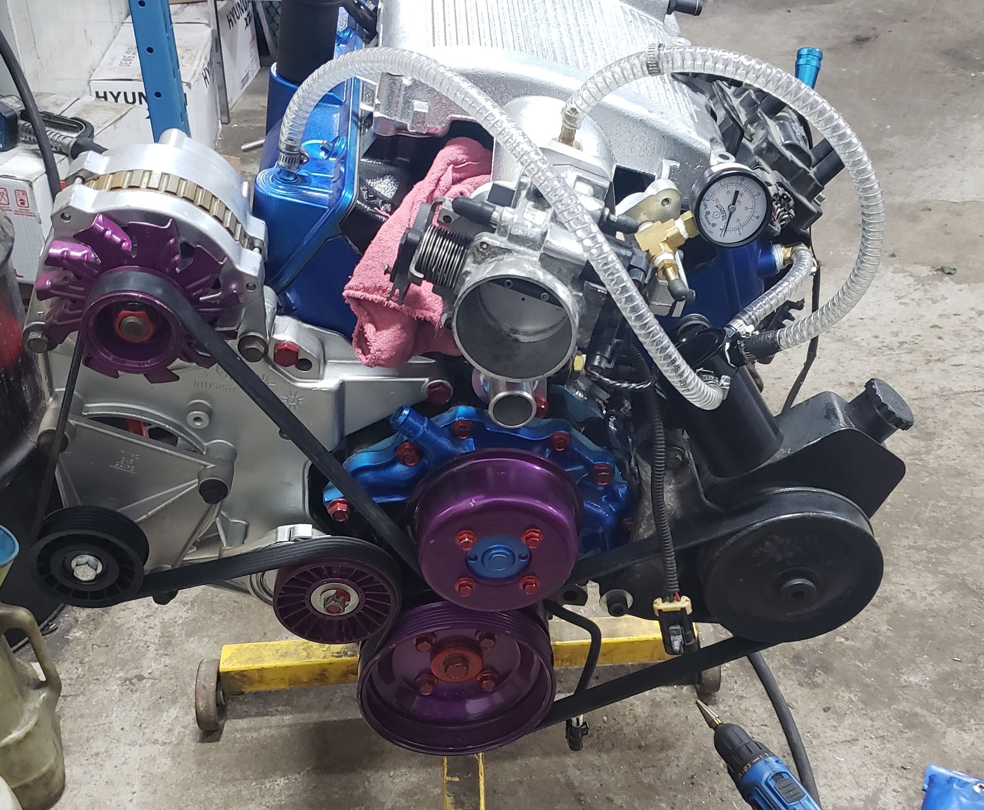

This project has sat for WAYY TOO LONG, finally decided to finish it up. Motor is pretty much completed
Picked up some 24lbs ford injectors, going to install them onto the 3400 fuel rail.

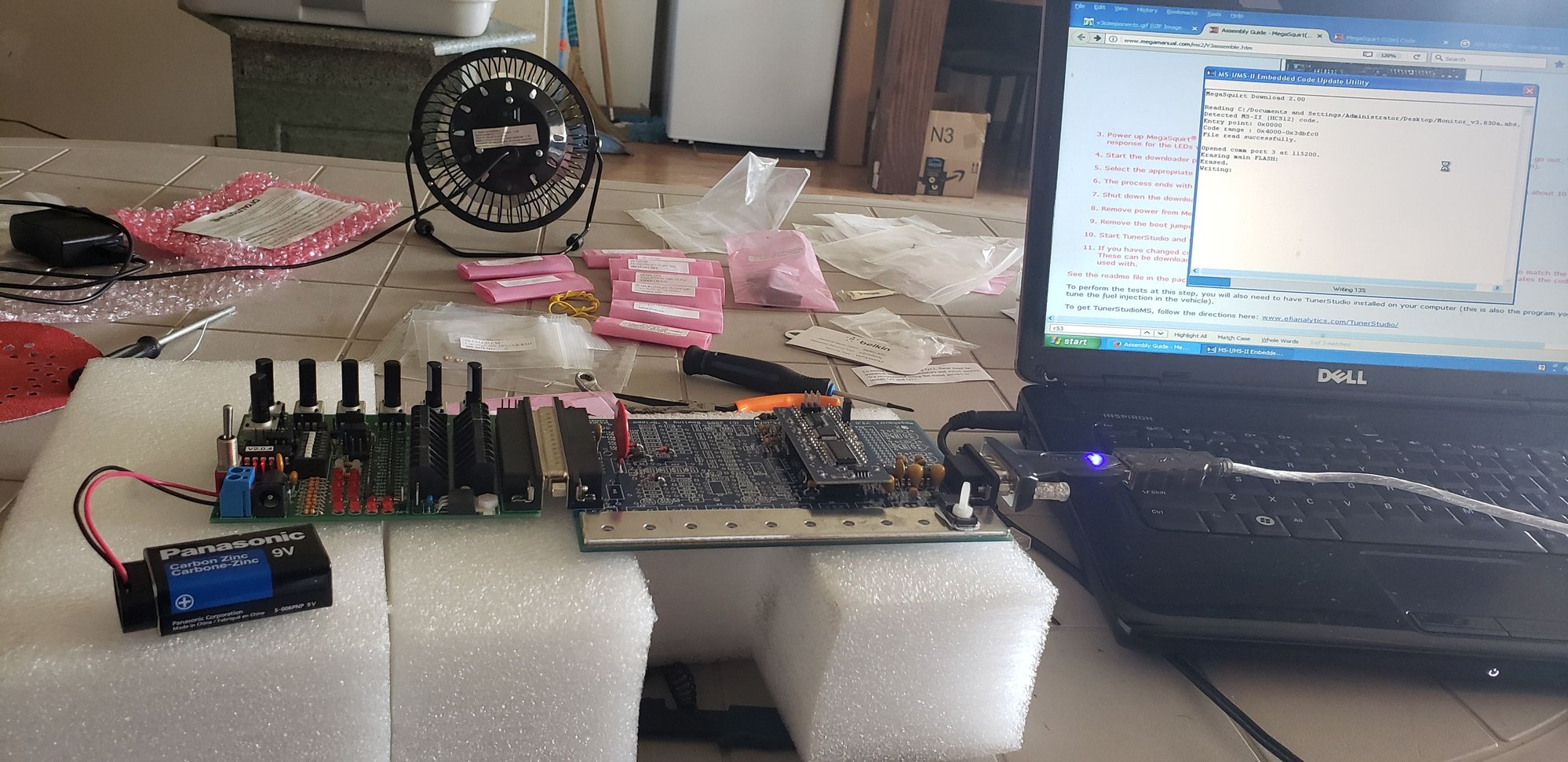

At this moment i am in the middle of building a megasquirt 2 v3 kit.
Got it commnicating with my comptuer, flashed and synced with tuner studio.
The only problem im having is understanding the ignition system part of things. For those runing a hybrid and megasquirt, what coil pack did you use? I.e 3400 or lx9 3500? I figured i would use the 3500 coil pack.
How did u guys wire up your megasquirt to accommodate it?, Gm dis style or direct coil control?
Going batch injection with wasted spark ignition.
Also those that upgraded their camshaft. Looks like alot of the cams on summit dont accommodate for computer controls, just like the cam i used.
Do i need a cam signal in order to run my megasquirt or can i do without it?

Originally Posted by Kishan
Is that a vacuum canister by the power steering pump with the hoses going to it?
Also, is that the alternator bracket off the 3.4l ?
