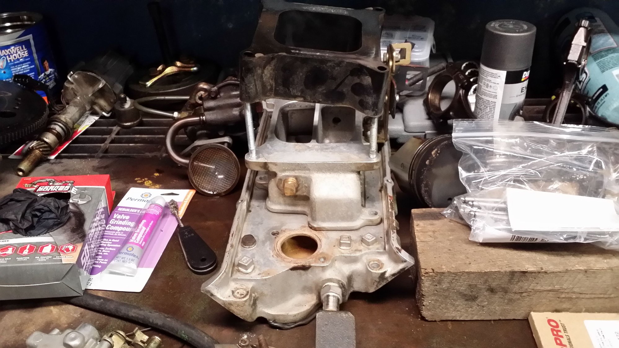

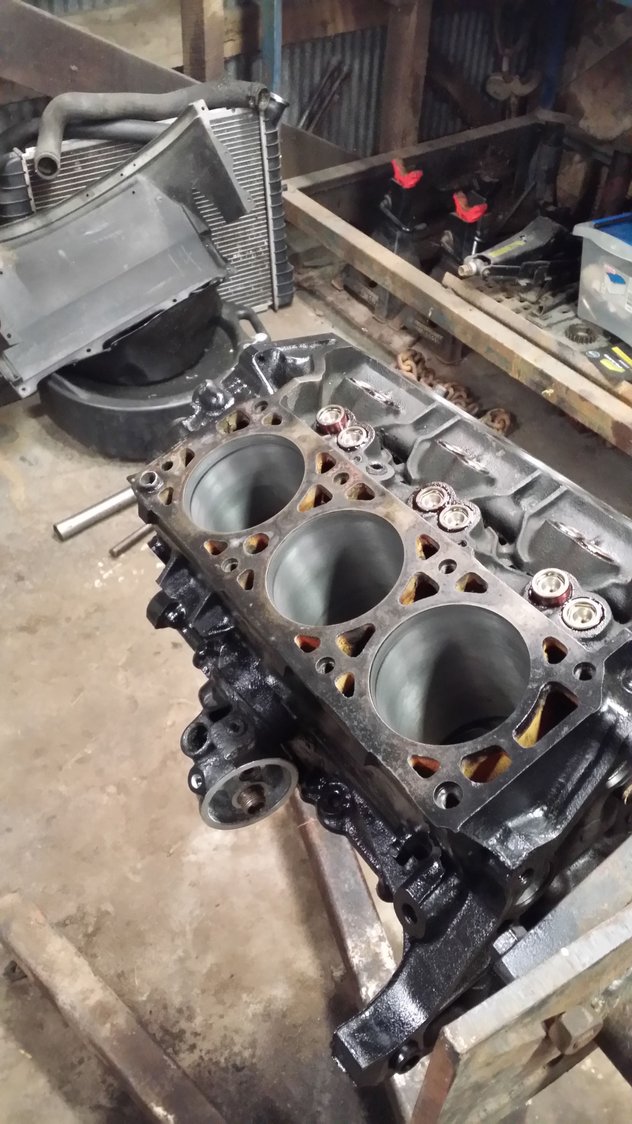

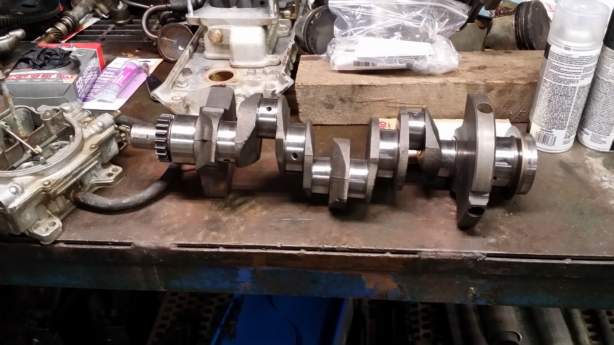

Camshaft is installed with new kiftera and new timing components, back seal is in place, front seal is in place, all trimmings are painted and gasket surfaces cleaned. I am hoping tomorrow will be the delivery day on my mainand connecting rod bearings. I still have to finish scraping off the carbon deposits from the Pistons and clean em up but that takes no time at all. So now, we wait!
Crank polished and ready to go!!
Oil pan is ready to rock!
Block, beginning to come together! Cylinders honed and ready.
Intake is all that remains unclean and unpainted.

Everything that i needed came in today. Naturally as soon as the parts hit the door, i was in the shop. Assembly libe slung, crank installed and put in time with the cam sprocket, bearing caps torqued to specifications and crank rotated each time a bolt was torqued. Still free flowing and ready to rock! Here's a look at the current progress...
Here we see the timing put in place. Crankshaft sprocket facing up at 0 degrees, camshaft sprocket exact opposite at 180 degrees. The chain lines them up perfectly!
Crankshaft surfaces are smothered in assembly lube, caps torqued to specs. Cleaned up the oil pan gasket surface while I was down there.
Used a ridge reamer to pull the top lip off the cylinder walls, then followed up with a brake hone to smooth out the surfaces. Ready for pistons!
Speaking of pistons, all lined up with new rings and bearings waiting on the left, ratchet, more assembly lube, and socket on the right, and torque wrench waiting! The top surfaces still need cleaned of carbon, and the old rings still need removed as well. Busy day tomorrow!

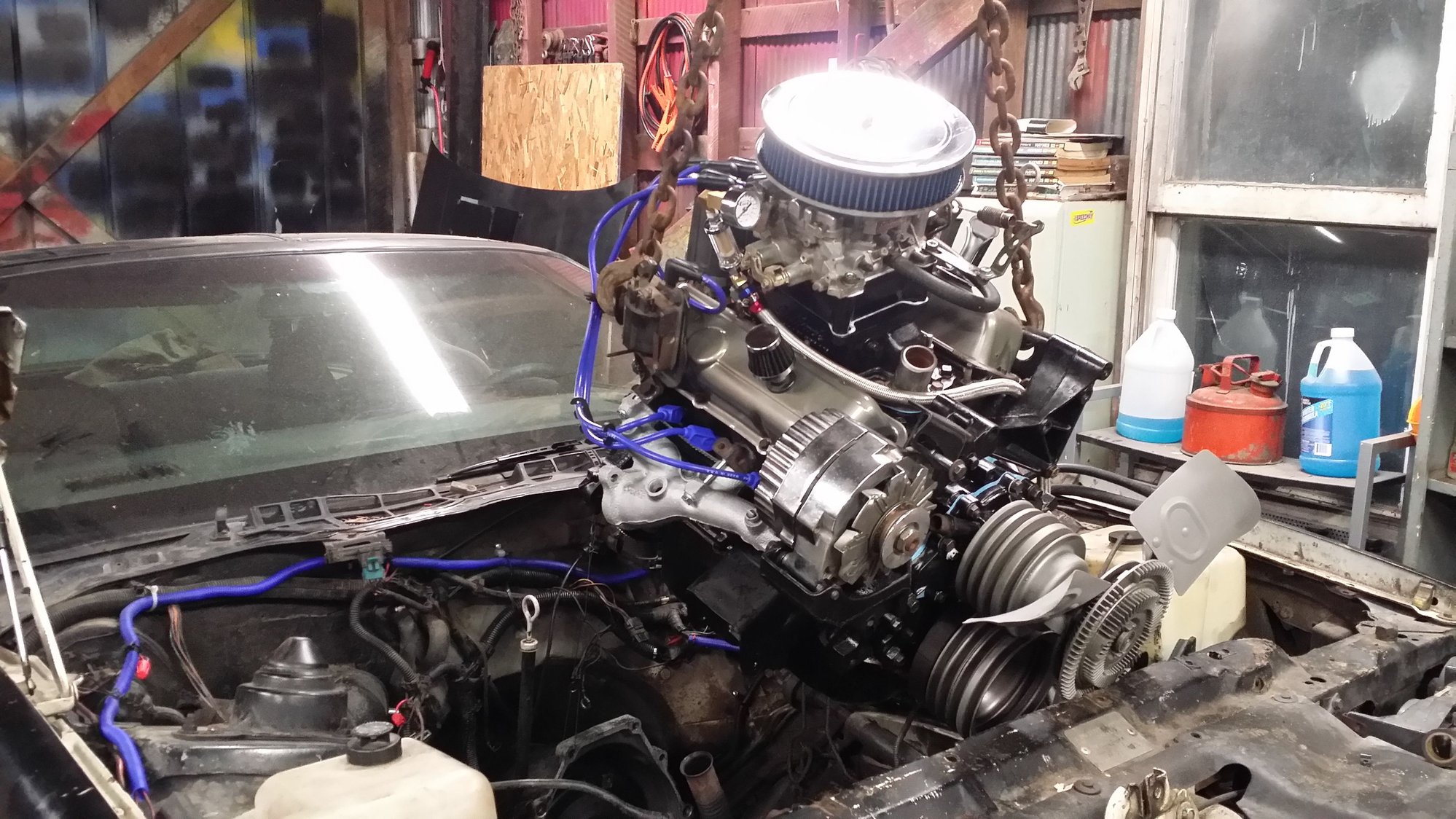

Had to take some time off, damaged something in my shoulder. But tonight, I came back with a massive bang in production! Everything is in place for it to be turned over tomorrow, hopefully with zero issues when I do. Engine mounts are bolted in place. Torque converter lined back up with the old slots and bolted up. Transmission and engine are bolted together. The biggest step was redoing the wiring in the engine compartment.
Due to the fact that I changed her to a fully mechanical carb, took out some of the unnecessary stuff and took the air conditioning out, and had to rig up the blower motor to toggle switch, the wiring needed some renovation. Tore out a good bit of obsoleted connectors and wiring, cleaned everything up and gave everything new wiring looms. Good news on top of all that, my special spark plug wire looms will be here on the 3rd, so I will be able to dress it up a bit further while I am at it.
Gotta figure out what wire goes where for the starter though. And now some images of the progress!
Waiting to be dropped in!
Good view of the fuel line routing. That was a headache to figure out! It is the silver hose on the front, snaked behind the power steering mount.
Another look at the fuel line routing
Here's a look at the brass fitting rig I came up with to simplify things at the carb inlet. Coming from the fuel pump, it goes into a 45 degree brass fitting and into the inline fuel filter, up to a 90 degree elbow and into a brass tee connected to the pressure gauge and a short length of rubber hose to break up rigidness, and into the inlet it goes.
Now that it's mounted in place, i feel this would be a good time for a before and after photo... so here it is!
Before....
After! Minus a shroud and some hoses of course.
Looks like tomorrow will be the day I put all my time to the test. I hope it goes well. If there is snything I should know, double check, etc. Please let me know. You guys have been a great help uo to this point. I want to make sure all this work wasnt for nothing.
