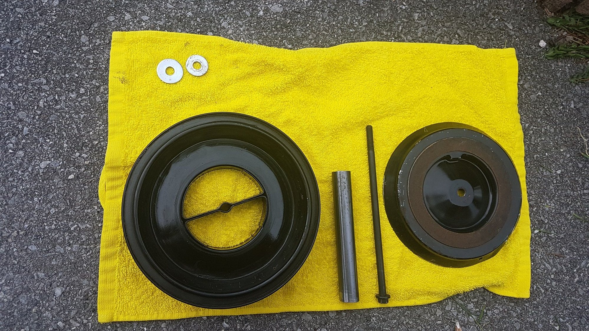

So while i wait for my 2.8 Pacesetter headers to arrive i want to "open up" the other end on my 3.1 v6.
the factory one got a little intake that makes the filter element only dirty at one spot and clog it really quick in my area.
I searched on the internet for custom air intakes but they are expensive in price and i think they are cheap looking ( every honda got one).
So i did mine for cheap only using an angle grinder , abrasive paper, a steel tube and some washers .
you can take all standard paper filters or the k&n with the original factory size
first you cut open the bottom of that "rust bucket" right above the edge.
the tube is that the filter does not collapse , brake away or bent if you tighten the screw that holds the top part of the air box in place.
Put it together to measure out the length of the metal tube, but be sure it is a little bit shorter that the filter element gets pressed in place for a good seal top and bottom . If you cut the tube too short you can shim it with some washers
it is important that you work as clean as possible that means deburring everything , wash all parts and inspect every part for metal shavings.
now you have to find a new place for the intake temperature sensor . i will soon make a heat shield for the filter that it doesn't suck the warm engine heat
with this mod i can feel a little better throttle response and acceleration
when i got the headers and high flow exhaust i think it makes a bigger difference
i hope this is useful for some of you
