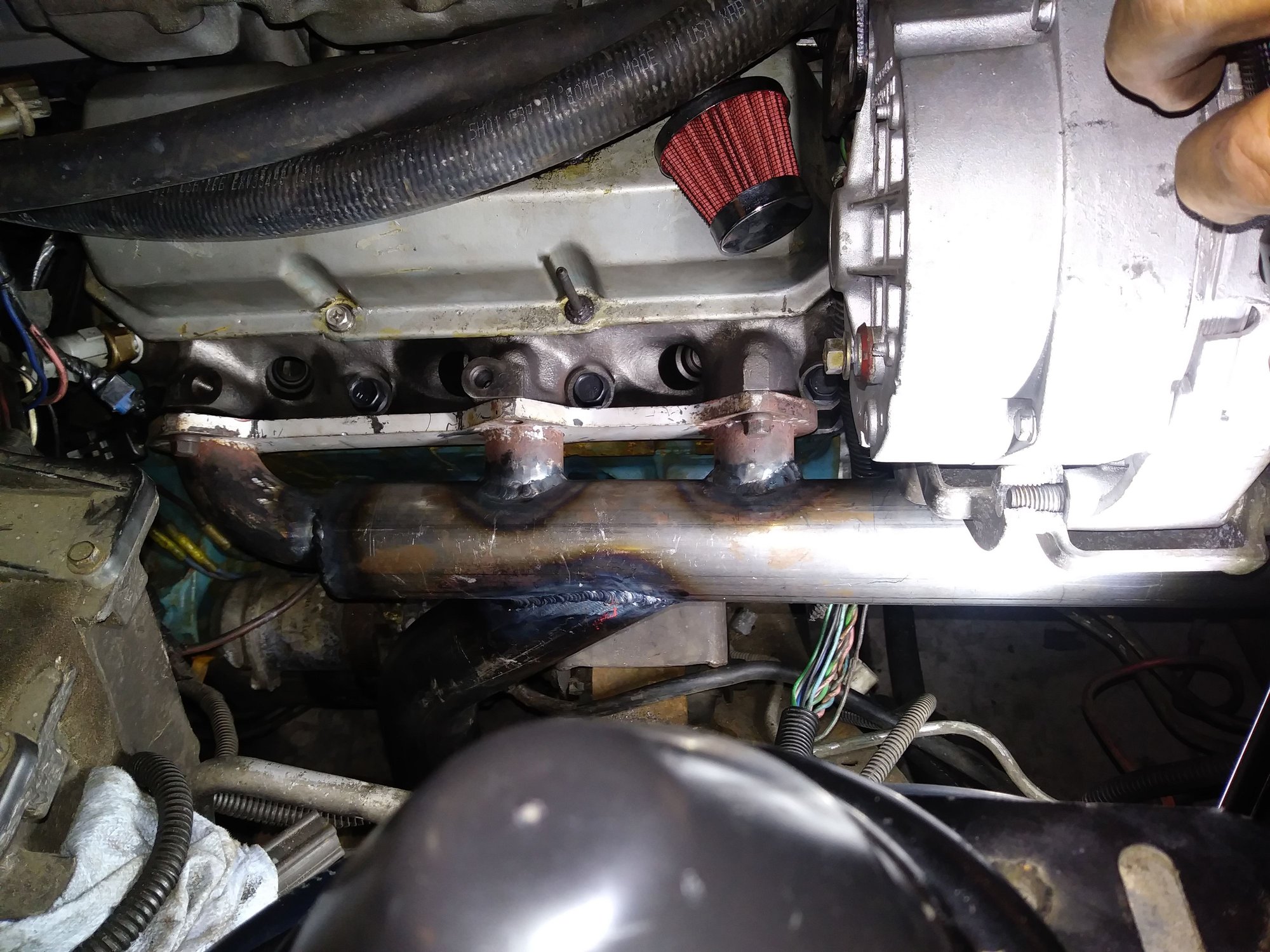

Cut up the pacesetter header & started mocking up the passenger's side turbo header log.

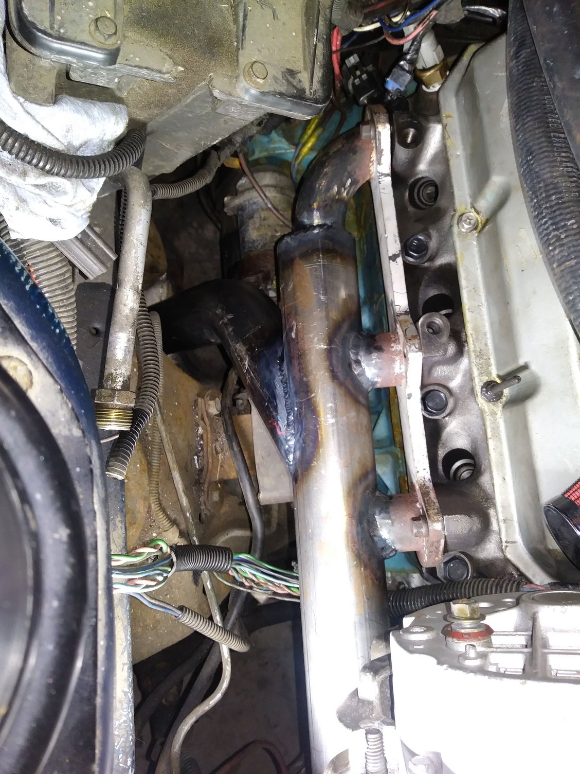

More progress yesterday. Got the log tacked up . We've decided to mount the turbo in front of the engine instead of where the airbox was. Also did a coolant throttle body delete.

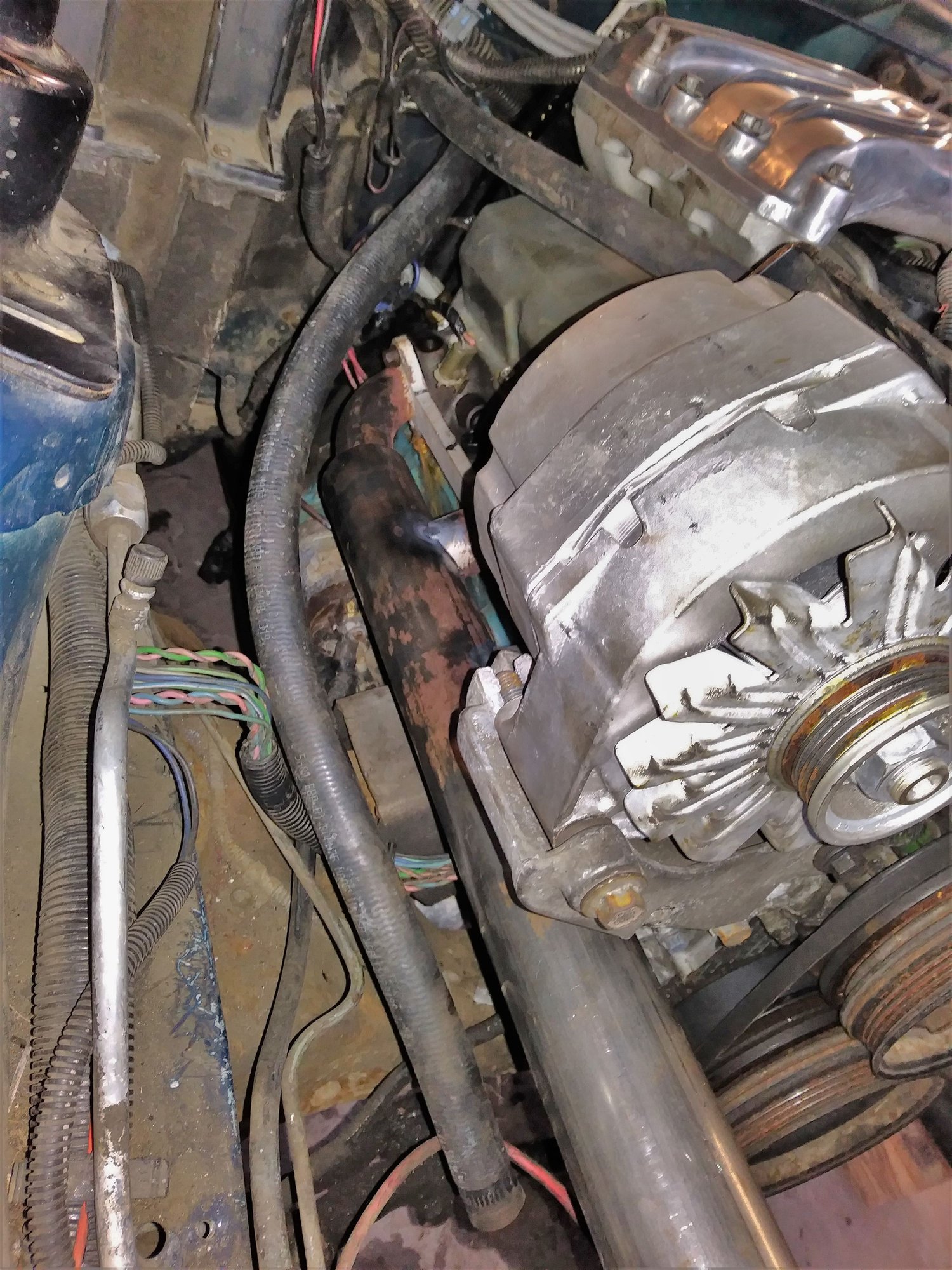

more progress

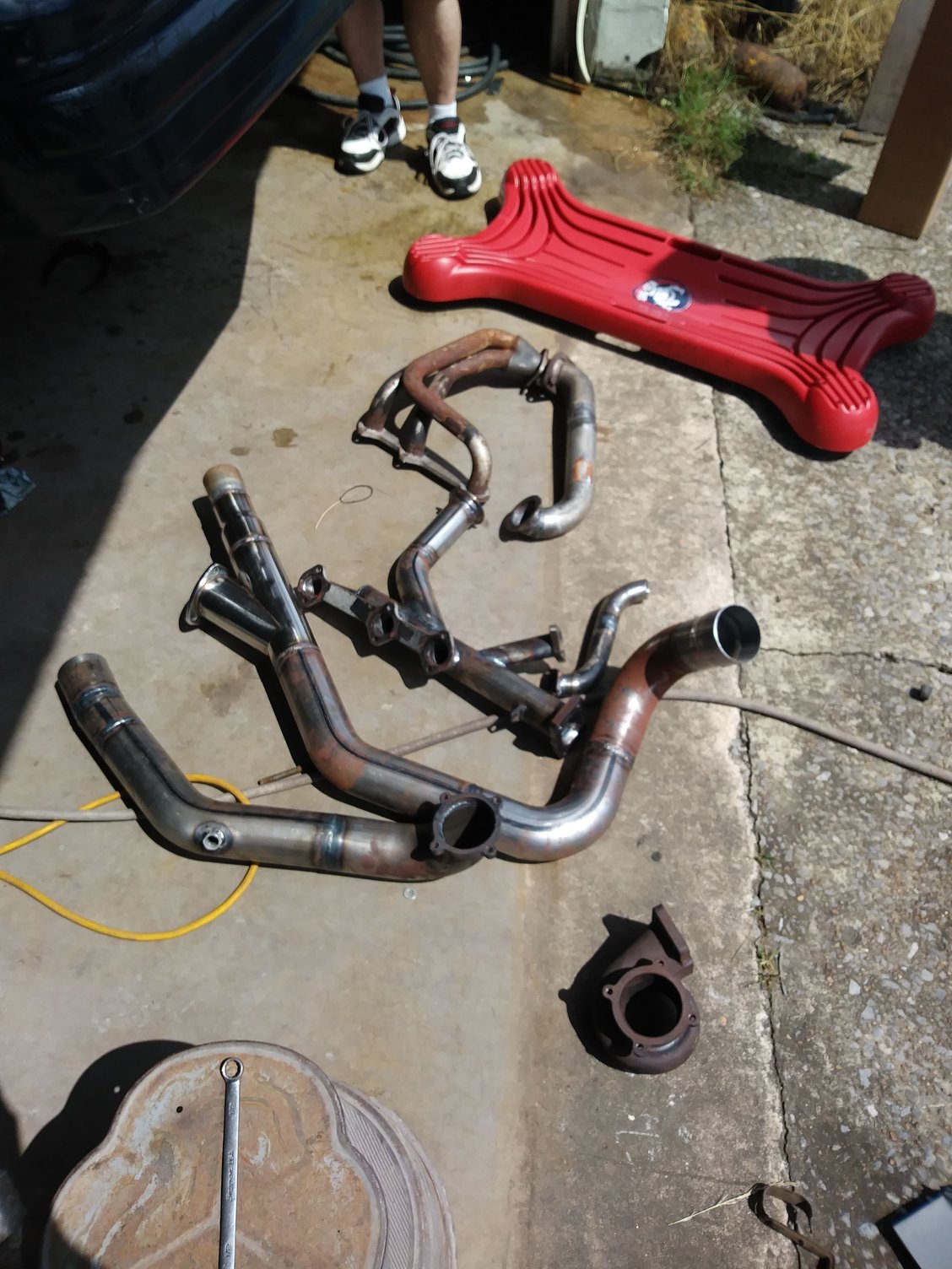

here's the completed system. after I get it sandblasted it'll be ready for the Ceracote c-7600 glacier black coating, good for over 2000 degrees.

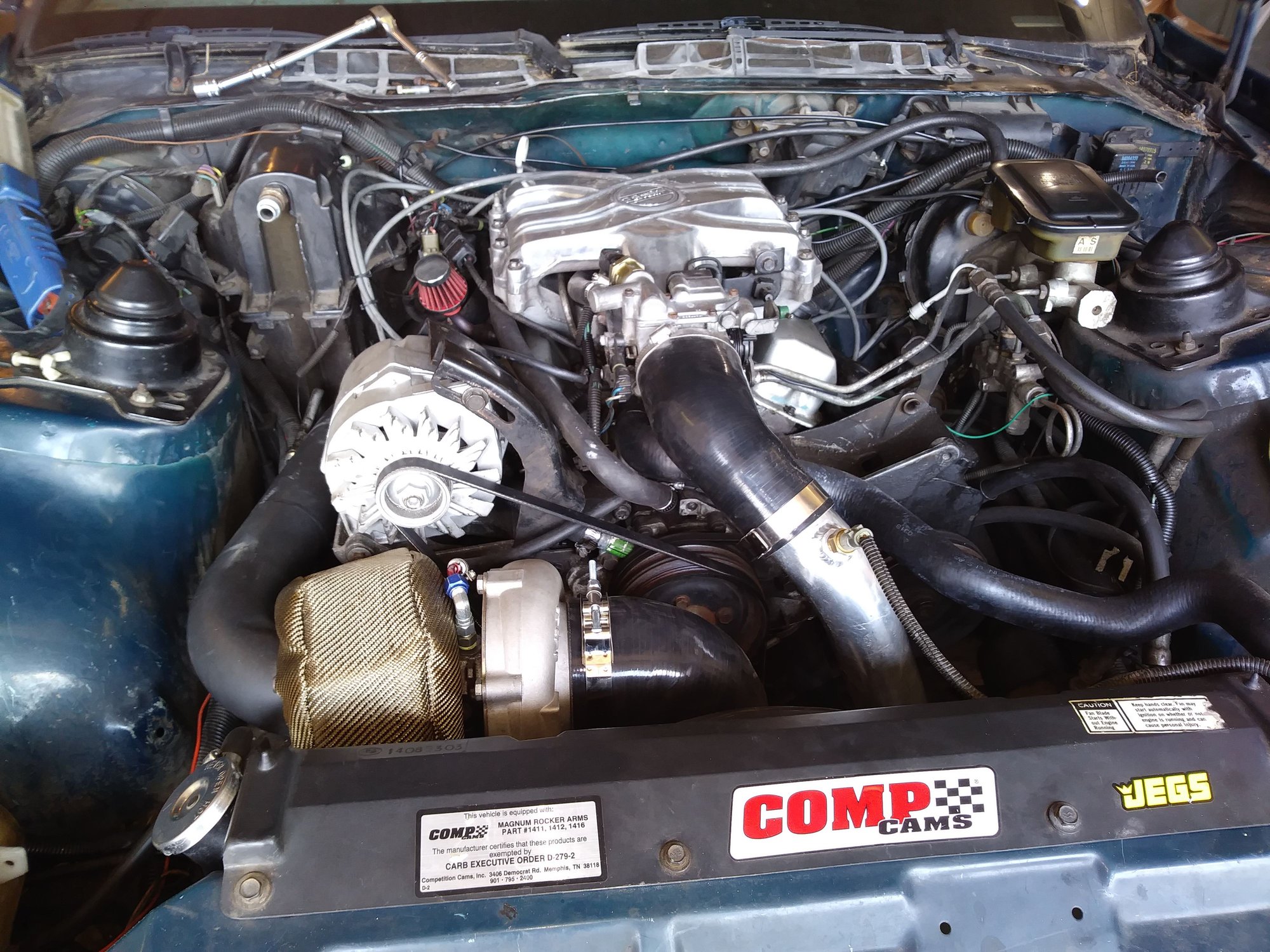

Re: Sierra6's Official Turbo Iron 3.4 Thread
leaving the turbo unhooked until I can get it tuned. stock 3.4 injectors still in for now.
the electric cutout is fun to play with, and I love how it sounds at idle.
I took it down the road twice. felt pretty good for N/A. It dies when I come to a stop. it didn't do that before we took it apart. hopefully this can be tuned out. I didn't make any changes to the IAC or TPS. Left the TPS connected to the TB just like it was.
Can't stop the oil leak at the pan for the return line. Might have to just weld it up.

btw that's an ebay t4 blanket over an ebay t3 blanket.
