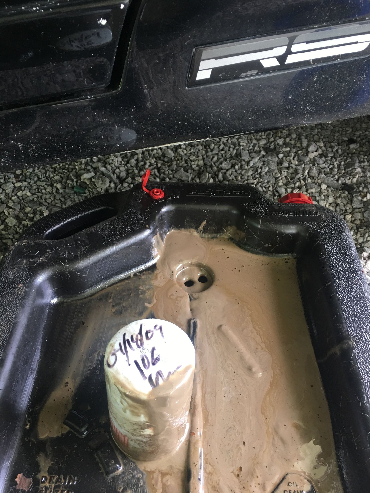

Let me start off by saying I am no mechanic by any means. I’ve changed my own oil for years but that’s about the extent. So November 2017 I got married and my brother in law gave me a 90 RS with a 3.1 that has been sitting for 10 years in a garage. He said it ran when he parked it, and that it just needed a heater core. Flash forward to two weeks ago. I finally got a buddy with a trailer and a winch and brought it home. Went to Walmart and bought 5 quarts of oil, a filter, a can of ether, and a new battery. Drain the oil pan and I get a metallicy silverfish tooth paste looking substance out. Put 4.75 quarts of fresh oil in an a new filter. There was no fuel in the tank so I put in 2 gallons of 93. New battery connected, go to crank it and nothing. Turn the key off and back on an it cranks for 5 seconds or so. Take off the breather and spray in some ether and get it to fire and run for 3-4 seconds. Now it will crank but it won’t start. I’m assuming it’s probably a fuel pump or something of that nature. Any advice is greatly appreciated. I’m 25 years old, and mechanic work is very interesting to me. I don’t have a lot of money to dump into this car but I’d love to have it for a weekend cruiser. Thanks!

Car: 1989 Firebird
Re: New here. Looking for V6 Advice
Originally Posted by Keown90RS
Drain the oil pan and I get a metallicy silverish tooth paste looking substance out.
Your oil is displaying the classic symptom of coolant leaking into the oil , and before you spend a single dime on anything else you need to do a "cooling system pressure test" . You can rent the tool required from your local autoparts store . The pressure test is very likely gonna reveal that your cooling system isn't able to properly hold pressure , you may in fact hear the telltale gurgling sound in the engine as you run the test if you do it in quiet enough of an area . The most common offenders of coolant in the oil are the intake manifold gaskets or head gaskets , although nasty things like a cracked head or cracked block are also less likely possibilities .
Old Jul 31, 2019 | 08:37 AM
Sierra6's Avatar
Joined: Jan 2013
Posts: 396
From: AL
Car: 1985 Firebird
Engine: 3.4 turbo
I can't see parking such a nice running car for 10 years unless it needed some work (like a head gasket).

I hate to be a wet blanket on a young guy's enthusiasm, but let's be realistic. You've got a number of strikes against you here before you even get started. You've probably already spent more $$$ on this car than it's worth right now, and it's going to take A LOT more to get it back on the road. A car that has sat for 10 years is going to require complete fuel, brake, cooling system overhaul, and complete engine tune-up at the very least. If the car was an original-equipment Z28 or IROC, it might be a different story, but a 6-cylinder/automatic RS with a raggedy interior just doesn't have any value.
Please re-read OrangeBird's post, above; you must find the cause of the coolant in the oil, and then decide how to proceed---if at all---from that point.

It may not be coolant in the oil guys. It could simply be condensation. People forget that condensation is a thing, and if this was stored in a humid or environment where there are drastic temperature changes, condensation happens, and can cause the oil to look like that. Running the engine helps evaporate the water in daily or nearly daily driven vehicles so most people never notice this.
Doing a cooling system pressure test is a great idea, but I wouldn't go straight to "YoU'rE hEaDgAsKeT iS fUxOrD m8" from a single picture.
Well, being in Kentucky we have all the above. That’s what I’m hoping. Im going to start with the fuel pump. Watched a video on dropping the tank. Wish me luck
Way more than "condensation".
