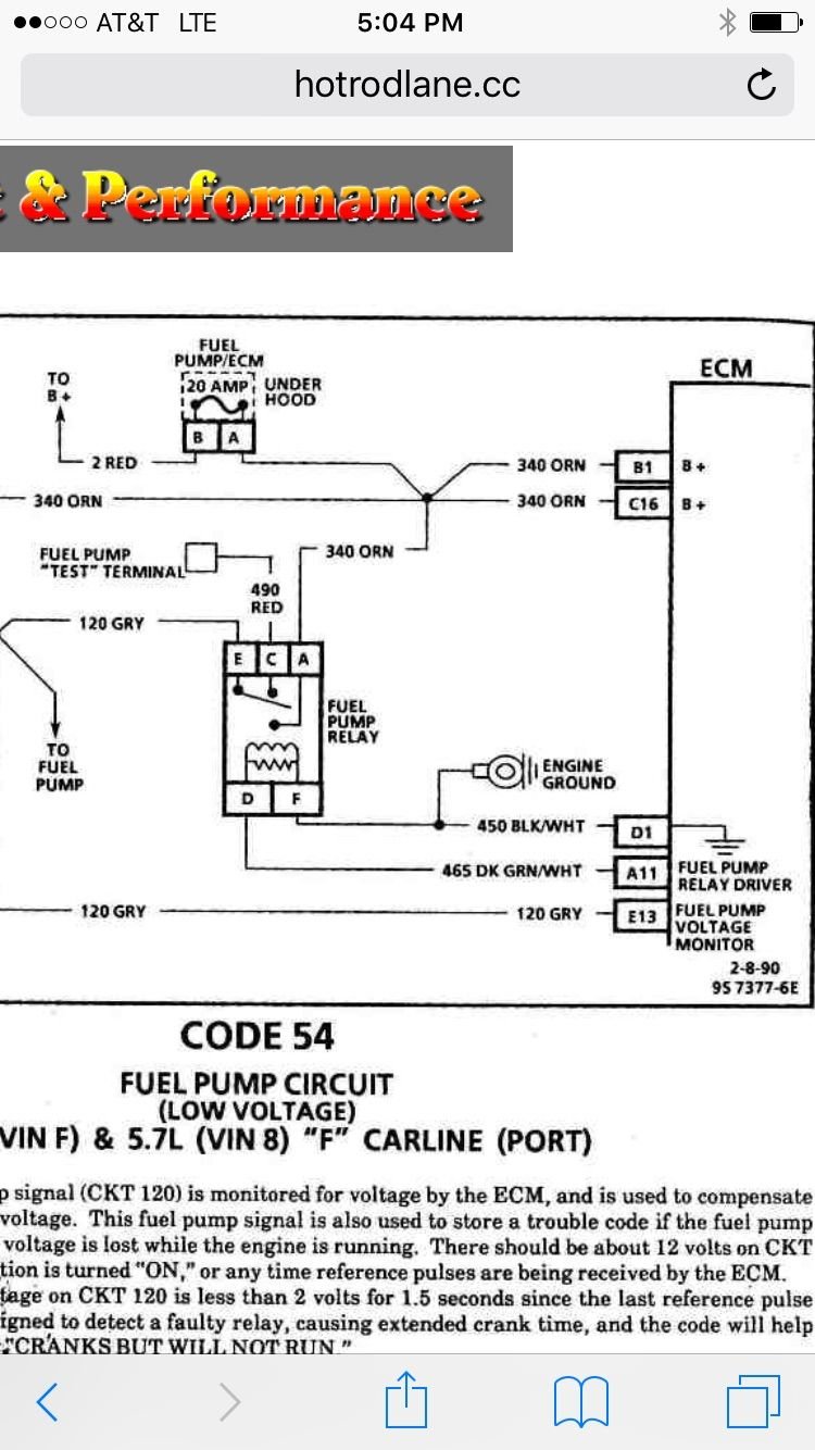

I looked around the threads and couldnt really find an answer. I have a wire running out of what i assume to be the fuel pump relay and cannot find what it connects to if it connects to anything. (the red wire)
Its a 1990 v6 3.l rs camaro

That’s a test lead

Fuel Pump prime wire

How do we use this test lead? Just run to 12V to test pump?
