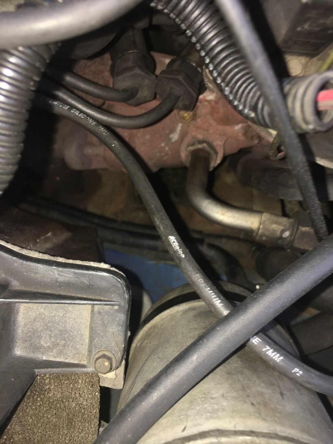

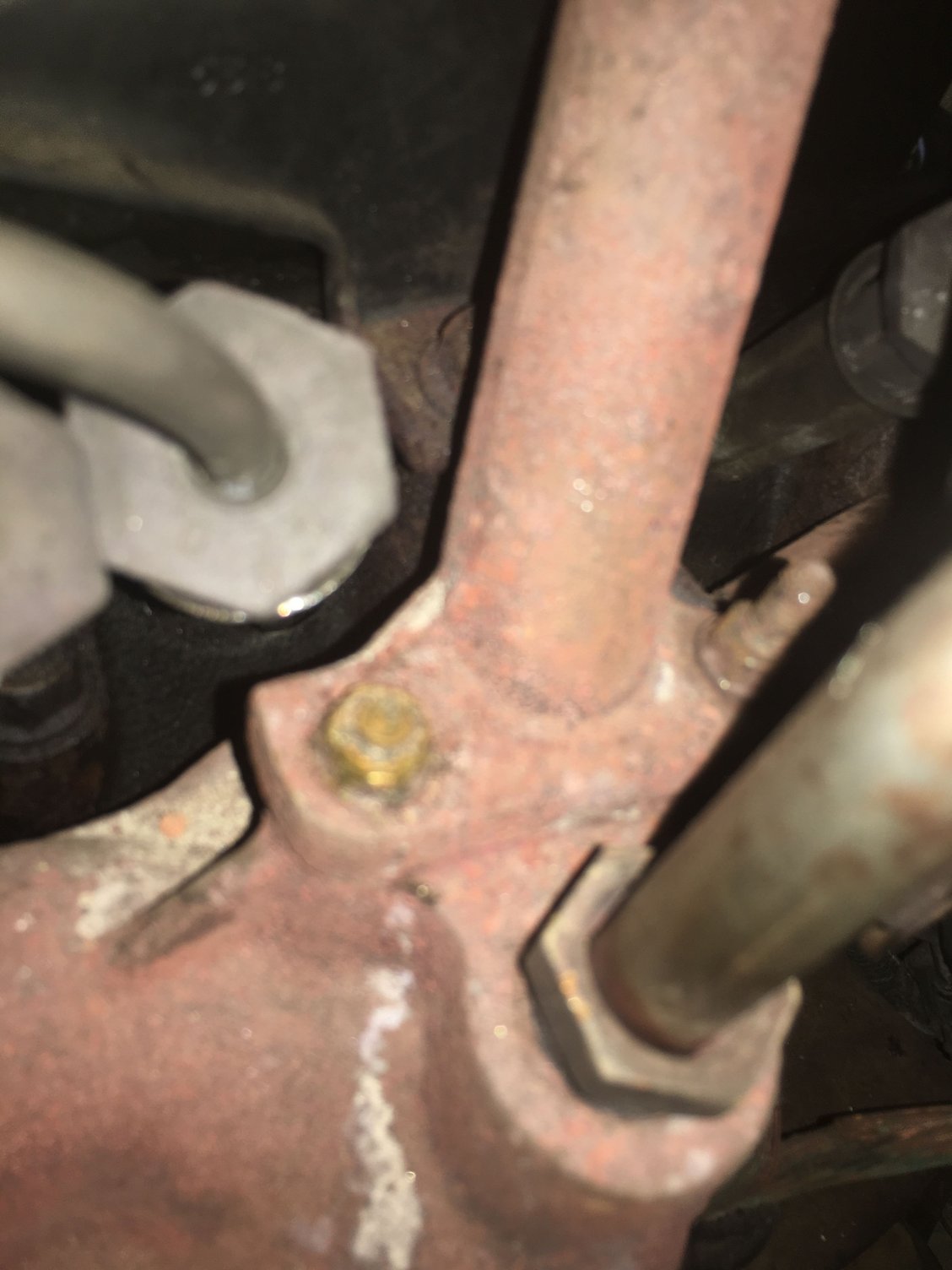

I have a 1990 Camaro rs with the v6 3.1l and after a bit of running it starts to let out white smoke, the valve cover have been replaced recently and I?ve already checked them for leaks, I have photos of the specific area where the smoke originates and was wondering if anyone?s experienced a similar issue.

It smells like burnt oil inside the car when it starts up and the white smoke is coming from the engine baby not the exhaust and it only really starts smoking from the engine bay after running for a bit
