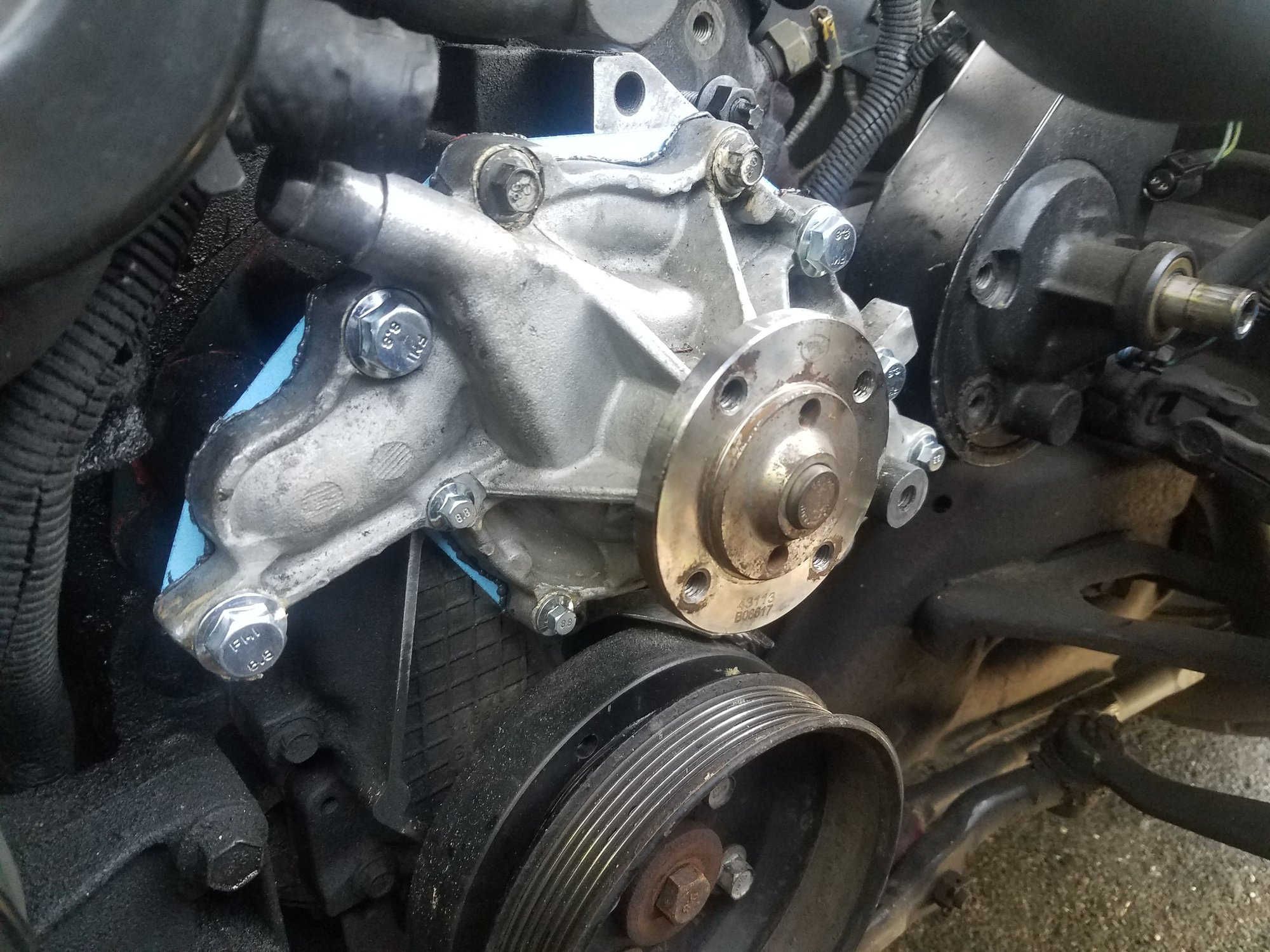

I had to re-gasket my water pump recently, so I decided to go out for new hardware. Since no time I've ever looked has there been a post about this other than "Go to Lowes and size them up", I did, and here they are!
M10-1.50mm x 70mm (x4)
M6-1.0mm x 25mm (x3)
M8-1.25 x 70mm (x3)*
M8-1.25mm x 40mm (x1)
*You can find flange bolts in the wild for everything but this M8. If you want a flange bolt specifically, you'll have to order them online. But if you don't mind going with washers, they're available in the "Need-A-Part" section of AZ, AA, O'RA, and PB.
Hope this helps someone in the future!
