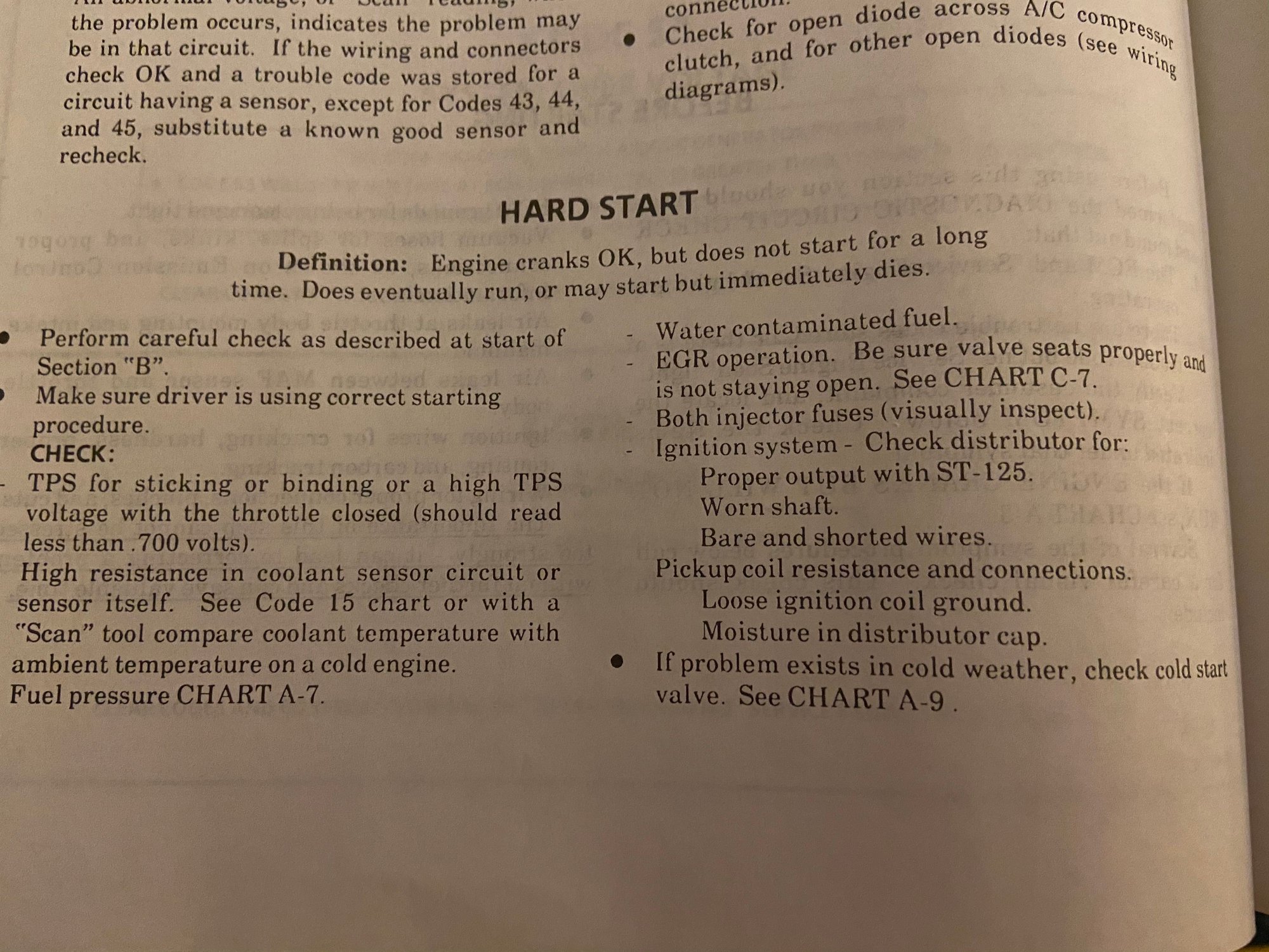

I have an 88’ factory service manual I just took a quick look and a few photos of the V6 trouble shooting pages, hope this helps.

Part 2 of hard start diagnosis on top:
