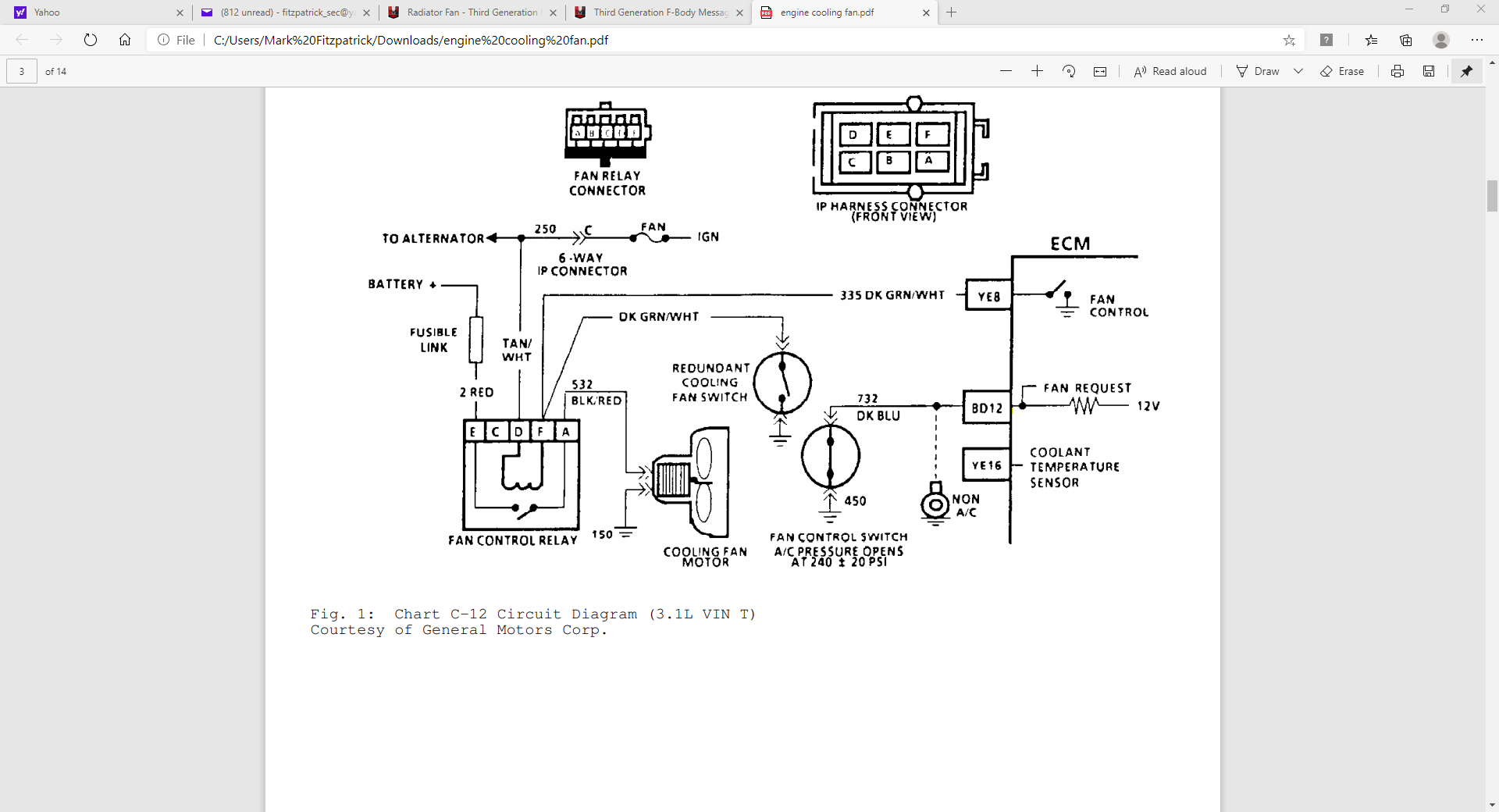

Run one wire from F terminal of the relay to one side of your new switch. Then connect the other side of your new switch to any ground like the metal on the firewall or any other place that easy. You could run this wire to battery ground if you like. The existing fan relay already has positive voltage on the D terminal via the tan white wire.
If you look at the drawing the ECM or computer and the cooling fan switch on the engine both supply ground to the relay terminal F. This is what Bob is telling you.
So to test with the key on connect a wire from the F terminal and the other end to any ground. Your fan should run.

Mark, one last question, on terminal F there are (2) Dark Green/White wires coming out of that terminal. One goes to the ECM and the other goes to the radiator Fan Switch. How do I know which wire to tap into?
Old Aug 13, 2020 | 03:08 PM
Mark RWC's Avatar
Joined: Nov 2011
Posts: 142
Re: Radiator Fan
Bob suggested using the one that connects to the head temperature switch as it probably the easiest place and will look the cleanest to connect your new wire going to your new manual switch.

I've already hooked it up by your description and it works after turning on ignition switch and then activating the on and off toggle switch. It started up and seems to idle okay. I'm not a bout to change it.
