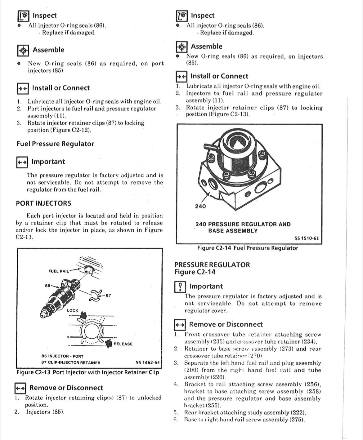

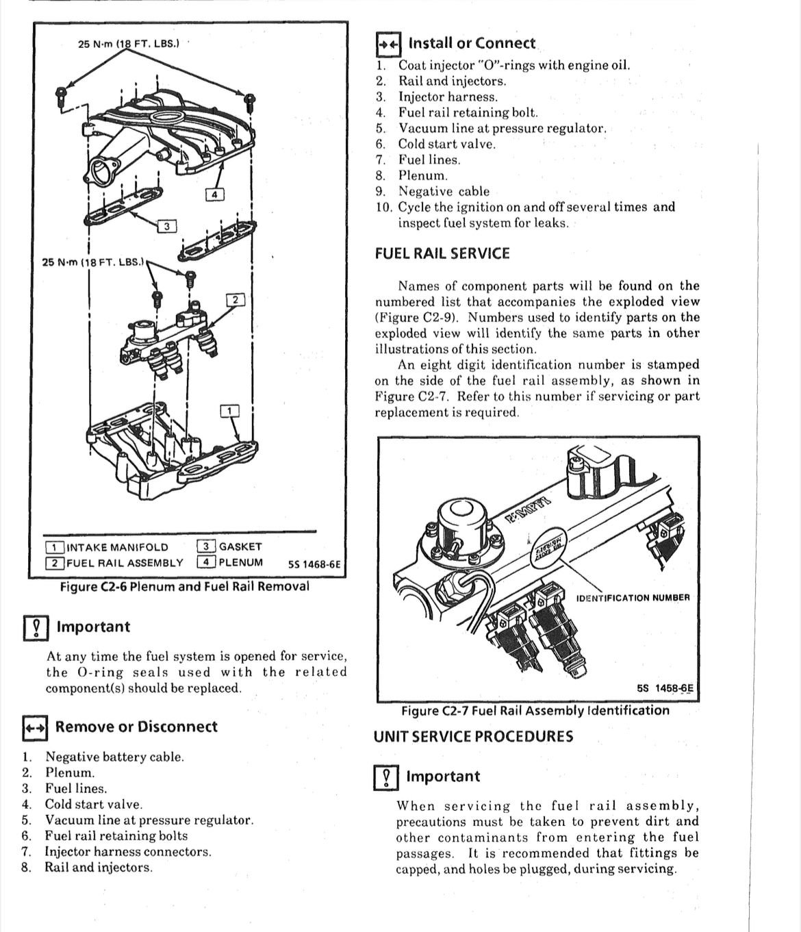

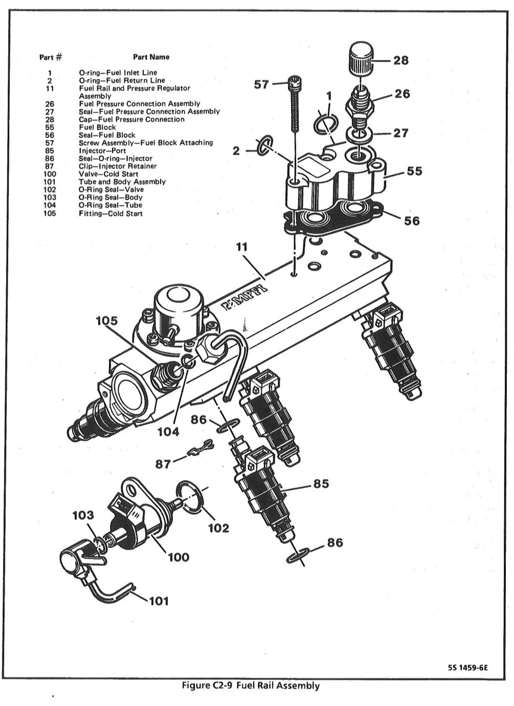

I am not sure if the 3.1 uses the same setup up as the 2.8, but I would assume so. Here are some screenshots from the shop manual about replacing injectors. If you have any further questions, I would recommend downloading the shop manual with the link I provided in post #2.
Basic overview of the fuel system
Intake manifold labeled
Fuel rail labeled
Injector replacement process
