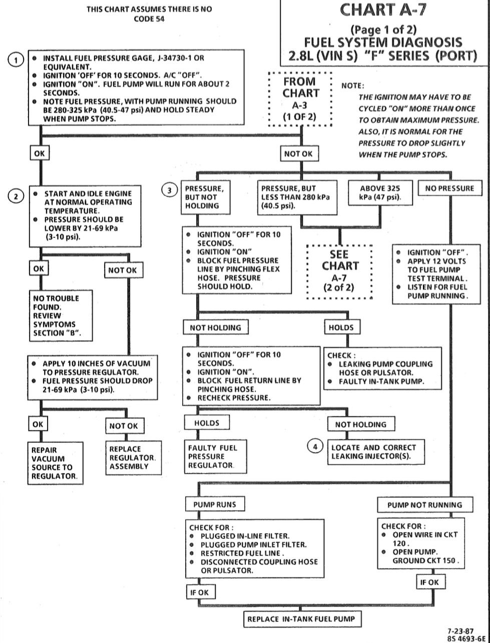

Well, I was going to give you some pages out of the ‘88 service manual but then I read “3.1” and I’m not sure how similar they are in this situation. Probably identical but I’d hate to give you bad info.
If you want to find a fuel pressure leak however, that’s pretty easy. Obviously get a fuel pressure gauge, slap it on the test valve (don’t lose the cap!) and prime the pump. Pump should be between 40.5-47 PSI. It should hold pressure for at least 20 minutes. Assuming it primes to the right PSI, if you have something leaking it will (obviously) drop as you watch the gauge. Release the pressure, then get a clamp or vice and pinch the rubber fuel pressure line. If that makes the pressure hold, then the fuel pump is leaking.
If it still drops, do the same thing but pinch the fuel return line instead. Make sure you’re reallyyyyy pinching these closed. If it holds, that’s a bad fuel pressure regulator. If it still drops, then prime it again and pinch both hoses. If it holds, you messed up one of the other two tests, and if it drops, then the injectors are leaking.
That’s what I did to find my leak (and then bought Southbay injectors, which is my recommendation for replacements) and haven’t had a problem since.
Not sure how much I can help with the EGR, I believe 90-92 had a different digital egr system, or something?
Diagnosis chart for the 88 2.8. I can get you the pages for the codes as well if you’d like. Would be similar charts.
