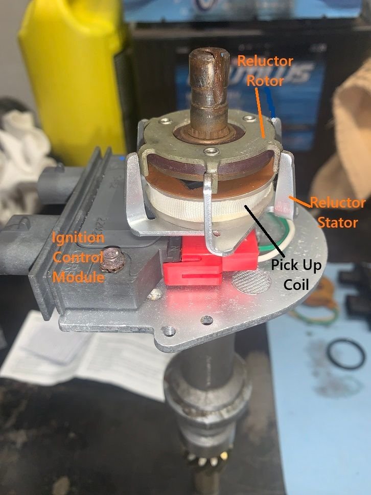

Thanks for the reply! When I say that, I mean I followed the guide from the factory service manual; let it get to temp, unplug the EST, set the timing, tighten the distributor, check the timing again to make sure it's right, turn the motor off, plug the EST back in, disconnect the battery and leave it for at least 30 sec, reconnect the battery. This is how I did it when I replaced the distributor 4 or 5 years ago as well, and as I mentioned, I think even back then I had to have it set close to 20deg BTDC initial (with EST unplugged) for it to run happy. Factory spec is 10 BTDC.
I'm just still not fully convinced that it's the timing chain, considering the timing mark still lines up at 0deg when cyl 1 is at TDC... but again, not really an expert, could be a red herring. I'm starting to wonder if somehow, I just clocked the distributor wrong when I installed it initially? Didn't have much experience with motor work back when I installed the thing, but also not sure how possible it is to install a dizzy wrong. At this point, I'm thinking I might as well check. As annoying as it is to deal with that clamp, it'd be easier than pulling the timing cover. I'll do some more reading on that while I'm still stuck here in the office (Fridays are slow ) and maybe give it a shot once I'm home.

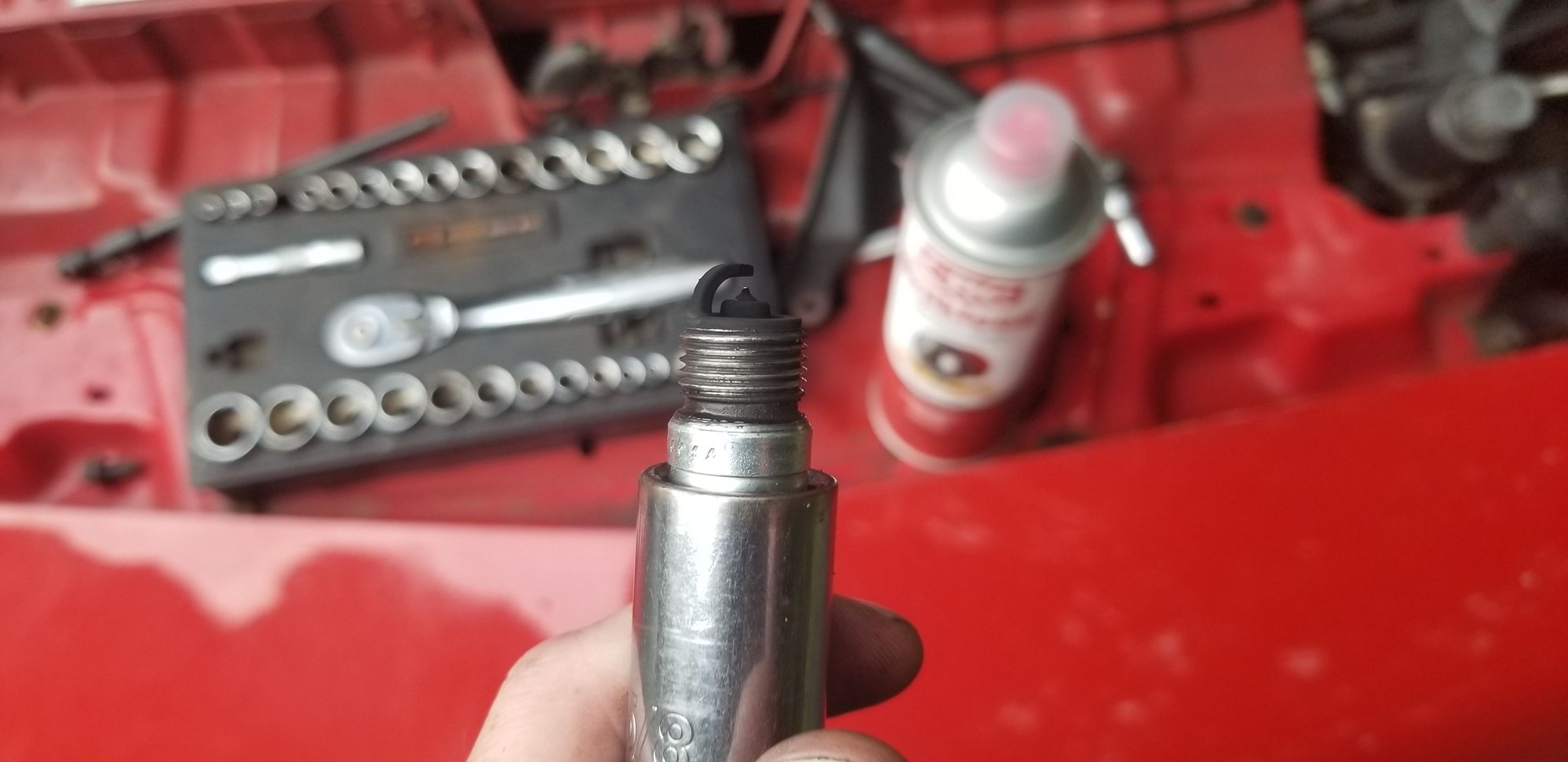

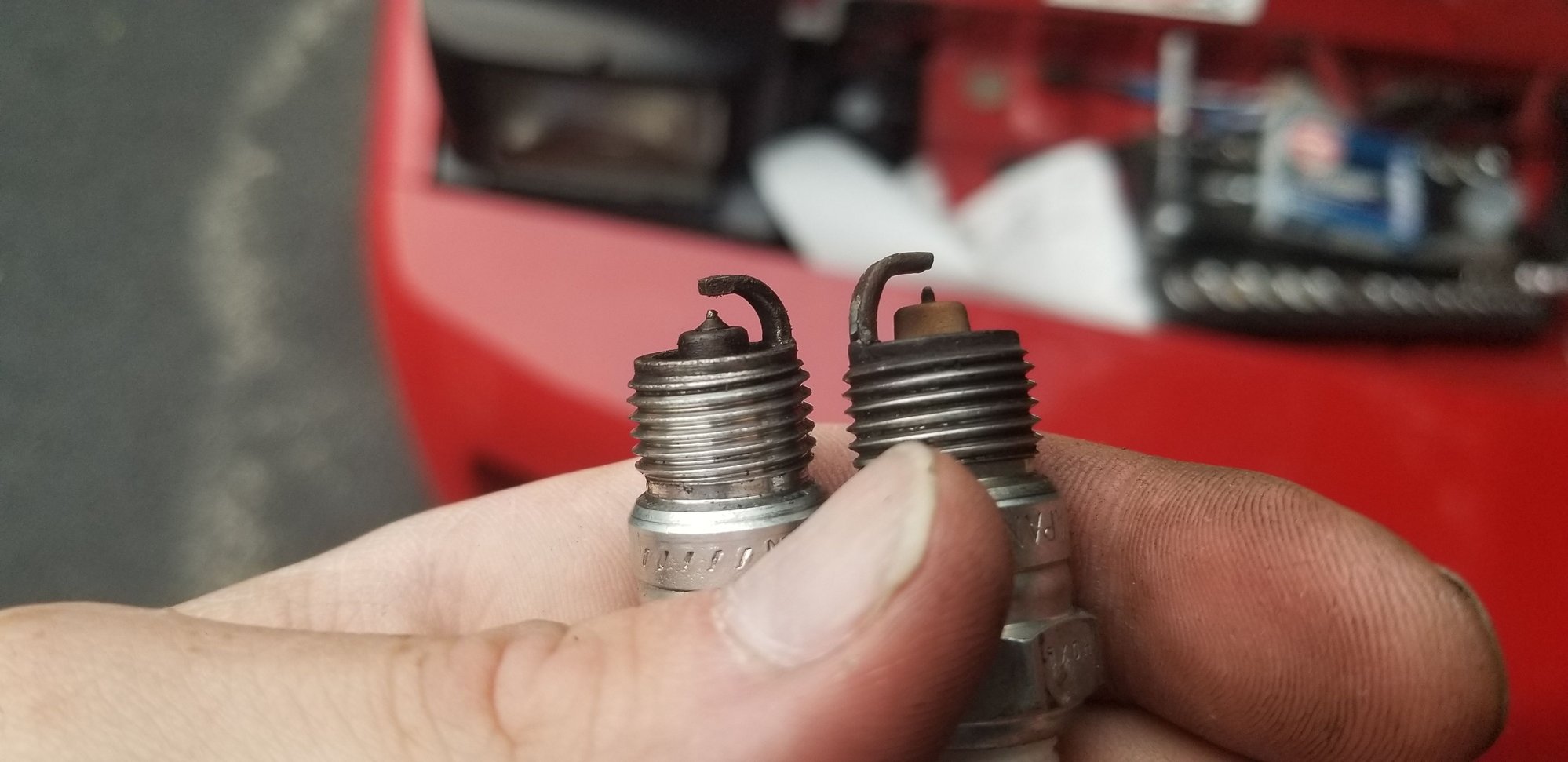

I pulled my brand new spark plugs yesterday, and they are all already fouled;
Originally Posted by LLCooLM495
I do notice that sometimes I hear a sort of bubbling sound when the pump is done priming...
You have now described two classic symptoms of a failed fuel pressure regulator......

Yep, my thoughts exactly! The chain and FPR are supposed to both get here on the same day, it'll be quick and easy enough to do the FPR first and see where that gets me. Hope I don't tear the new upper intake gaskets, just put those on last week... it'd sure be easier than tearing into the timing cover here's hoping that the engine is just unhappy because of all the extra fuel, but I do have some doubts since it was running well enough for years with a (presumably) bad FPR... that bubbling noise isn't exactly new, I just never thought much of it. Here's a couple pics I took of the plugs last Monday:
New plug after running for about 20 min
Brand plug after running for about 20 min
New plug on left after being cleaned up; 2 year old plug on right
New plug on left after being cleaned up; 2-ish year old plug on right
The plugs that were in there for the last couple years didn't look too terrible, but the new ones certainly weren't too happy. Granted, the 20 minutes or so they were running, I was trying to set timing, so that may have played a big part in it. Could also be somethin to do with the new plugs being iridium, but I've run iridium plugs in the past without issue. I got a cheap set of copper plugs in there for now, not sure how they look. I'll go ahead and pull one when I do the FPR, I'd imagine they're lookin similar to the iridium plugs here though. All of em were gapped to .045 per factory spec btw (old ones were closer to .05, but that'd just be from wear. I know I gapped em to spec before they went in)

It seems odd that the timing is out as far as it is. I believe these engines use the reluctor rotor and stator to determine engine position.
Is it possible that the reluctor rotor or reluctor stator is loose on the rotor shaft or distributor base and one of them is moving, causing your issue?
The only other reason that I can come up with for the timing to be out that far, is that you haven't got the EST disconnected when you are checking the base timing.
This is what it looks like on my 1986 2.8L.
