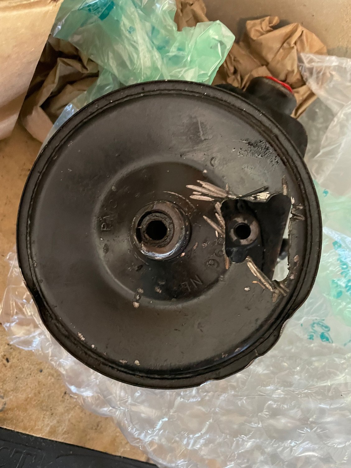

I have a 91 v6 RS and while changing out a bad water pump, I had to remove power steering pully. The lip on the pully broke while removing. I cant seem to find a replacement that fits a serpentine belt that can be confirmed OEM replacement. Anyone else come across this issue? Or have a suggestion.

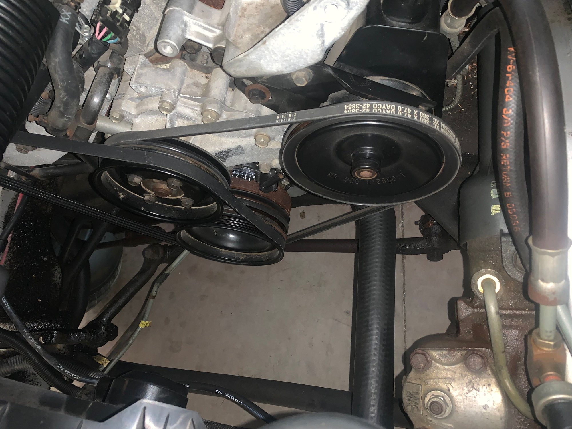

Are you sure the power steering pump has a serpentine belt?
My 1986 V6 has a serpentine belt on the water pump but a Vee belt on the power steering.
I'm guessing you need a water pump pulley that has both the serpentine belt and Vee groove pulleys.
I did a quick online search and didn't find one of these pulleys new, so you may have to visit your local auto wrecker.

Ya im sure. After cleaning the build up off I found the PN# 14100597 but can only find used on ebay. I find it crazy that no one makes an aftermarket.

Were you using this tool?
https://www.summitracing.com/parts/wmr-w87022

Yup, similar rental from o'reilys
He has a '91, so it would definitely be a serpentine belt. I was in the local yard the other day and came across an '87 with a full serpentine 2.8L as well, and recall an '88 at that yard years ago with the same. I don't know for sure, but '86 seems to be the last year that V-Belts were used on the V6
