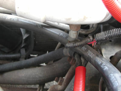

yea, just get it inside the tub somewhere....this is under my 45* bend. i just made a whole with a paddle bit and it screwed right in.
