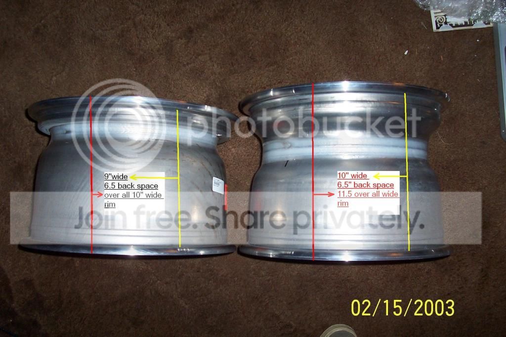

this is a 6.5 back space on a 10.25 wide wheel (15" rim) . with a stock with rear end..a 17" wide rim would give you a bit more rear caliper room
but with this type of back space you will need to remove your bump stops..and do inner wheel well modes.
always have rims for tires..not tires for rims..(the race tire set)

some basic pics
https://i573.photobucket.com/albums/...heels009-1.jpg

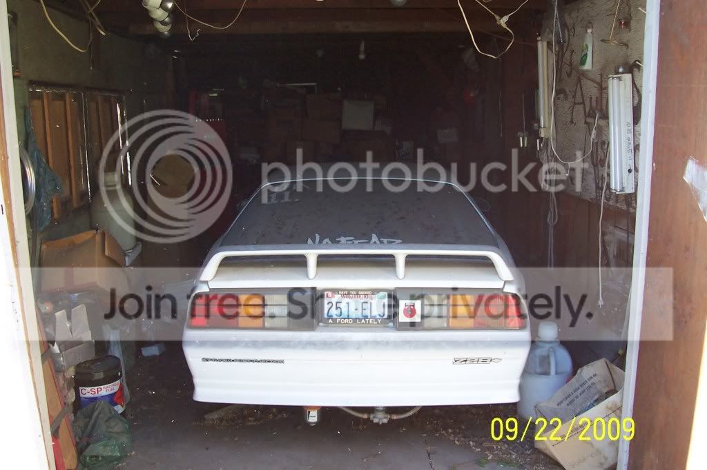

this shot shows 4.5 back space wheel 8.5" wide rim (10 years of sitting)
https://i573.photobucket.com/albums/...k21/z28490.jpg
10 years...
https://i573.photobucket.com/albums/...k21/Z28002.jpg
