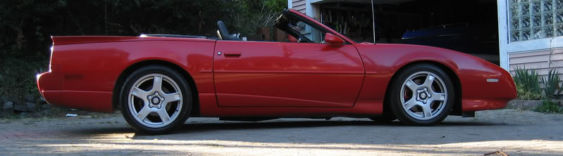

Re: C5 Wagon Wheels on a Third Gen
17/18
18/18

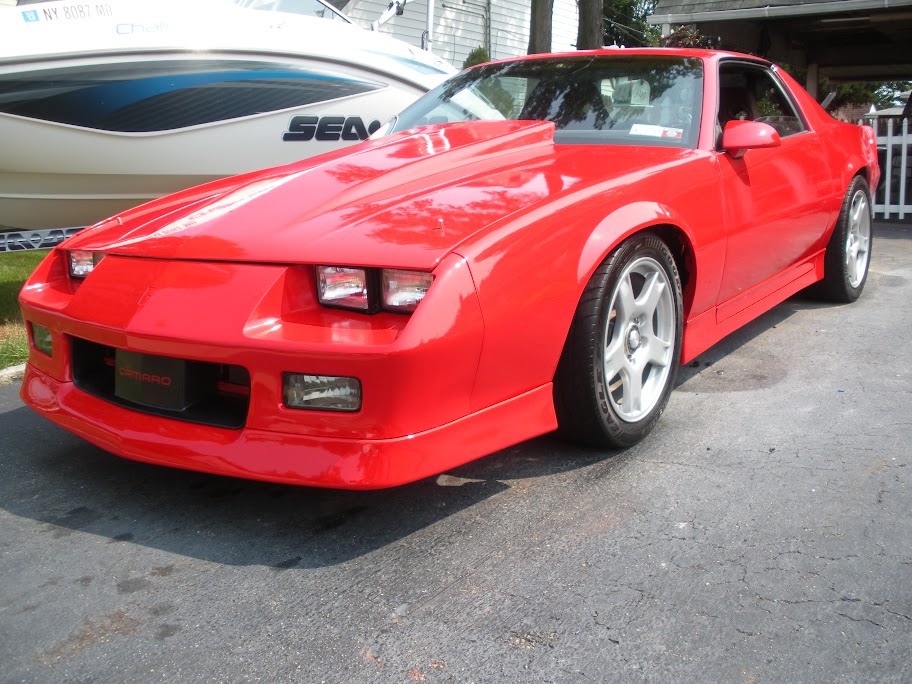

heres mine

Originally Posted by blackbmagic
heres mine
Hey is that lowered at all. Looks great.
Old Feb 11, 2013 | 01:23 PM
blackbmagic's Avatar
Joined: Mar 2010
Posts: 865
From: LI, NY
Car: 1985 IROC-Z
Engine: 355
Axle/Gears: 3.42 10 Bolt Posi
Nope, It wasn't lowered in that photo but it is now :P
There are no mods, just spacers. No need to be intimidated, someone with ZERO knowledge about cars or mechanics can EASILY do this.
BTW. The stock center caps with lug covers are HIDEOUS! Take a look at mine trimmed off the lug covers and cleaned up the edges. 100% better than original.

Originally Posted by NemeSS-TyranT
Man, that looks fn awesome!
Thats the look i had in mind. What springs and struts are u using in front and rear?
Are the wheels 18 all around and tire sizes. i have (6) oe 18 chrome wagon wheels.
Cuz i thought they looked rad on 4th gens. But they look better on 3rd gens
Billsteins in rear and KYB in front.
Dropzone springs, removed Isolators and cut 2 coils in the rear.
17.8.5 and 18x9.5 staggered set
Stock C5 tire sizes. 245/45/17 and 275/40/18

Better late than never I guess...Here's mine when I still had my wagon wheels:
Attached Thumbnails C5 Wagon Wheels on a Third Gen-camaro.jpg   C5 Wagon Wheels on a Third Gen-83-z.jpg

Here's mine.
Ignore the "gaps"; the ground it's sitting on is uneven. Sits about level on level ground.
These are w 2" spacers all the way around.
