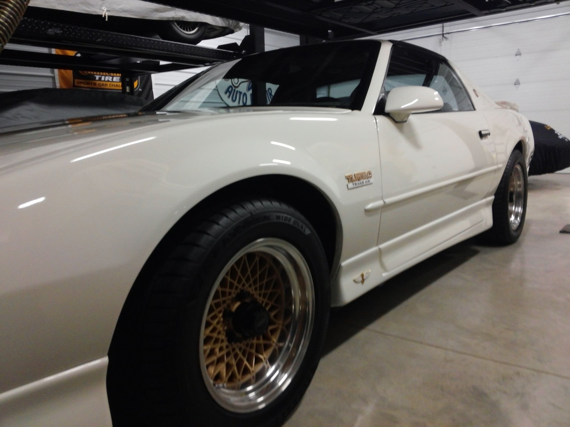

Its possible, I am running 4 fronts on my TTA with Firestone Indy Wide Ovals. 245 50 16's . Tires can be rotated. No issues with about 500 miles.
