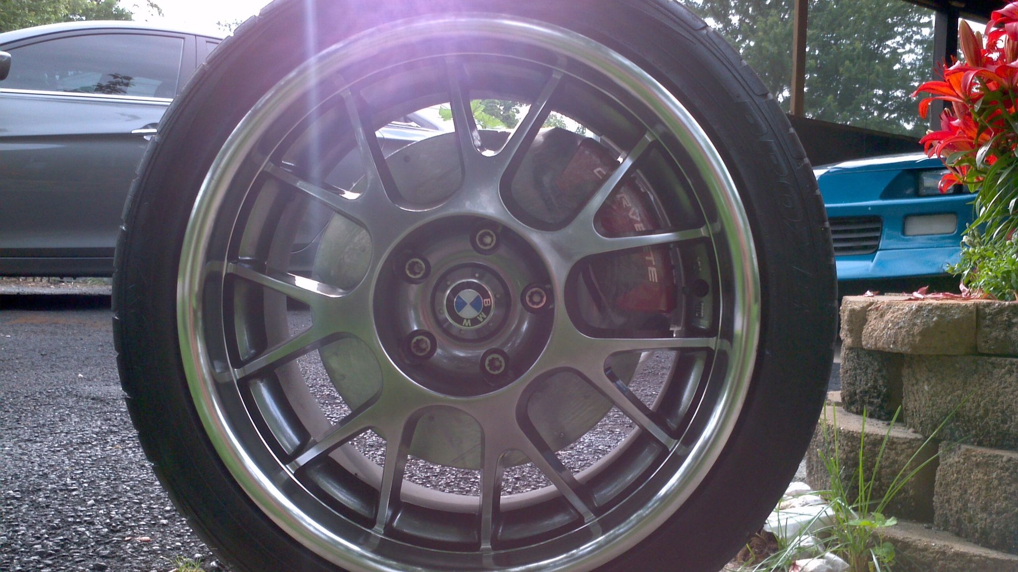

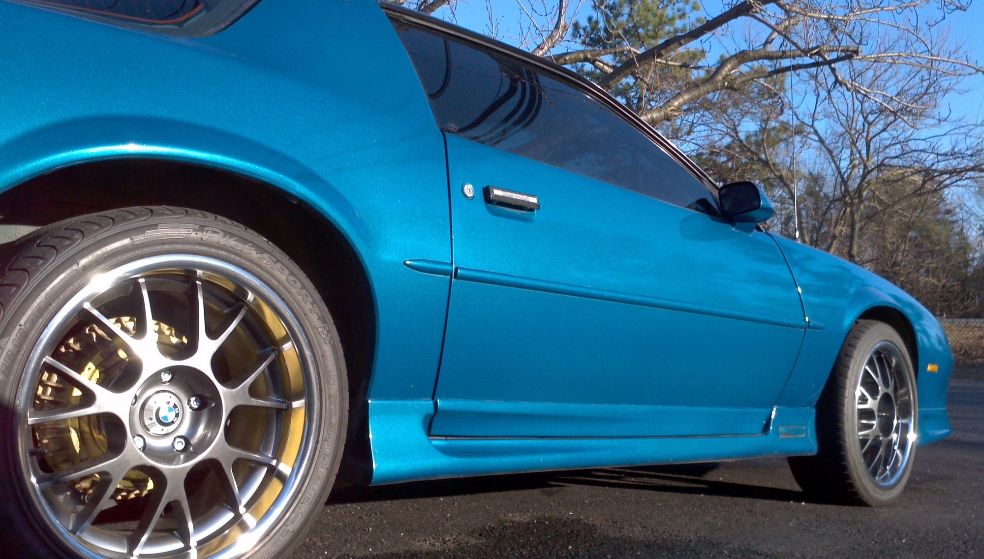

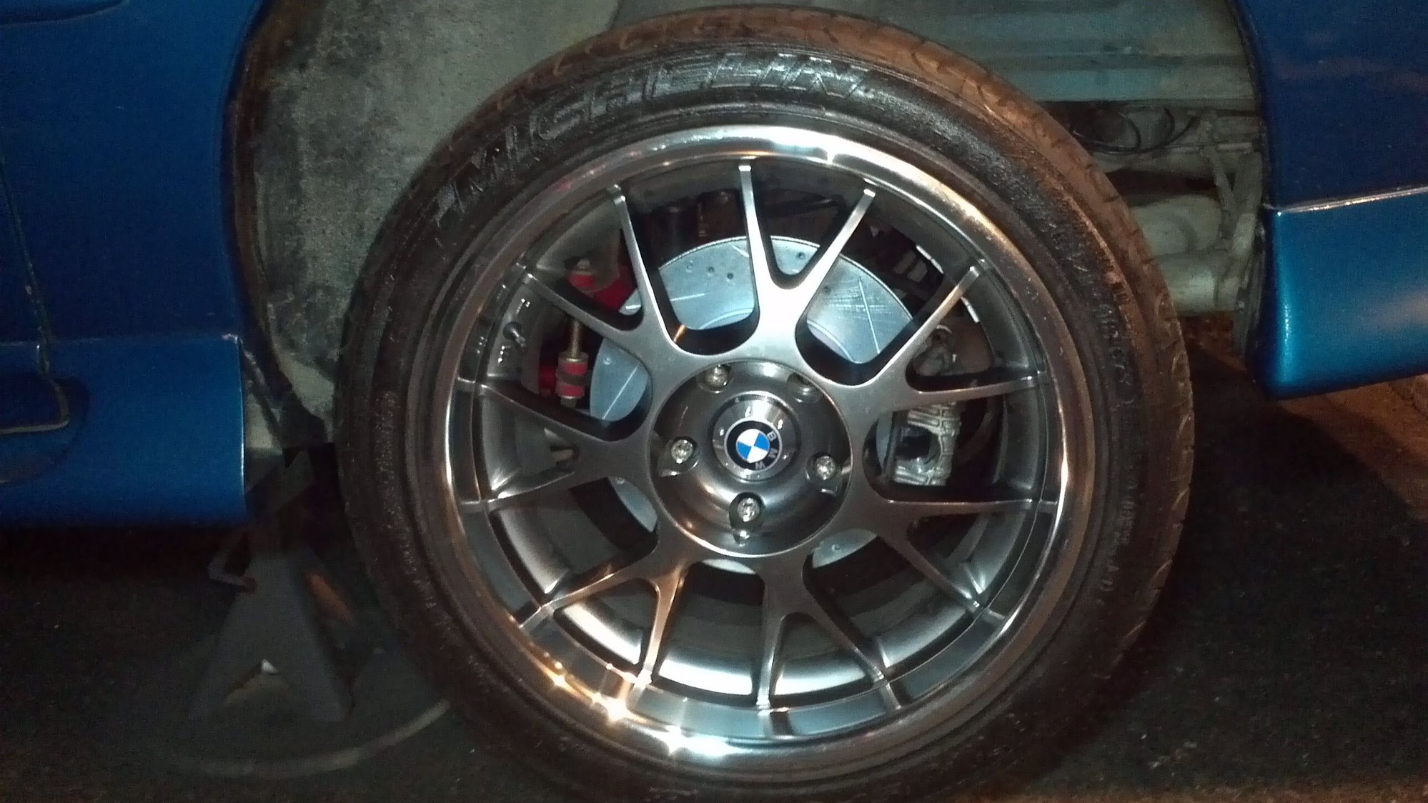

BMW wheels on a Thirdgen Camaro IROC Firebird Trans AM
ALL about BMW wheels on a Thirdgen Camaro IROC Firebird Trans AM

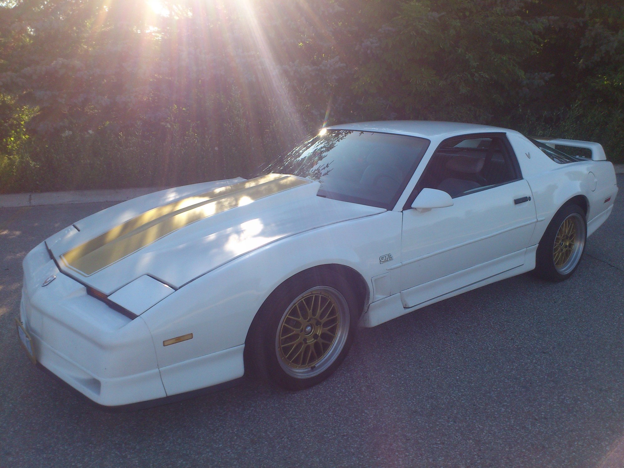

I reference TGO member cal30_sniper on this since he's had some sweet looking rides using the M Parallel OE BMW wheels. He sort of pioneered the idea for me.
Ive ran BMW wheels daily (and to the track) but mostly to and from work for several years now.
The main issue is that theres seriously a lack of choice in our sizes. Do a search.. take a good long look see, and when u type in 5x4.75" you are limited to Torque Thrust and Vette wheels, Cragars etc...
Im making information available about more choice in wheels.

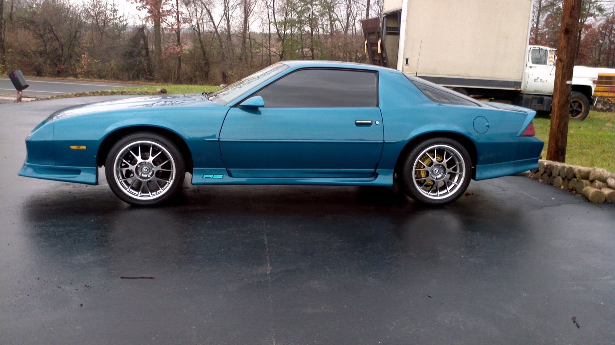

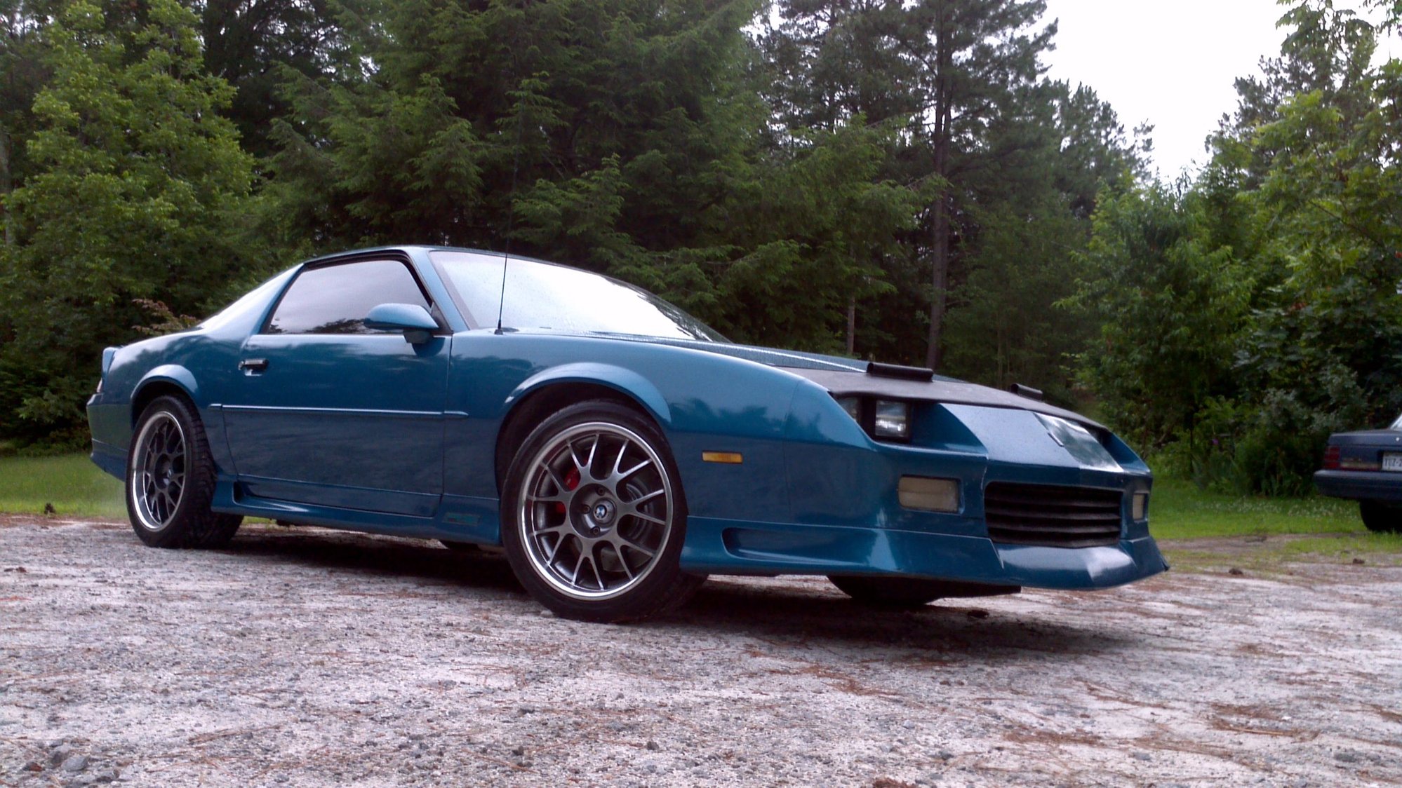

for instance: cal30_sniper got wheels that belong a 2001 7 series with the sport package :
Front 18x8 ET +15 (with 10mm hubcentric front spacers)
Rear 18x9.5 ET +25
BMW 5 series will have a larger hub bore but same size wheels ... either will work.
This is only to provide information Ive learned and applied over the years.
BMW wheels and Aftermarket BMW wheels offer an immense range of choice. Mesh wheels and Five stars and all sorts.
5x120 will bolt right on. Yes they bolt on (With Exception to weird offset wheels and our front hubs which i will get to in a moment)
The M Parallel wheels bolted on my car with no problem and with only the need of a hubcentric ring built into a 8mm spacer, which was only to keep it centered not
to space it out. Without this bit of space u lose the centercap since the fbody wheel hub sticks out a bit.
BMW rims are all over so be sure to find them with a low offset so they will bolt on with minimal hassle.
Search for wheels that fit older 5 and 7 series mid 1990s thru early 2000's. These will have lower offsets and some will have a nice staggered setup.
Our offset is basically close to 0 .
for example: Find wheels with a 74.1 hub centerbore if you are able to.
Get all 4 wheels from the same source/car and you will need to keep in mind hubsize, seriously since ours is like 70.3 for the E39 5 series for instance will be 74.1. and the 7 series will be 72.5 its a pain in the wazoo to mix and match if you get them from different sources. Be sure to go on ebay and get a hub ring for the rear. Its 70.3 to whatever u need to shim it. that way it lines up centered and not off to one side when u bolt it up..
My scenario for example involved 70.3 to 74.1 rings and this works for both drum and disk in the rear.
The Front:
U need a hubcentric spacer or an adapter depending on whether its an aftermarket bmw wheel or a stock OE style wheel. stock M Parallel wheels will have a +20 offset from the getgo so u need to only shim it to clear the space for the centercap to be put on.
in my case Ive found that a 5x120 8mm hubcentric spacer will work. (74.1 to 74.1) (they can be gotten from ebay) now if u dont care about center caps it will bolt on. however it looks a little wierd without it. The Front hubs on these cars suck since that hub bearing snout sticks way out, its a odd design.
You cannot use the same hubbrings from the rear on the front end. The hub on the front of the car has a hub and rotor all in one giant peice. It tapers down and at the base its actually slightly larger than 70.3 at times. Furthermore the rotors are not made perfect some are larger and taper down at a slightly different rate. In this case a spacer with a hubcentric ring
built into it is the best idea. 8-10mm should do it, if that doesnt clear then try 12mm to allow that centercap to stay on.
The spacers you get might not always seat down the base of the hub properly. The width is not exact when they mold or create these stock rotors/hub assemblies that you get from the local parts store. And furthermore the hub base on the car ..if its stock and hasnt been replaced in a while then rust also makes it larger around and the spacer wouldnt seat. get a sanding pad or anything to sand it down or grind it down smooth where it should be.
one other thing of note when dealing with spacers on the front.. if you have stock brake setup on the front end, sand it down and clean the hub and the base and all around the lug studs.
Note an adapter/spacer that says 70.3 gm to 74.1 hubcentric adapter since the hub snout will catch on the lip of the inside of the spacer and wont slide all the way down. you can open it up but then theres not much material left if any to be useful for "hubcentric" so basically you have a spacer without the hubcentric ring to center the wheels when they go on.)
**IF your wheel will not fit over the hub, (meaning the hub snout wont poke thru the centerbore of the wheel deep enuf or in the case where the centerbore is too small in the wheel and it needs to be spaced out to clear the nub. You can get by with a 1 inch 5.75" adapter found on ebay all day everyday to shim it out a inch and still be able to bolt the wheel on the car. dont get the hubcentric.
When i say adapter its not just a spacer. IT bolts to the car, then the wheel bolts to the spacer/adapter. Its got its own set of lug studs pressed into it and comes with lug nuts and is to be installed and torqued down just as a wheel would be. This is better sometimes if you need a thick spacer opposed to a regular spacer that just slips on and then thats it, leaving you with less thread engagement and the lug nuts wont have material to grab onto.
Basically Adapters need to be torqued down and then put the on wheel and then torque Those down as well. *
I personally dont run adapters with BMW M Parallels. They bolt on however U do need to make it centered with hubcentric rings. those can be easily found on ebay just measure what U got against the new wheel's centerbore.
Spacers, can change scrub radius, increase tire wear and reduce wheel bearing life, so keep that in mind those things could eventually occur as well as fender damage. A safer idea is to get wheels with the correct offset to eliminate the need/cost for spacers altogether.
If you have to get it spaced out then always use the smallest spacer or adapter you can get by with.
Note:
The REAR DOES NOT NEED, SPACERS, OR ADAPTERS unless the wheels you bought has the wrong offset. Corvette wheels need them.
Again it should only need HUB RINGS
The BMW wheels should BOLT ON with just hubrings. measure and compare each to be sure you buy the correct sizes from ebay.

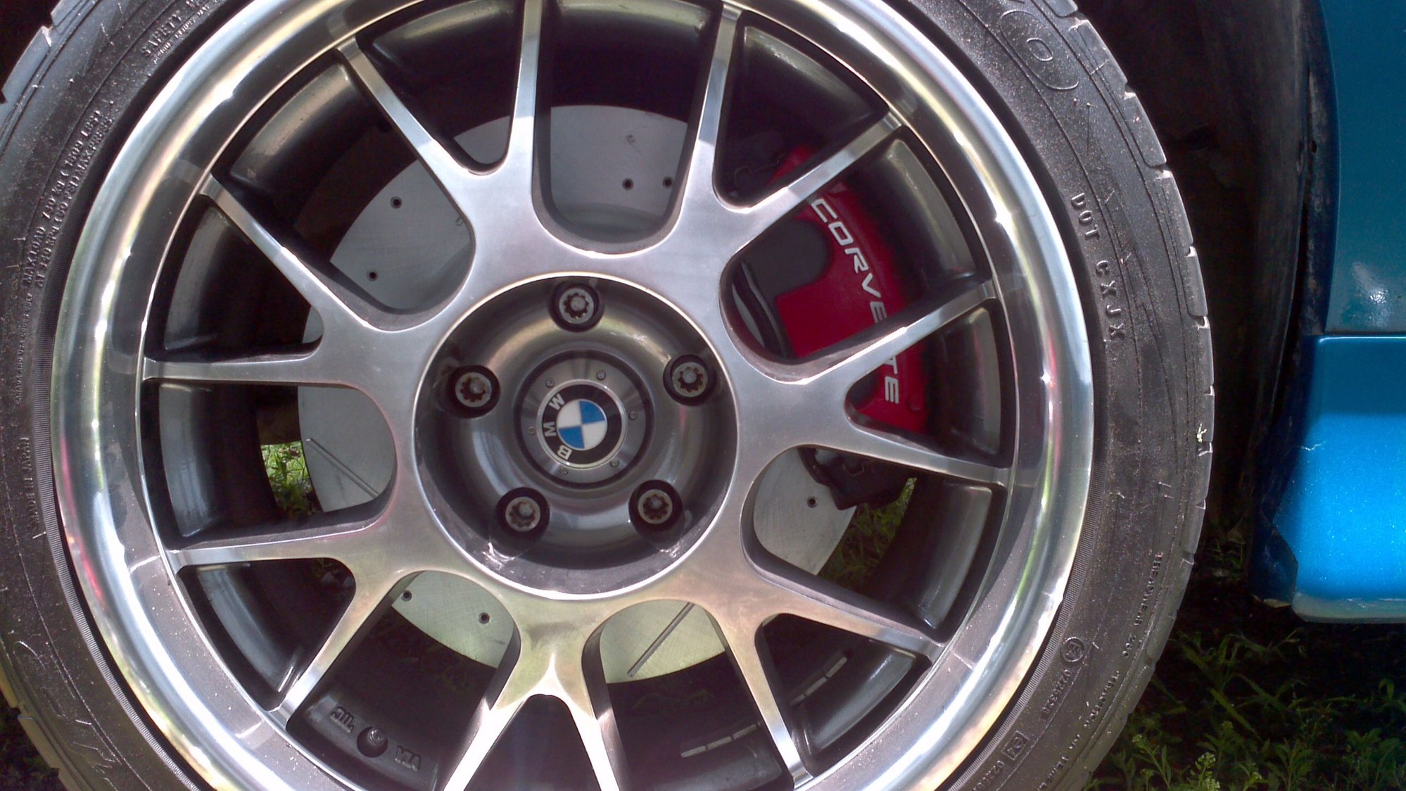

~~~~~~~BMW wheels with big brake setups~~~~~~~
Sites like bigbrakeupgrade or flynbye or any other big brake conversion will somewhat alter these instructions. a hat rotor will slide onto a hub and shim up a bit of space between the hub and the wheel. So. lets take that into account. My experience for example. I have C6 brakes and I knew I needed to shim that space and keep the wheel centered Annnnndd be able to keep a
center cap to hide that ugly grease cap on the hub. I tried a 7mm which was too thin and the cap wouldnt pop on.. a 8 looks like it would be the bare minimum with the cap barely able to be pushed in all the way but 10 or 12 may be better it depends on what brakes you currently run. thier cheap so I buy multiple sizes and play around with it.)
Also consider Thread engagement.
This is important,. dont go getting a half inch (25MM) spacer and stick it on. Theres probably not enough threads to hold the wheel on safely.
I may edit to this later on as I continually experiment
Land Rover, Range Rover and Jaguar XJ will have wheels that may also work however they usually have wayy wrong offsets
Offsets are the thing to look out for, it needs to be close to stock as possible to reduce making major modifications to wheel wells or large spacers.
~~~~~~~~~~~~~~BMW Wheel information~~~~~~~~~~~~~~~~~~
Camaro size = 0 offset and 70.3 hubsize probably gonna need 70.3 to 74.1 hubring
Note: (E38 7 series use 72.5mm hub size)
Current working setup 18x8.5 +13 front 18x9.5 +15 Rear 74.1 Hub Bore for
E39 bmw 5 series late 90s
all wheels off these BMW's will work on 4th gens
*318i
92-99
323i
98-00
325i, 328i
92-05
330i
01-05
325i, 325xi, 325ci
2006+
330i, 330xi, 330ci
2006+
Z3 2.5i, 3.0i
96-02
Z4 2.5i
03-Up
Z4 3.0i
03-Up
X3 2.5i, 3.0i
04-Up
X5 3.0i, 4.4i
00-01
X5 3.0i, 4.4i, 4.6is, 4.8is
02-Up
all wheels off these bmw's will work on thirdgens
BMW
525, 528, 530, 540
89-96
525, 528, 530, 540
97-03
525i, 530i, 545i
04-05
525i, 525xi
2006+
530i, 530xi
2006+
550i
2006+
M5
01-03
M5
2006+
645i, 650i
05-Up
740i, 750i
77-01
745i, 760i
02-Up
870Ci, 850Ci
92-97
Must use low offset wheels for thirdgens to avoid gigantic spacers.
References : https://www.thirdgen.org/forums/wheels-tires/550753-bmw-m-sport-18-a.html
Attached Thumbnails BMW wheels on a Thirdgen Camaro IROC Firebird Trans AM-2013-02-24_10-42   BMW wheels on a Thirdgen Camaro IROC Firebird Trans AM-2013-02-24_10-47

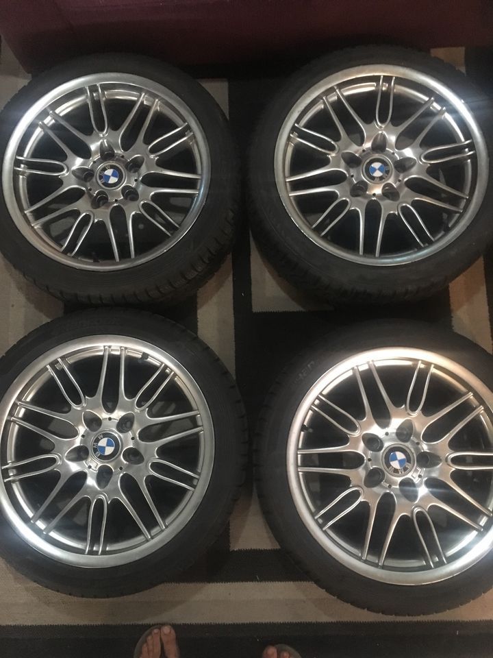

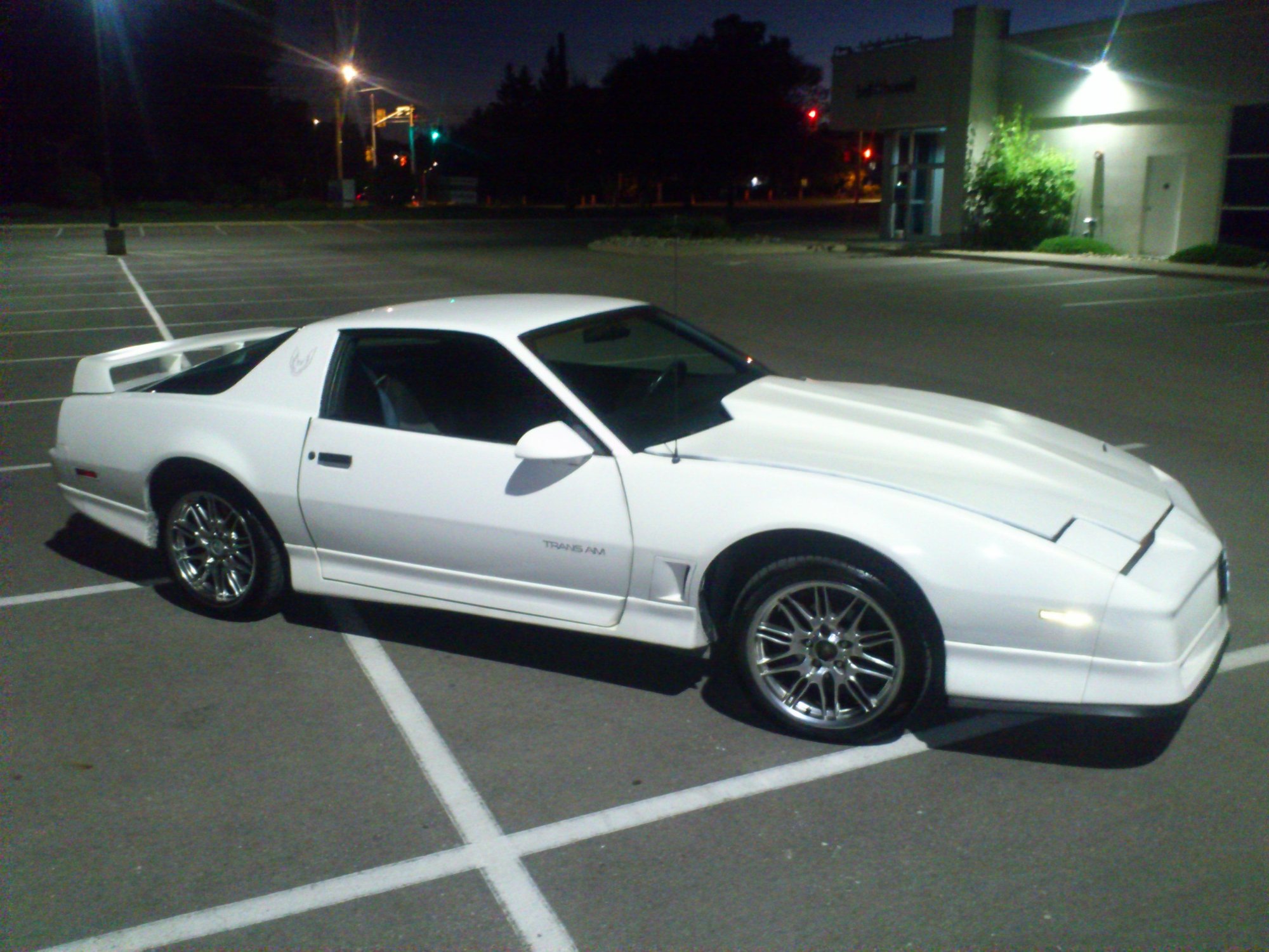

I should provide more pictures to give an idea of what BMW mesh style rims look like whether its drum or disk. on and off the car . hopefully this can give others an idea of what mesh wheels would look like and might help thier decisions.

They look pretty damn good Berlyn, nice job.
Originally Posted by Berlyn0963

Do you have a full side pic of the camaro in the last set of pics? And what did those wheels come from? I like those!
Old Mar 12, 2016 | 07:35 AM
Berlyn0963's Avatar
Posts: 257
From: Laurel MD 20707
Car: 91 Camaro RS
Engine: GM PP crate 350
Axle/Gears: 3:42 spooled 10 bolt
Re: BMW wheels on a Thirdgen Camaro IROC Firebird Trans AM
Their 5 series but 7 will also work if u buy the right hub rings for the rear and some hub centric spacers for the front. bolt pattern is the same the issue is the hub opening being bigger than the stock hubs on our cars. other than that it bolts on like anything else.

no you are not wrong and thank you,i found your advice and detail incredibly helpful and i am immensly thankful.i am looking at some bmw wheels and contemplating right now
this is the add info :5x120 bolt pattern,ET20 offset,74.1 hub bore. 235/40R18 tires BMW 525,528,540,M5,318,320,325,328,330,M3
bmw rims

i got them and put them on,went for a cruise.they feel great,look awesome and handle well.these look a lot better on my car than that other camaro.
$380 was more than the cost of the new rubber for my 16" rims and thats what i paid for these rims with NEW RUBBER.......

picked up another set from a bmw but these are bbs lm reps.
