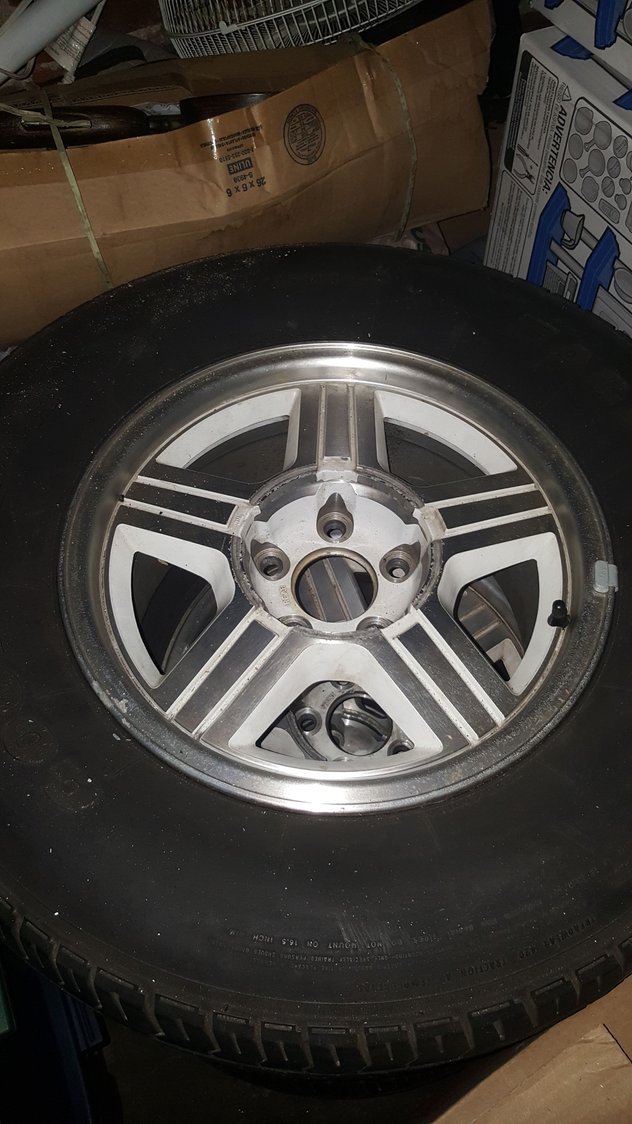

I'll admit I don't know a thing when it comes to wheels and tires. Any help with this would be greatly appreciated.
When I bought my 88 IROC, it had ugly rally wheels with Goodyear Eagle GT II tires. The previous owner gave me a set of wheels from a 92 Camaro. I am now looking to install those onto my 88, but having difficulties finding the right size tire. They have P285/60R16 tires on them now, and I can't find those ANYWHERE. I tried looking up the stock size for the 92, but then it'll telling me that they're not compatible with my 88.
I know this is probably stupid, but I am lost. I can provide any other information needed. I am attaching a picture of the wheels in case they really aren't from a 92
. Thank you in advance.

John, you want a 245/50-16 tire.
That thing looks like a truck tire! For future reference you can always go to tirerack.com and look up your year/model and you will get stock sizes.

In what size? They aren't even listed on tirerack.com in anything smaller then a 17" tire. Those are summer only tires, I would hope you don't drive your Camaro in winter in PA with those tires on.
The wheels will fit fine as long as there 2 front/2 rears or 4 fronts.
You really should but some research time in so you know what you need and buy correctly the first time.
