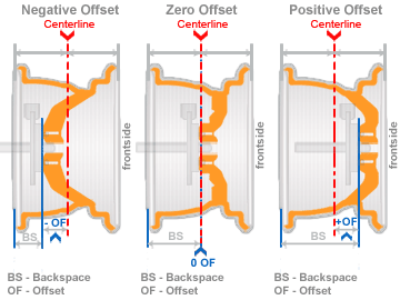

No, you cant. Spacers will not change your rim backspacing. I think you are thinking about the numbers incorrectly or backwards. Offset and backspace are the exact same thing, its just a different way to measure. Offset is the difference from the wheel mounting face as compared to the centerline of the rim. This is more difficult to measure by hand. The easier way to measure is called backspacing. So backspacing, is simply a measurement from the wheel mounting face to the inside lip of the rim. The more positive the offset or the greater the backspace is, the more the wheel center is pushed out toward the outer lip of the rim. This in turn positions the wheel deeper in the vehicle wheel well. (Front wheel drive vehicles will usually have more of a positive offset as compared to RWD vehicles).
In your case you are wanting to run a 16X8 rim. 0mm offset results in a 4.5" backspace or half of the rim with (when you measure outside lip to outside lip a 8" rim it actually measures 9". This is on the front. The rears have a higher offset, which means the rim is actually pulled further into the vehicle. This increases fender lip clearance, but decreases the inner clearance. In your case if you ran the front rims on the rear, the wheels would stick out farther then the original rear rims. If you add spacers, you would be compounding this effect making it worse. You may be able to run a 0mm offset on the rear without any issue.

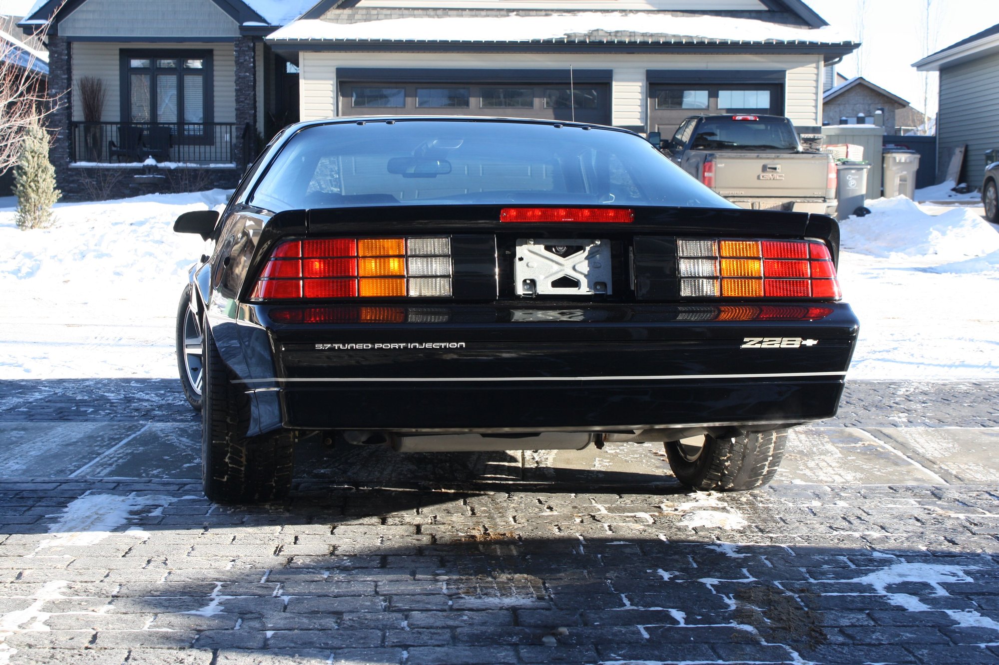

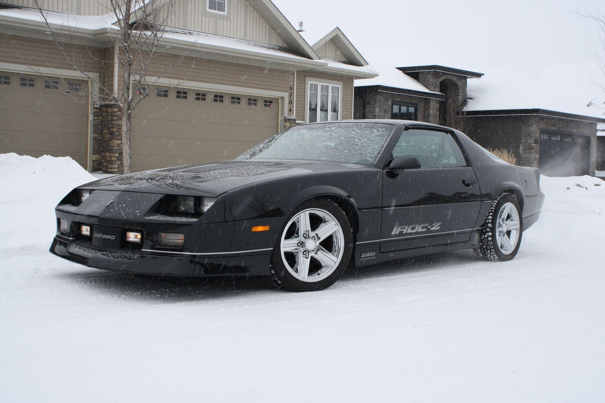

If you could get a 16X8 rim, 0mm offset, try it on the back and see how your fender lip clearance is. I have a set of 17X8 chrome wheels and I believe they are 0mm offset on all four corners. I actually havent measured them, but there are no special markings front or rear and the wheels seem to stick our a little farther then stock and I know one I checked was a 4.5" backspace. Make sure a 0mm offset will work on your vehicle before you order.
I included 2 pics, one is stock wheels, the other is the 17X8 chromes. You may be able to see the difference I am taking about but I know the pics are not the greatest. The 17X8's only moves the wheel 3/4" outward.
