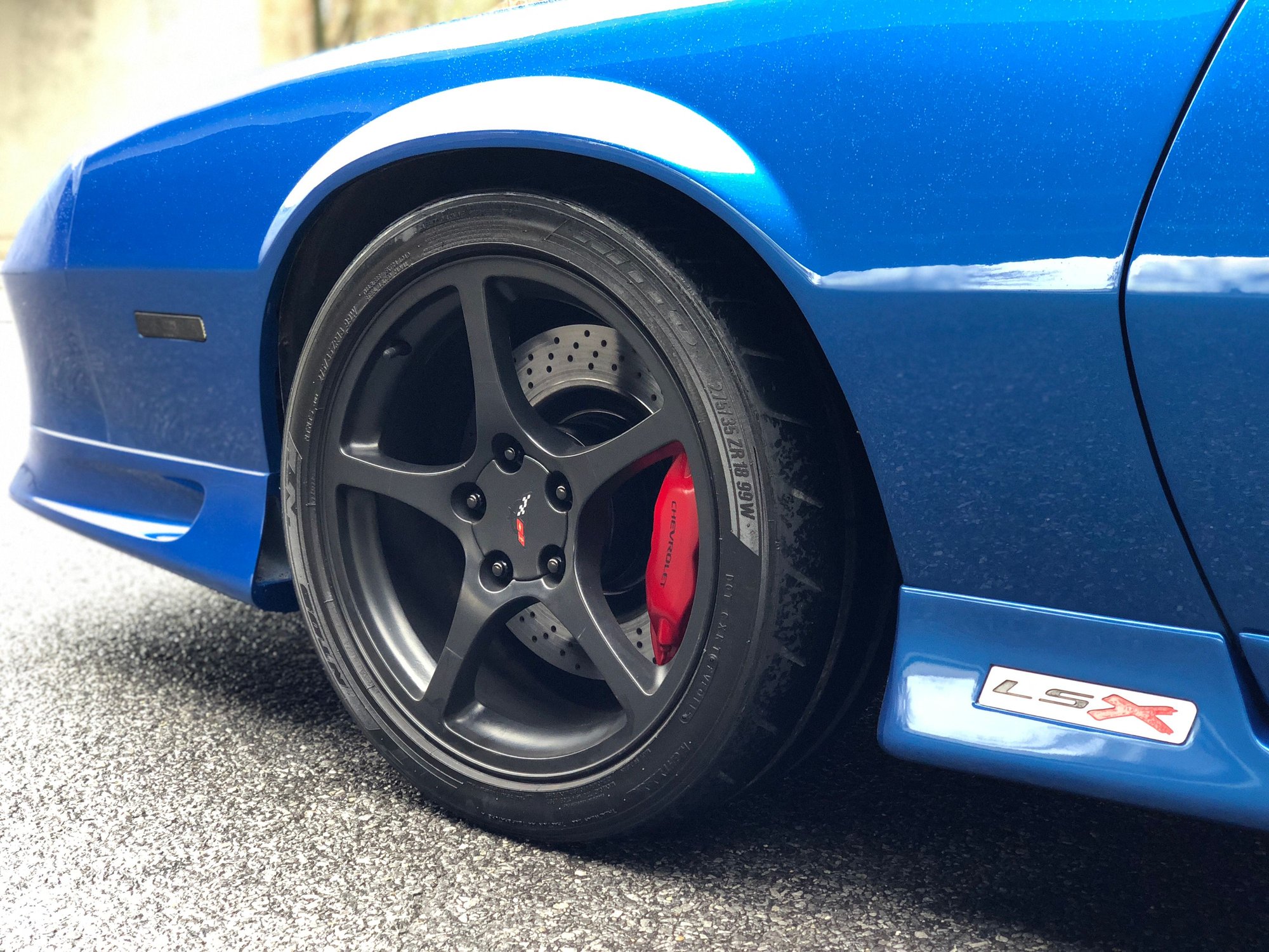

I’m running C5 rear rims all around. 275/35/18 up front and 275/40/18 on the rear. I have a 4th gen rear and 2 inch spacers up front. Been running the spacers for almost 3 years with zero issues or vibrations.
