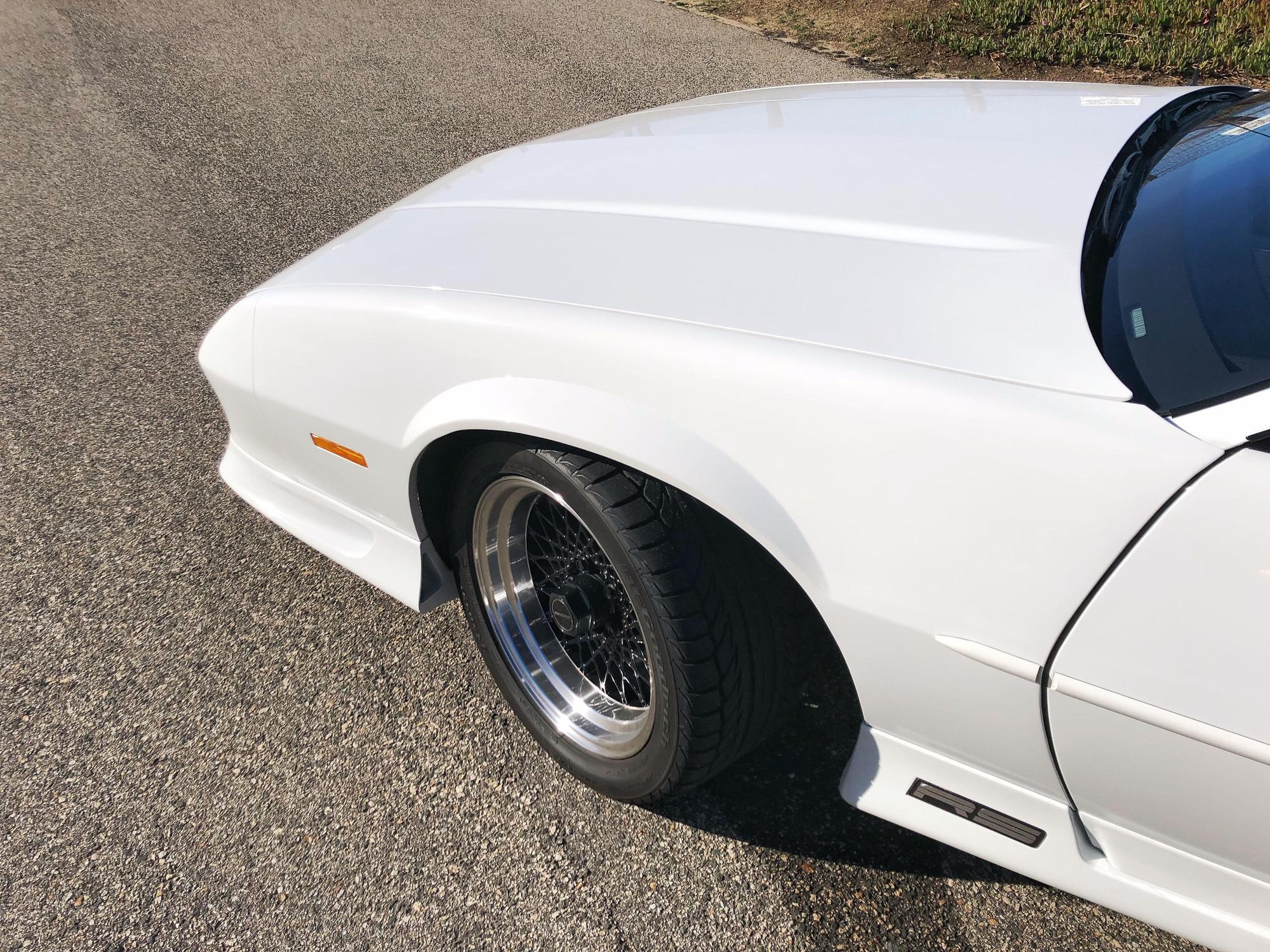

What are you trying to achieve? One of the best things about original thirdgens is their suspension and, as Drew mentioned, the coilover kit may place undue stress on part of the frame that was never designed for high loading. My guess is they're an upgrade if done right, but you'll likely require supporting modifications to "think it through" and get it all dialed in safely.
That being said, some very simple changes can yield a far better handling car. I love my current setup; the car handles great even with a bad factory spec alignment. I need to get a custom alignment done up front still. A pic is attached of the clearance. I experience no rubbing, even with some hard cornering.
Hawks 17" GTA wheels
BFG G Force Comp 2 275/40/17
Bilstein Shocks/Struts
Hotchkis lowering springs (advertise 1", looks more like 1.2" and car sits nice and level unlike Eibach sportlines that I've seen)
