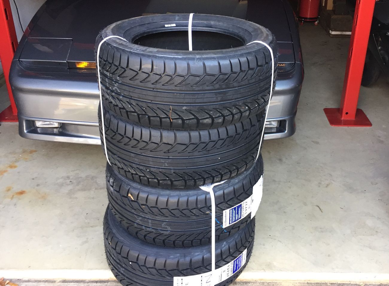

BF Goodrich makes a fine replacement in that size. I got a good deal online. Here's more:

Lots and lots and LOTS of us running that BFG tire. Not saying there aren't other options, but that's probably the most common nowadays. There aren't a ton of options left.

The BFG is easily the most popular summer tire for 3rd gens, size aside. Probably 25 street cars on our wheels running them in 275-40-17 alone.
