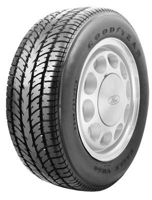

Neither size has a lot of name brand options available, a few, but many "off-brands" seem to be available in those sizes. However, there's one "brand" available in 225/60-VR15 that I doubt many people on TGO realize, even though they've been reading about it for over 5 years in another thread, and it would be a pretty cool tire for an IROC with its 15" wheels, if you don't mind the price tag:
Yup, the reproduction Gatorback from Kelsey Tire is available in 225/60-VR15. They've been available all these years we've been bugging Kelsey for 245/50-16 reproduction Gatorbacks. Kelsey reproduced these for 80s Mustangs, but it would be perfect for 15" IROC wheels. But like "Freedom," as sung in "Team America: World Police," "there's a hefty ******* fee" for these tires. But if you're keeping the wheels, then the money you would've applied toward new wheels, could be applied to these tires. See? There's always a trade-off somewhere that balances things out. The several "off-brand" tires in these sizes are priced decently, but the few name brand tires available in these sizes come with a heftier fee than you'd expect anyway. So why not these?
Although this size Gatorback was never used on an IROC, I have seen them mounted on 15" IROC wheels and they looked magnificent.
