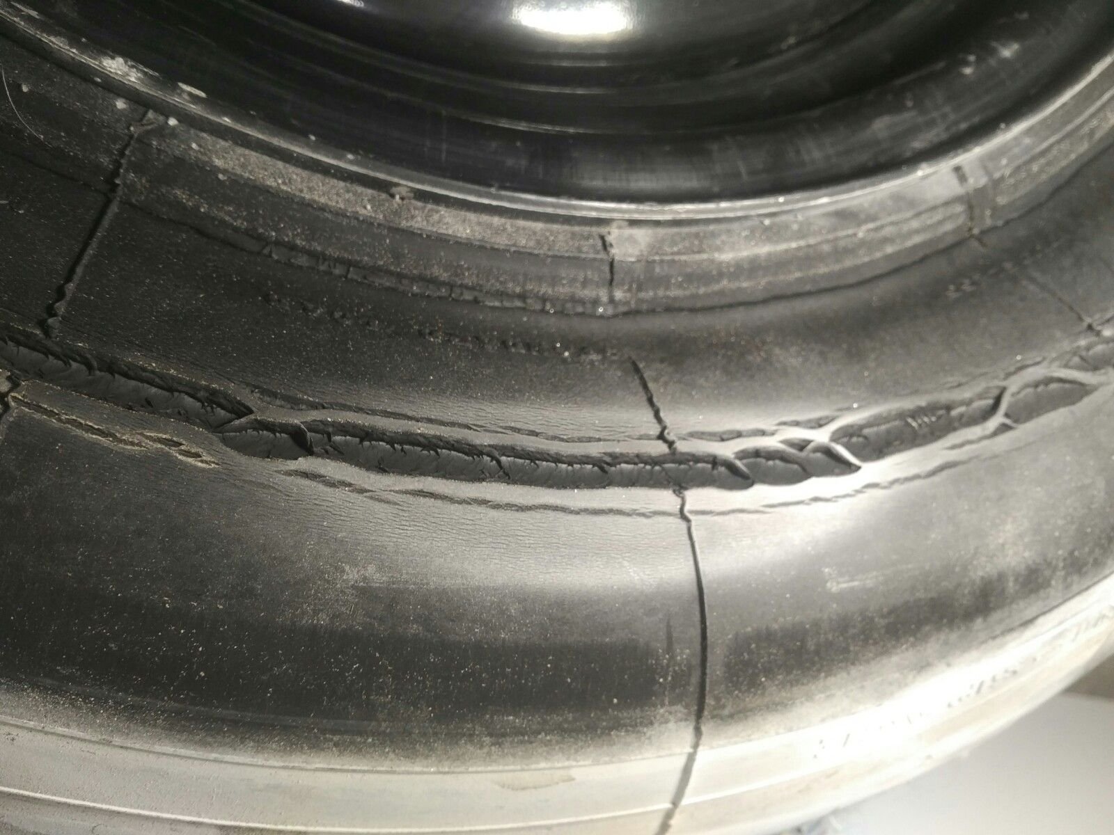

I had an aluminum spare... filled it up and tire was distorted, no good.

I had the same result when I aired up the original spare in my '85, the tire mushroomed. You might consider a Ebay 4th gen spare, they have been around for fewer years and they should be in better shape.

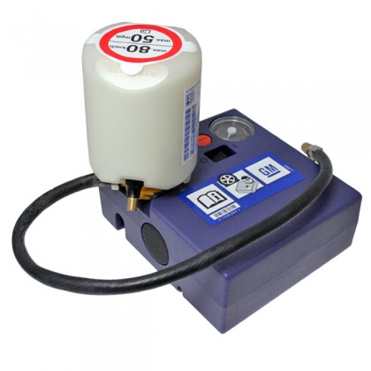

Fix-a-flat and a small air compressor powered from the cigarette lighter. If that doesn't get you home, call a flatbed. Keep your AAA membership paid up.
Many of the new performance cars don't have spare tires anymore. Just a compressor and a bottle of sealant.

I aired up my spare and it mushroomed as well. I have a 15in rally wheel from a 69 Camaro I will throw in the back if I take longer trips. Ive looked in every 4th gen around junkyards here and cant find a spare.
