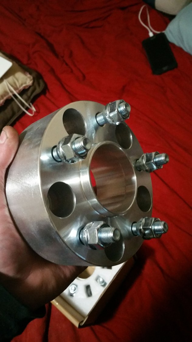

I found these as well and they are hubcentric and borecentric but it mentions they may not fit a 92 Camaro due to the hub height:
https://www.amazon.com/ECCPP-Hubcentric-compatible-Chevrolet-Corvette/dp/B01FEYVLZO/ref=mp_s_a_1_7?keywords=2”+hubcentric+5x4.75&qid=1574474560&sr=8-7 https://www.amazon.com/ECCPP-Hubcentric-compatible-Chevrolet-Corvette/dp/B01FEYVLZO/ref=mp_s_a_1_7?keywords=2”+hubcentric+5x4.75&qid=1574474560&sr=8-7
Spoiler
All of them that I have found like this state that.
Any help or guidance is much appreciated.

did you find find out if those types fit? I’m looking for front hub centric 2” and worry if they’ll clear the hubs also.
Old Sep 22, 2020 | 02:06 PM
rkdz28's Avatar
Posts: 19
Re: Proper Spacers/Adapters for C5 Wheels
Yes, those fit fine. They were a little tight but definitely fit when everything’s lugged up. Also, I had the big brake upgrade.

Did you use the supplied lug nuts that came with the spacers?
Old Sep 24, 2020 | 06:03 PM
rkdz28's Avatar
Posts: 19
Yes, I used the supplied open ended lug nuts to tighten the spacer to the axle/rotor and my wheel lug nuts to attach the wheel to the spacer.
