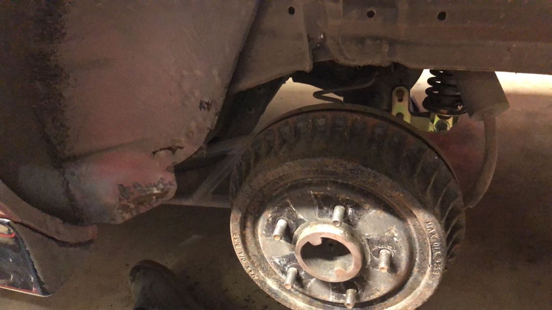

I知 wondering if someone can tell me how to fit this size wheel on my 1982 Camaro. Where do I have to hammer and does anyone have any pictures? Before and after? I値l post a picture what I have right now.

Another thing to add, they are slicks so I need room for the expansion of the tire as well.

The lower front area and possibly cut out the bump stop area, youre running only a 5.5 BS so it might not be that bad

They will sit outside the wheel well too. You need 6.5" of bs to fit them under the car, but this will require a bit of modification to the inner wheel well.
