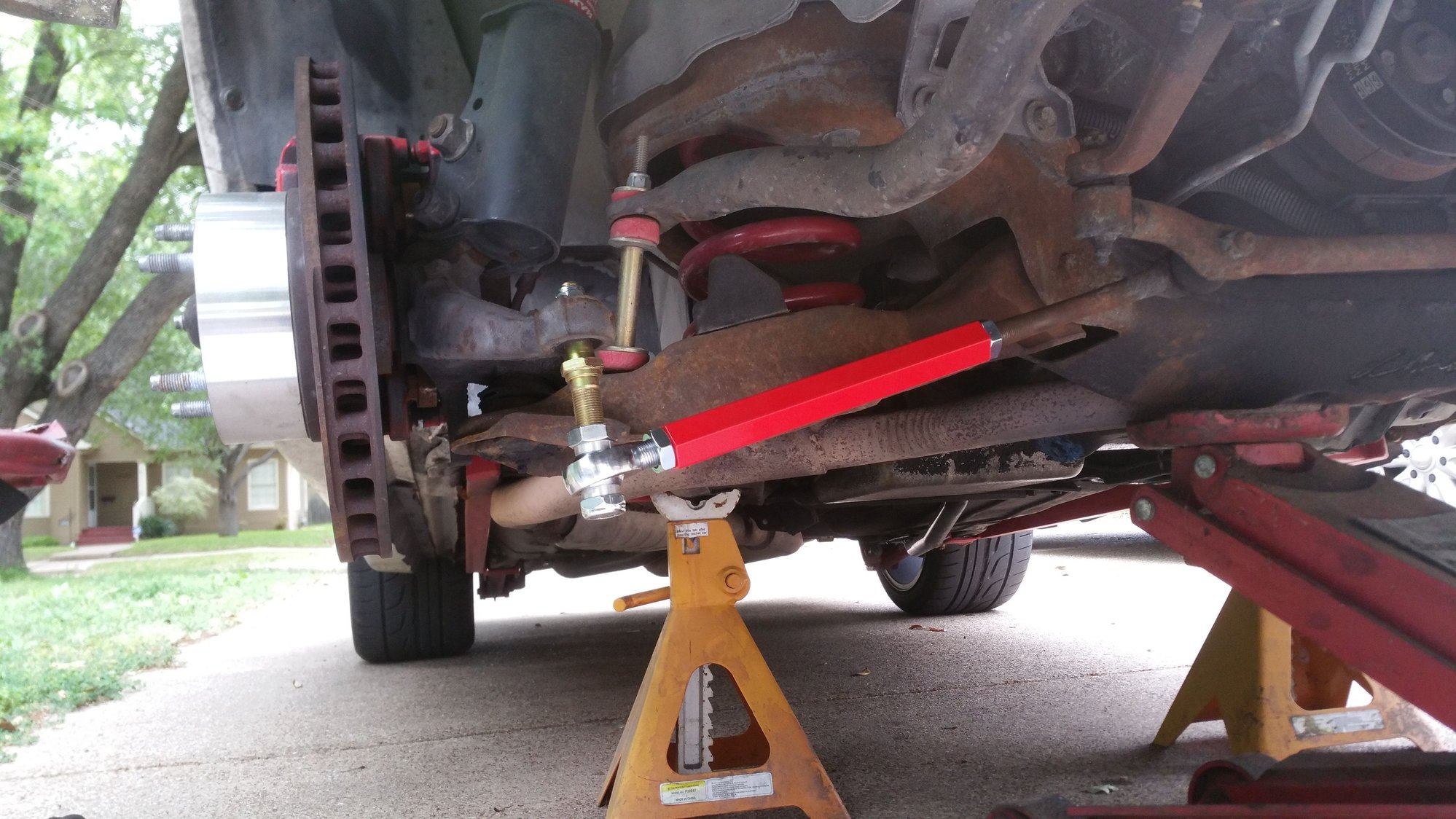

I won't be running vette wheels, but I'm fairly sure with a 17x9.5, you'll run into issues possibly with the bumpsteer kit, and almost definitely with the raised ball joint. My set up on the 88 is currently bone stock, and there isn't a whole lot of room between the wheel and the tie rod, in either the diamter OR the width of my stock 16x8 wheel. Plenty for now, but....it's only 16x8. Can't see how a 17x9.5 would work. I recently picked up some 1" raised *****, and my plan is to stick with the relatively light weight 16x8 irocs until I can afford to go 18x9.5. Not a whole lot of affordable, light weight 18" options!
FWIW....lots of guys saying bumpsteer kit isn't really needed with the raised *****, although I couldn't explain to you why. Geometry would still seem to suggest the BS kit would be helpful. Something to look into maybe.

I have a sceamin eagle bumpsteer kit on my Firebird which has 18X9.5 on the front and I dont think I could put my Camaro 17X9.5 on it with the rim hitting the lowered ball joint. I thought i had a picturre with the rim on but i cant fiond it, only this one from the install
