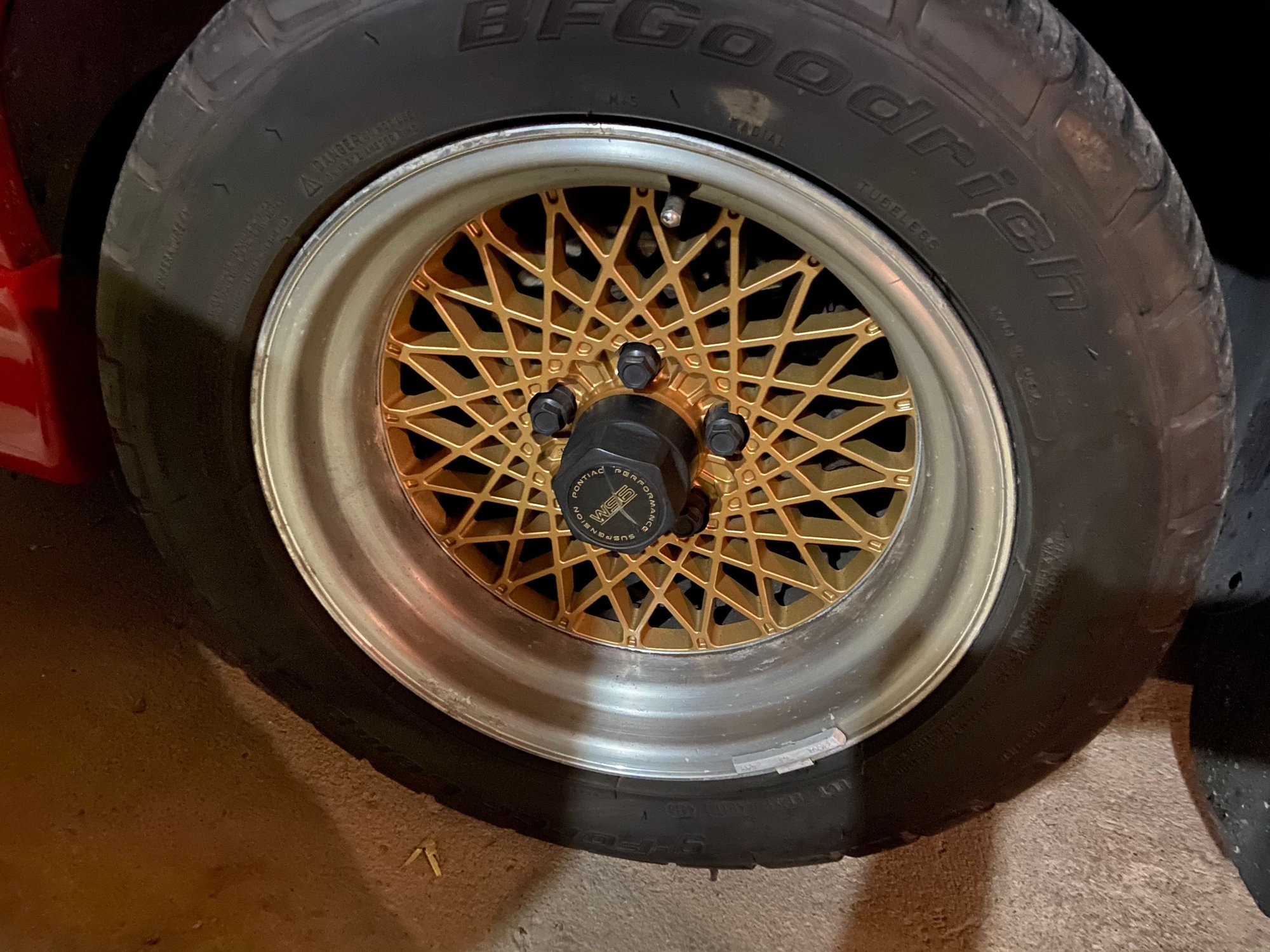

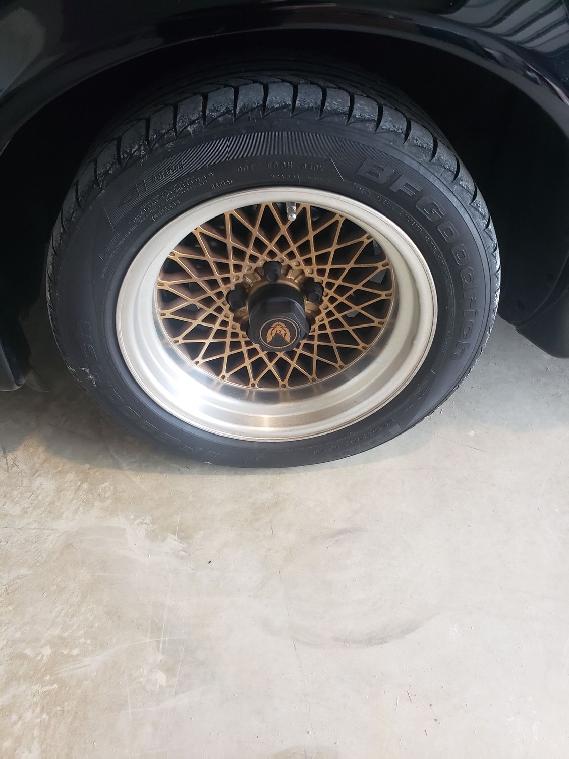

My gta wheels are looking very dull. The first two photos are my wheels the 3rs photo is the polished look I want them to look like. Is there a way to polish the ear coat? Or do I need to strip the clear off?

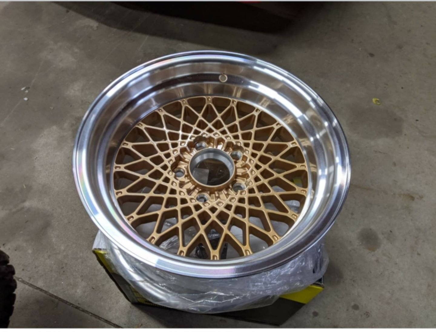

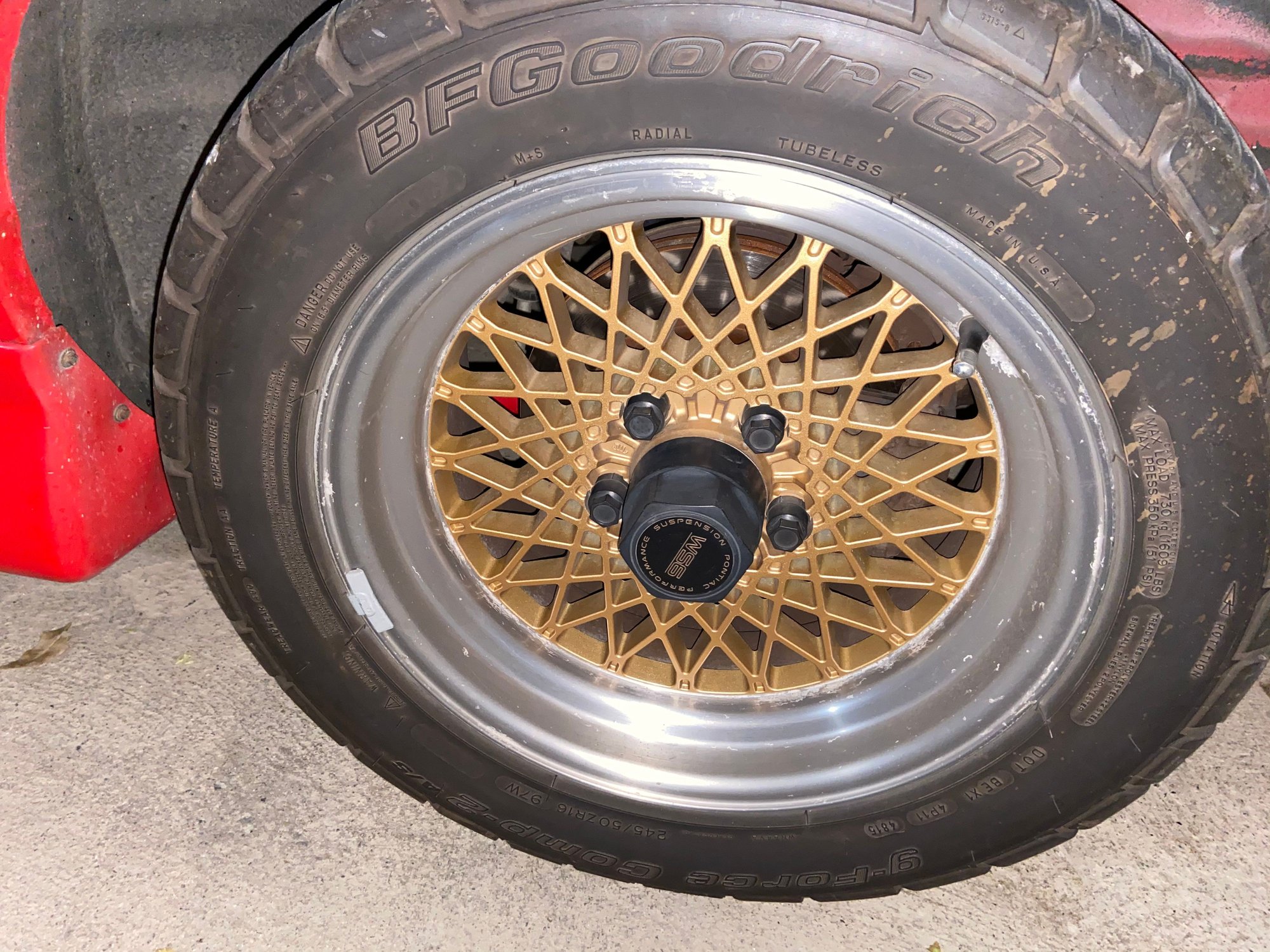

I just refinished my GTA wheels this fall, yours are in very nice shape but you want the mirror shine like I did. IIRC when I asked for advice another member recommended “1000 grit wet sand paper and polish them out with a wool pad and 3M cutting compound and finish with a polish. Tape off the gold portion of the wheels.” which I think would work nicely in your case. It looks like no one marred the rim with weights on the outside and the clear looks to not be peeling.
To achieve that look on my rims I hand sanded wet with 220 to remove the clear, then 400, 600, 800, 1000, 1500, and 2000 as recommended by bob88gta. Then the mothers mag polish with mini ball on the drill and finish up with a coat or 2 of Wolfgang aluminum wax. It took anywhere from 3.5 to 6 hours a wheel with most of the time dedicated to removing the clear coat with 220. I was hesitant to use the aluminum stripper because I did not want to worry about damaging the gold cross laces which were in good condition.
