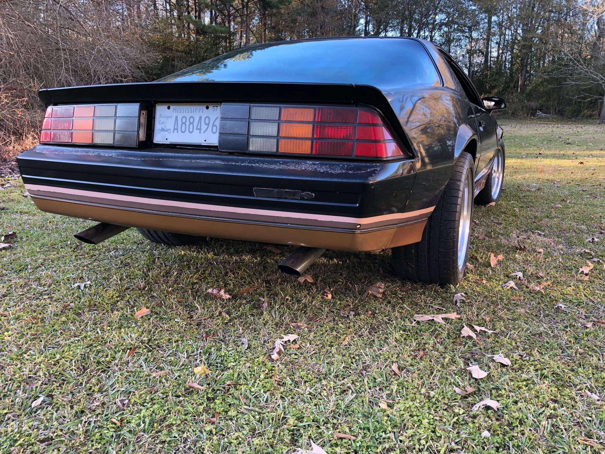

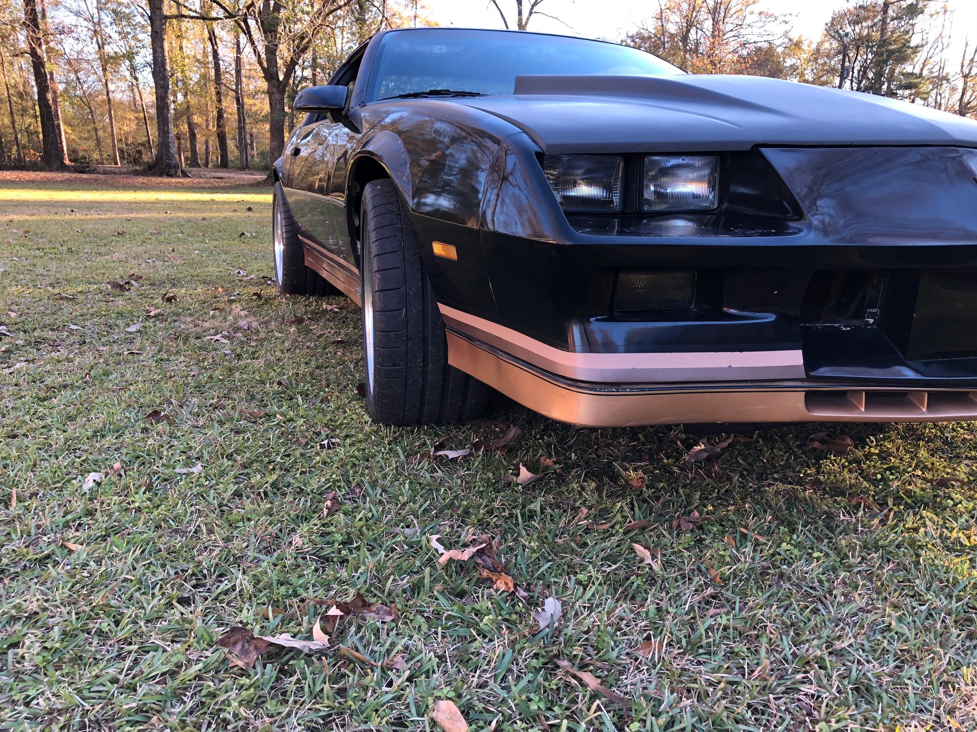

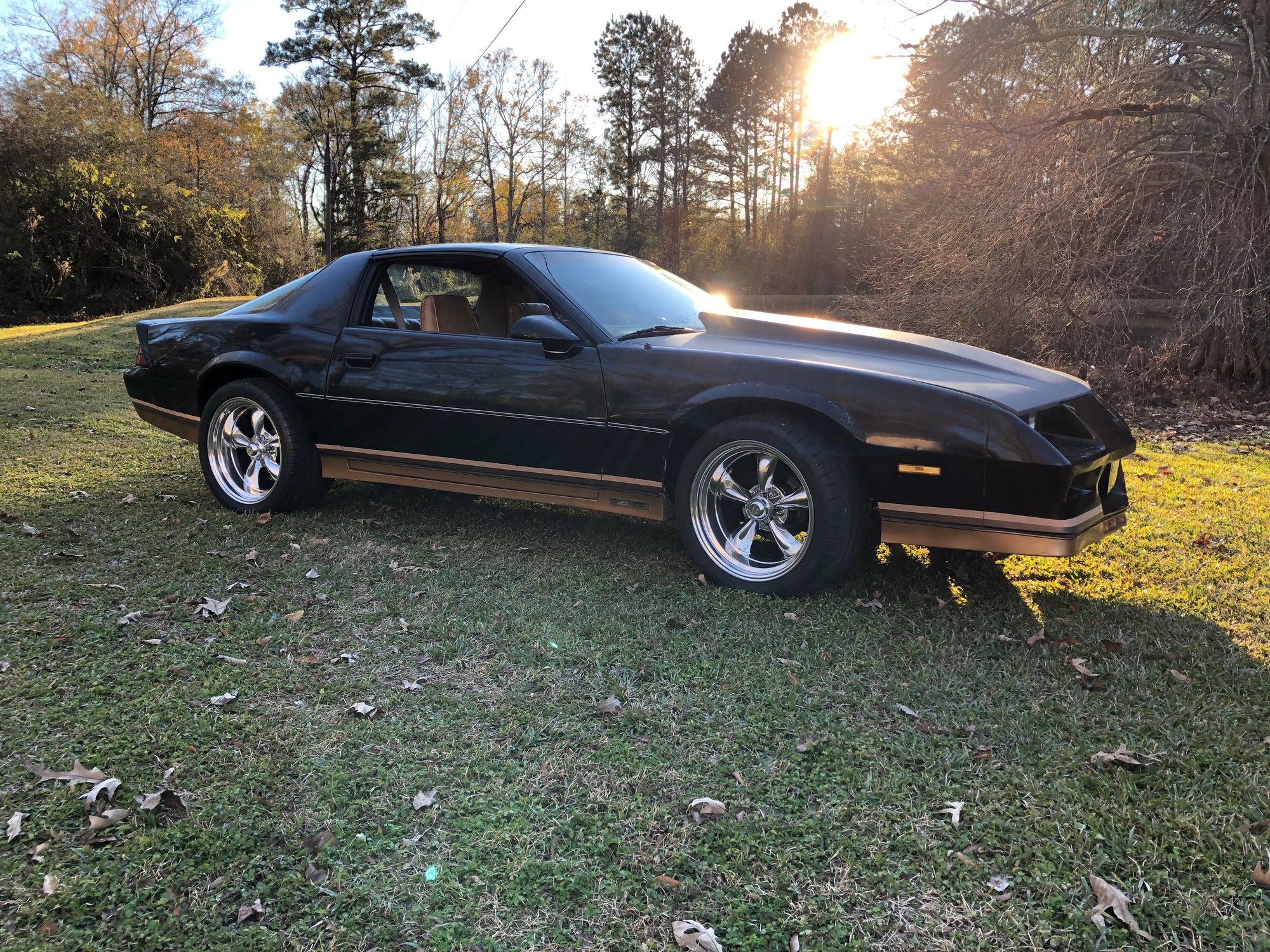

I have 18x10 +6mm. 5.74 bs. With 295/35 tires.
All stock suspension and brakes. (Drum rear).
Hammered the front inner of rear wheel well and had clearance a little in front and behind the front wheel lip/ground effects. At full lock mine will just barley touch the inner wheel well behind the front tires.
