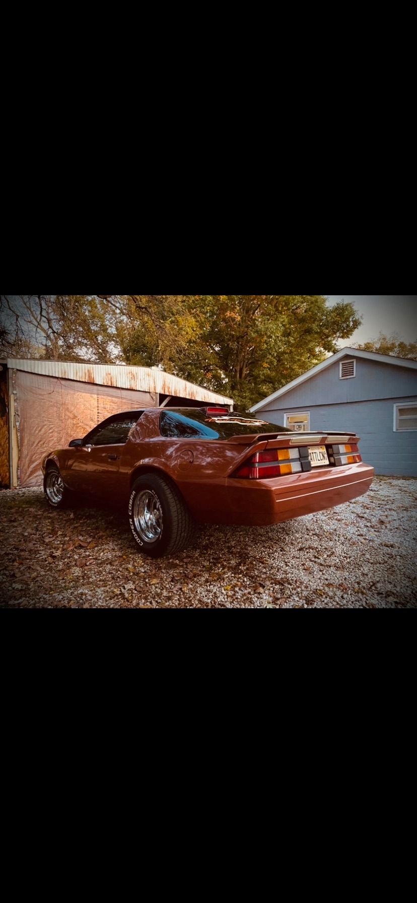

Hey y’all question here currently i have a set of cragar ss’s front and rear on the car. I love the style and look of these wheels as i have since i was a kid. The question i have is right now on the rear i have cragar deep dish wheels that are 15x10 that stick out about an inch to two inches past the fender. I’m wanting to see if anyone has any knowledge on these wheels themselves to see if they make a different size wheel in terms of the backspacing and such to fit the beefy 295 50 15s I currently have on here now so they sit as flush to the fender as they can. If not, I will just keep these as they are, as these are the wheels that will remain on my car. Appreciate the info in advance!

You'll need a 6.5 BS with a 15x10 or something like a 5-5.5 with a 15x8 in order for it not to look like Joe Dirt
