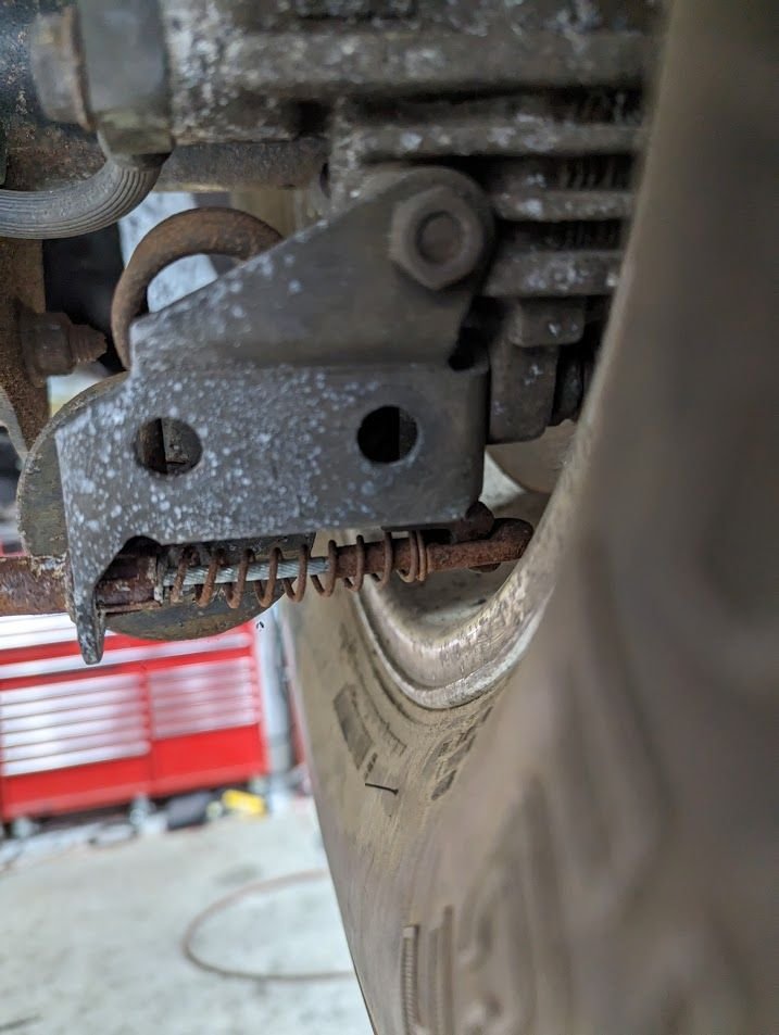

So doing some reading, it appears PBR/LT1 brakes have clearance issues with most non factory 15" rims. I've heard the draglites and other weld wheels do not fit and hit the caliper or parking brake assembly.
For illustration, this is how close it is to a factory 15" wheel:
Any of you guys running the Vision 521 or summit / jegs 521 prostar knockoffs with PBR/LT1 brakes ?
